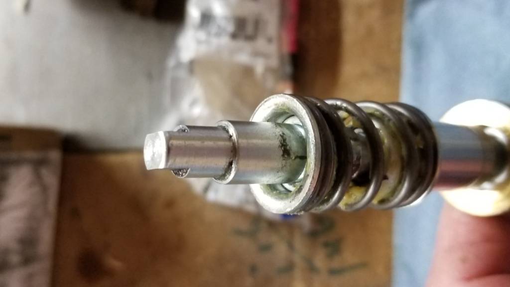

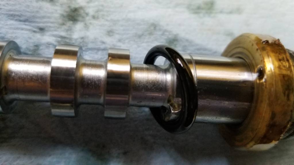

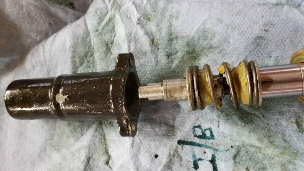

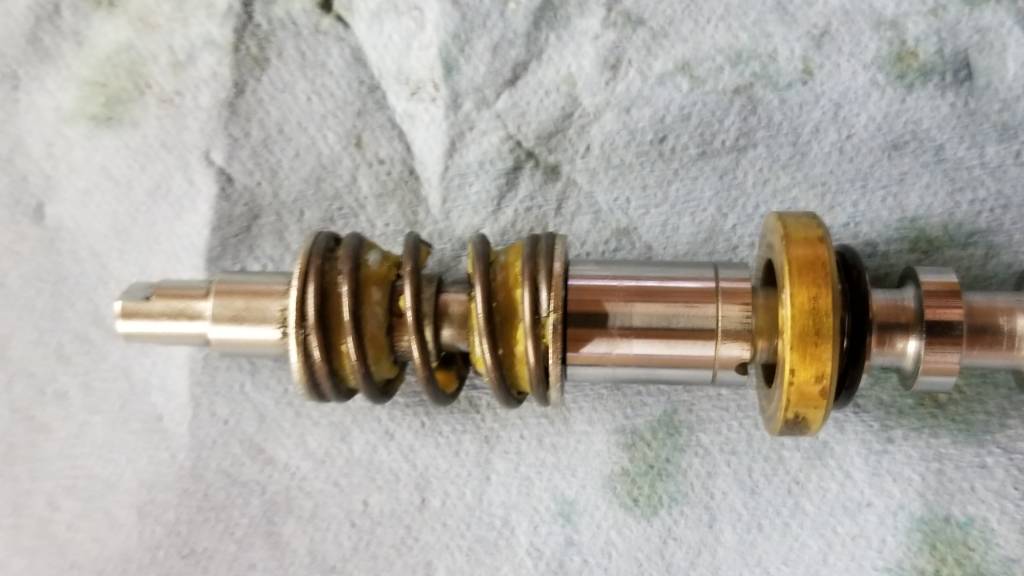

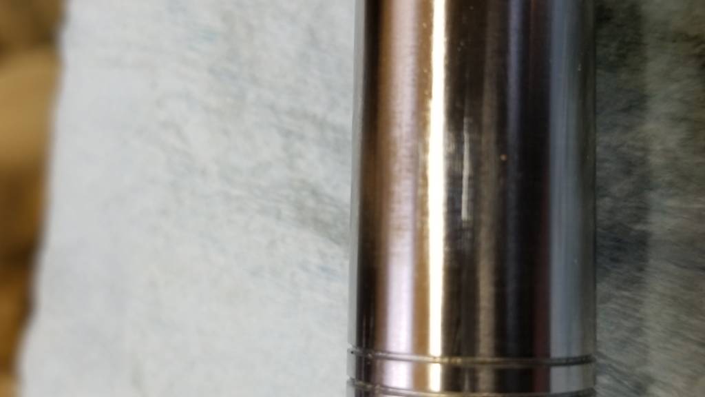

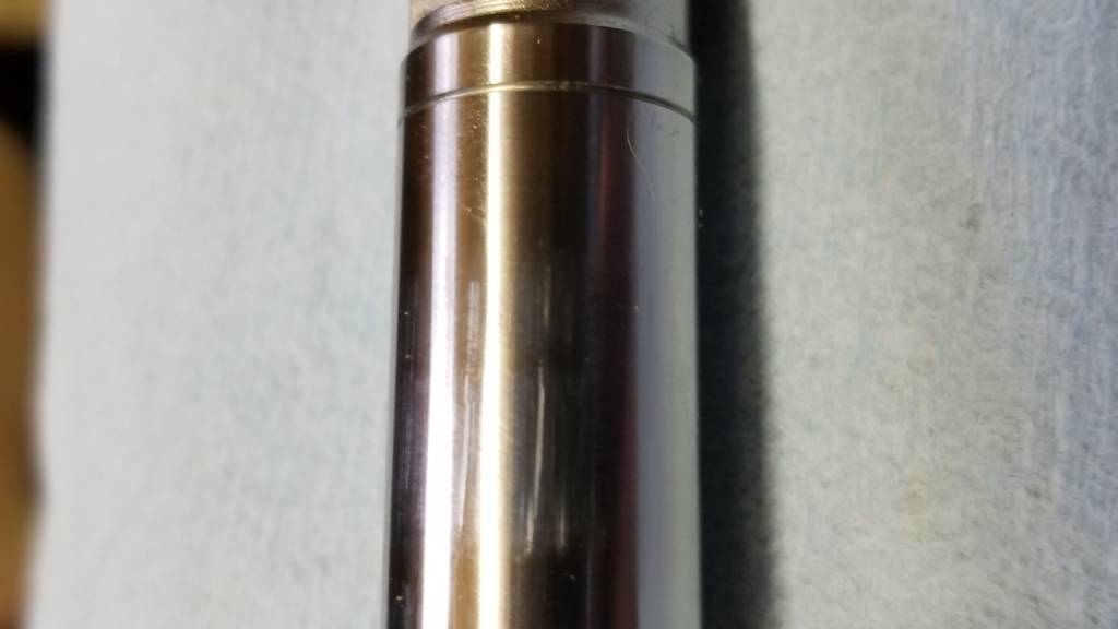

Looks like I found the problem. Took both spool valve's out this morning. Both show wear but the dump/curl valve was dirty and showed more wear. Will replace both valves since I have it apart. 20180407_115520.jpg20180407_115026.jpg20180407_114227.jpg20180407_114257.jpg
   / FEL bucket not staying up #66
Maybe JJ or someone with more hydraulic experience can comment on your photos. But it is not obvious to me that that visible surface wear would cause your problem. Also, did the problem start suddenly? If so, that's not typical of a wear issue.
Presumably, the valve body and spools are interchangeable (not matched sets) if you can order just the spools.
It would be nice if you could confirm that the curl positioner (centering springs) is correctly positioning the spool before you button everything up again.
Good luck. This has been an interesting saga.

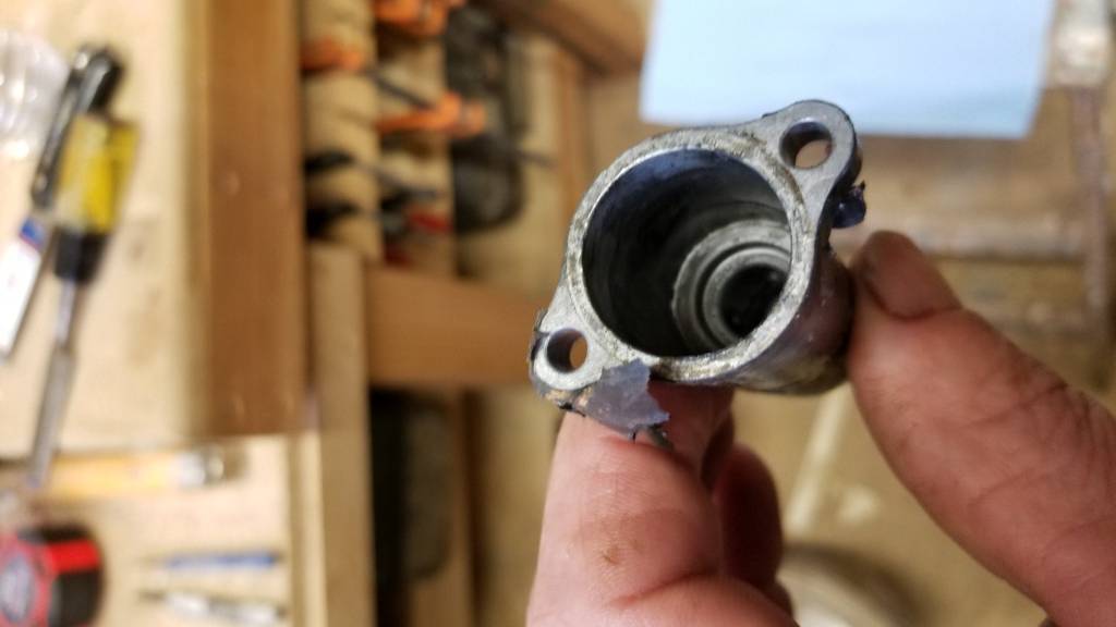

This is the curl/dump spool valve. When you move the joystick the spring positions the valve to either curl or dump ? So maybe the spring positioner is bad and not moving the spool. Now this makes the most sense. Guess I could clean it up and reinstall to see if it works. I am thinking the positioner is bad.

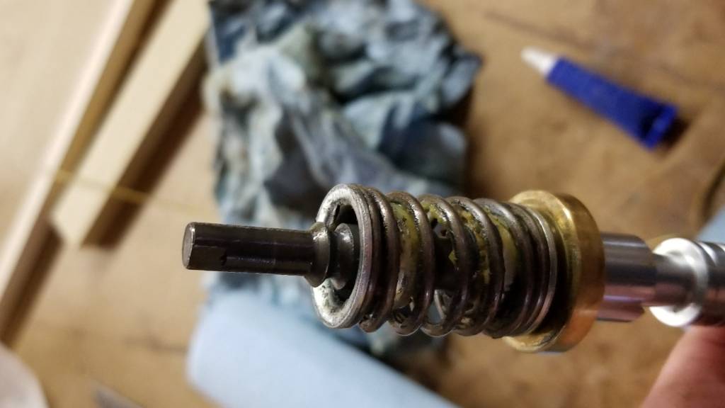

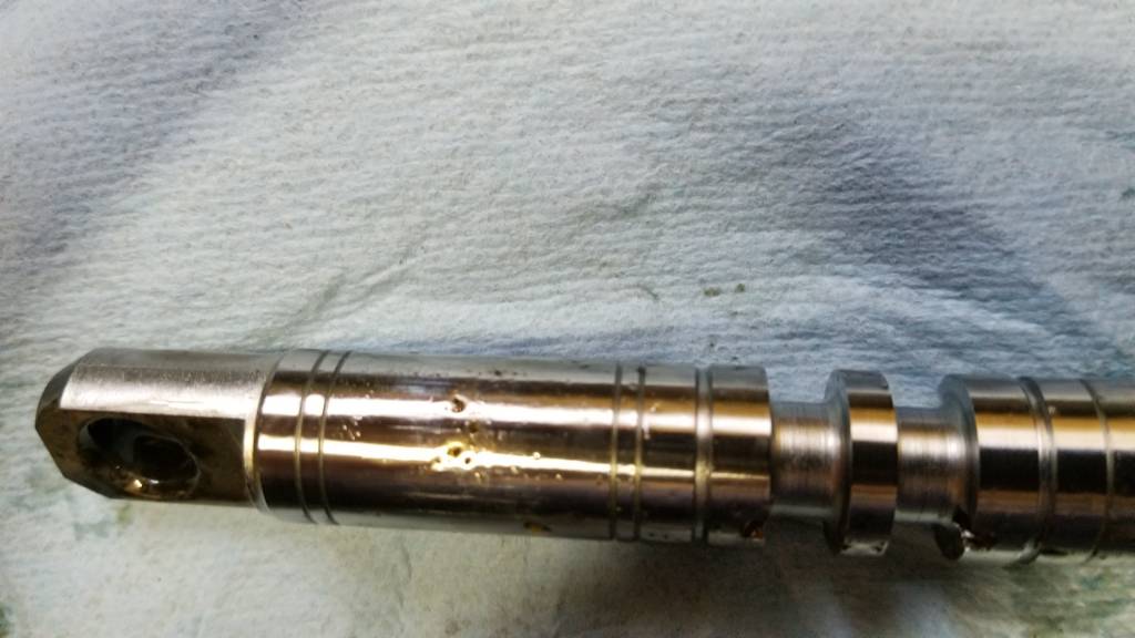

20180407_145055.jpg20180407_145532_001.jpg This is the boom up/down spool. Couldn't figure out why it had a different end from the curl spool. As the positioner cap has 3 ball bearings in the bottom of it like air chuck coupler. Walla... that's for when you put the loader in the 'float' position those bearings lock into the spool valve thats on the end. Always wondered it took a little extra tug on the joystick to lock it in !!

The Saga has ended !!! After getting the spool valves out ( which helped me understand how it worked ) I completely cleaned them...re-tightened the positioners and put new grease in them . Connected the cables, which I noticed were loose so tightened them up to take some slack out. With the loose positioner, loose cable and lack of spring grease I think that was the root cause of not allowing the positioner to return to center. Started the tractor and everything worked normally, even the bucket now doesn't have any drift in it.
