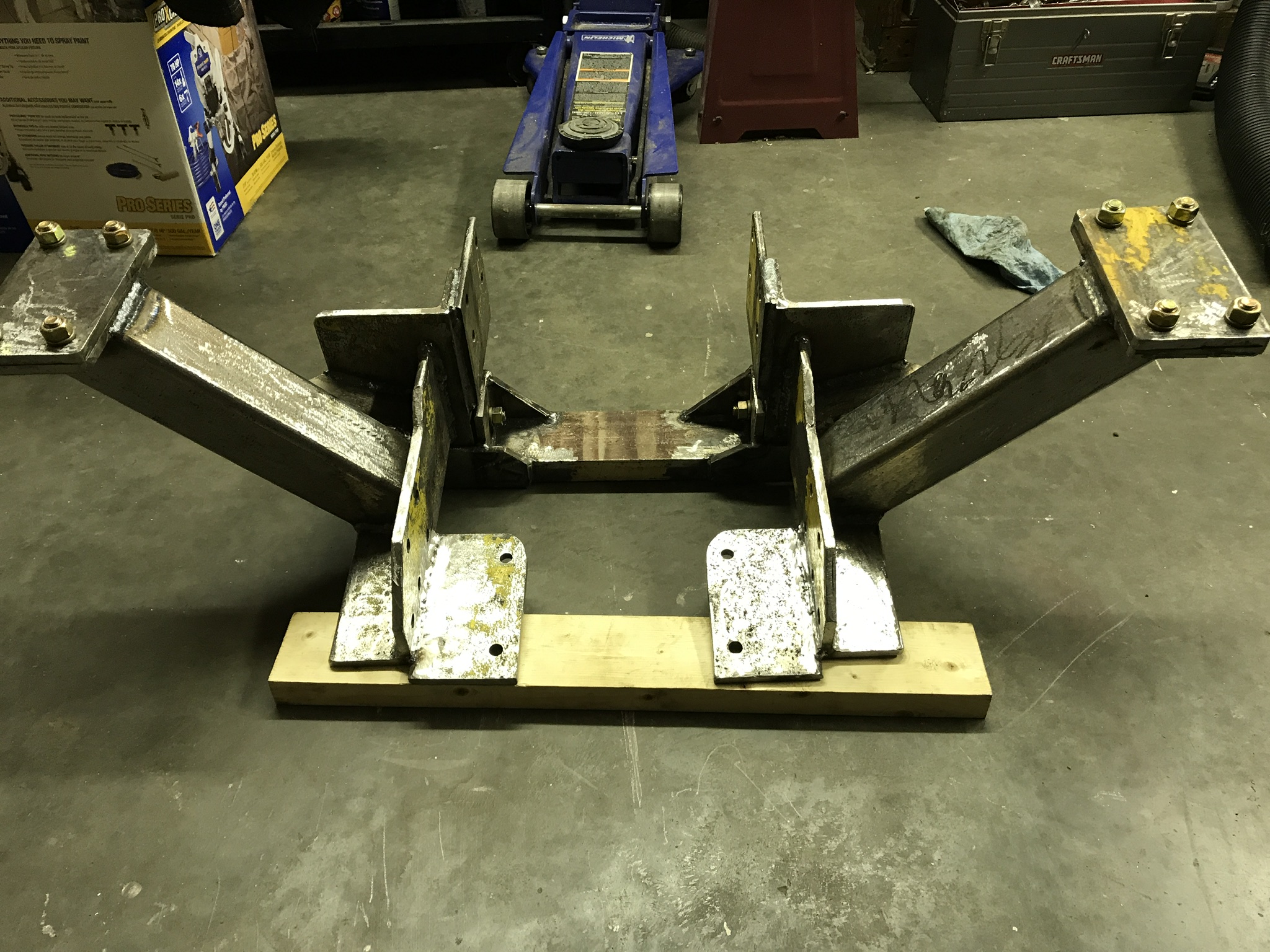

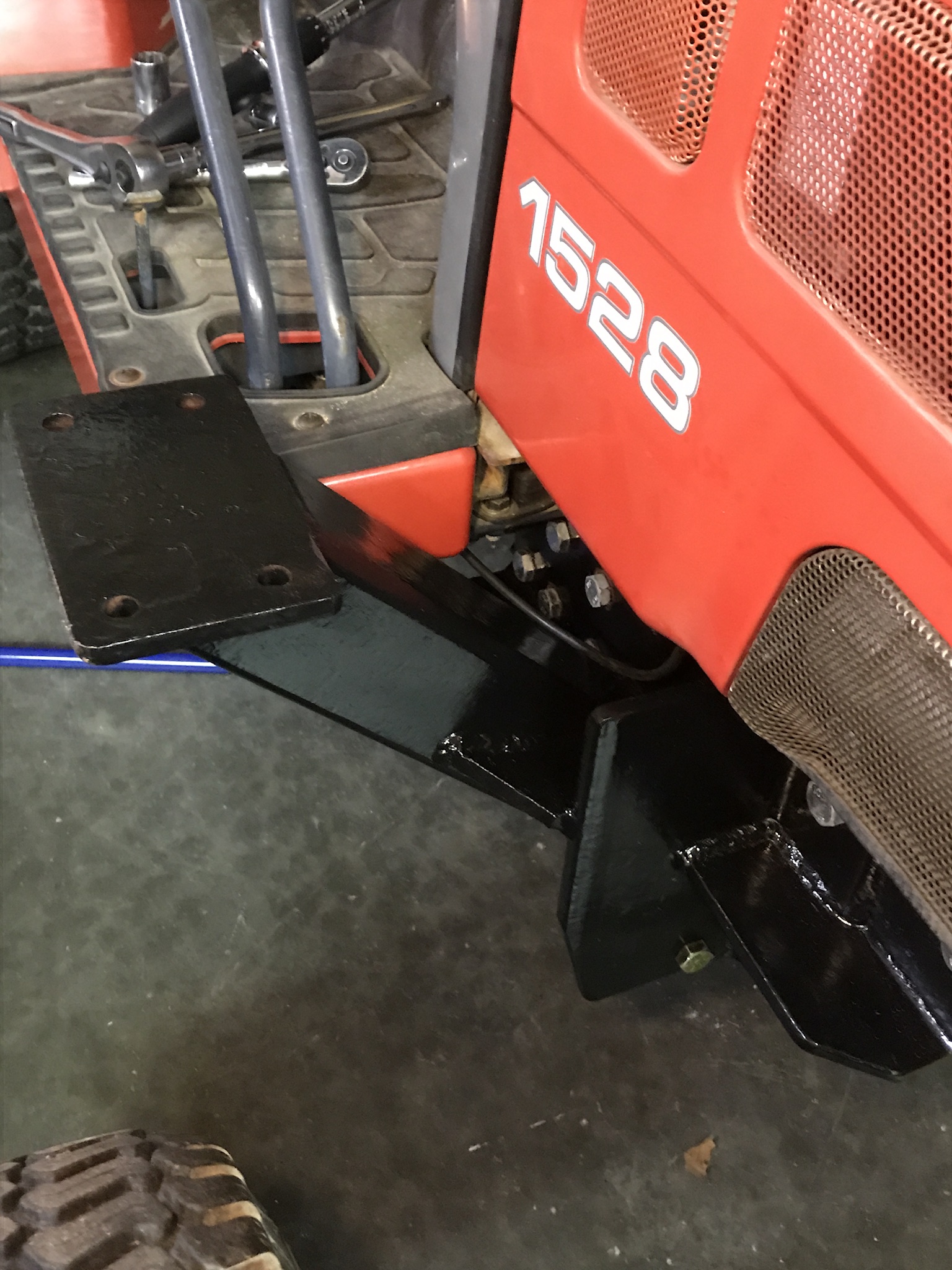

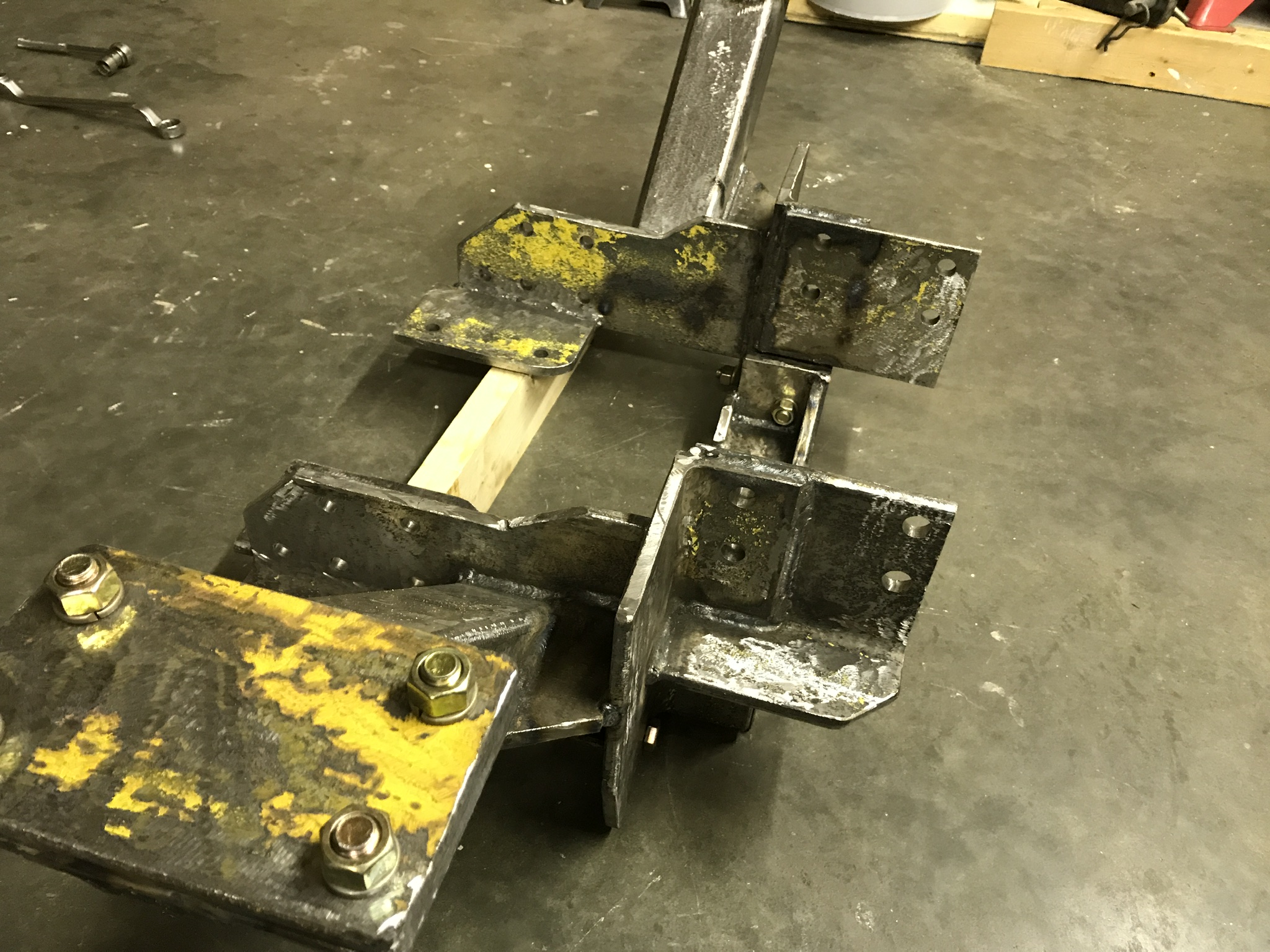

#44
548A12CE-70B4-4724-BEAC-BACF7A422929.jpeg3AFFA2CD-FD01-4622-9545-72B2CCCA85BA.jpeg6106EF56-6A6E-4D7F-8DC1-500B2D501579.jpeg
Attempting to upload pictures of my FEL mounts? Hope the files are not too large.

Dabwood40, can't tell from the pictures, but you need to for sure have "axle bars". One on each side of your underbelly mount going to the rear axle. Might be 2x2x 1/4 square tubing for your size tractor. They put the weight on the real axle and take stress off of the middle of the tractor.
If you're interested in what may happen if you don't build it correctly, aahere is a picture of a Massey 1010 with a busted transmission housing!

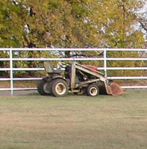

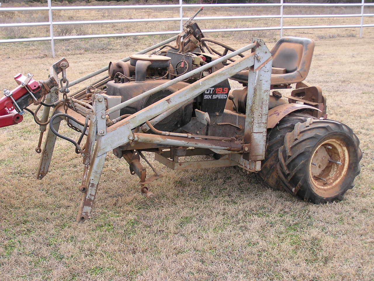

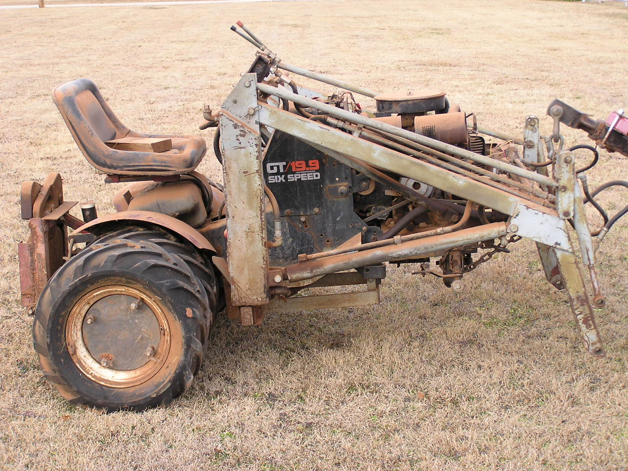

Have you considered building it with self leveling linkage?
Here is a Kwik-Way brand loader on a garden tractor that I used to own. You can see the self leveling linkage:
And after I set it out for sale with the hood, bucket and front wheels back on it:

We have designed and built well over 100 sets of loader mounts over the last 15 years and your advice is good. I'm not so sure it is the transfer of weight to the rear axle that takes the stress off the middle of the tractor I think it is more of the torsional stress. Whatever the dynamics are, I agree that a couple pieces of tube mounted low going back to the rear axle area and a couple pieces of tube or reinforced flat stock (made like a "T") mounted high and going forward to the bumper area eliminates the mount trying to rotate.
