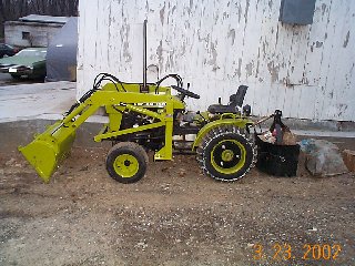

Built a CadPlans Loader for my small Yanmar. It was an excellent experience, took a couple of months. I bought the Hydraulic kit and acquired the steel locally. If you are not in a hurry, I highly recommend building one. The Plans, in my opinion, are worth it, as is the hydraulic kit. I was able to get the steel VERY cheap from the scap bin at work, making the project extra cost effective.
I agree with the previous posters, it is a lot of work and requires some talent and attention to detail, but the pride of saying "I built it" makes it worth it! Photo attached.
