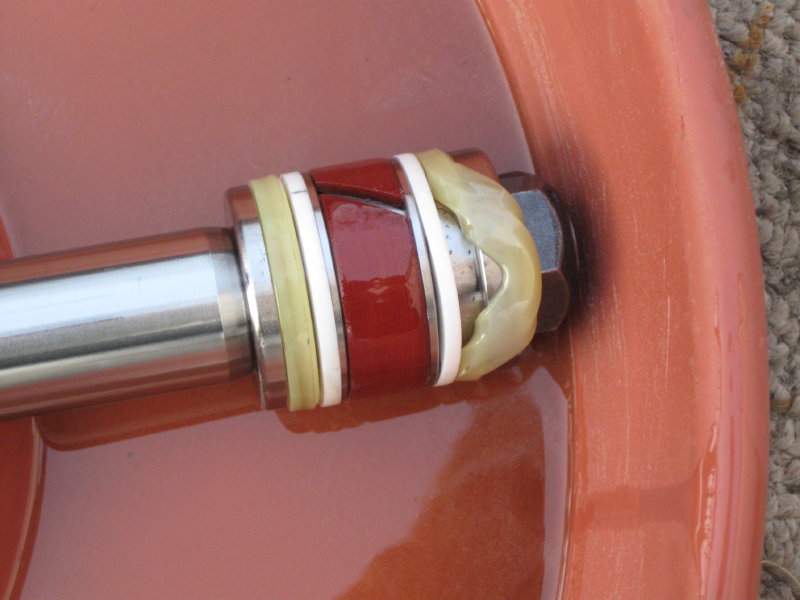

I heated the seals in a pan of hydraulic fluid to 160 degrees. The seals were soft and pliable and slipped into position. My question is are they seated properly? The one edge of the seal is tilted. Is this normal or do I need to jockey the seal around so the edge is more flush. See the attached pictures.....
That looks bad. It will not work. 160 degrees was not too hot at all. It looks like the inner lip isn't in far enough. Maybe take a pick or a very small screwdriver and see if you can roll the inner lip? The seals should look installed almost the exact same as they do not installed. Do you have spares? On that piston, they really don't need to be heated. You could snap them on with your palm. They are pointed the proper direction. Are you sure they are the correct size?

That looks bad. Andy

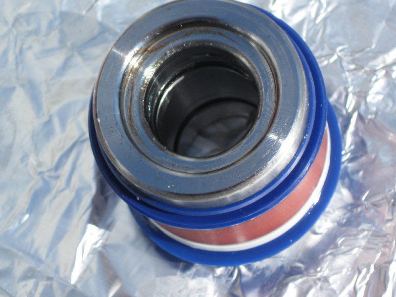

Thanks!!!! for checking in......... I jockeyed the seals around and got the bottom of the 'U' to seat up against the white teflon washer. See the attached picture. I used a rounded edge tool so hopefully I did not nick the seals. I did not order any extra seals but I will know to play it safe next time and order a couple extra.
Don

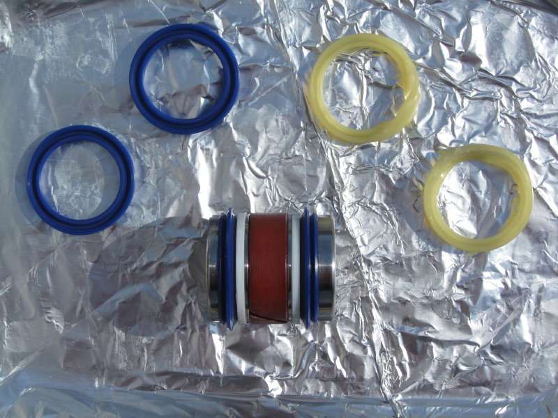

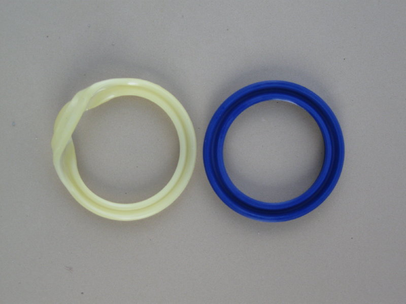

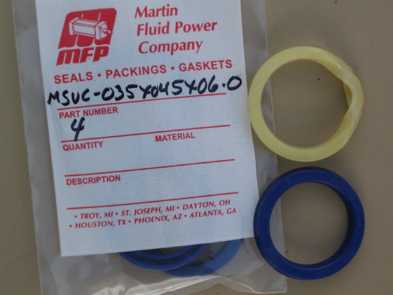

The first pictures I posted in this thread showed both rods. Three out of four seals were splooged out of place and one seal looked OK. There's a perfectly good explanation why the one seal looked good. Unfortunately, I don't have a cut and dry reason why the other three splooged out. The first two pictures are duplicates of the ones I first posted. The third picture shows a close up of the seal that did not splooge out. It looks to me like it was mounted backwards.
Don

OK, here's all 4 seals mounted. One trick I learned is to slide the white telfon washer (it's has a slit in it) up and out of the way before mounting the seals. With the telfon washer out of the way it created enough clearance for the seals to slip right into place the proper way, then slide the teflon washer back in place. The ram that's mounted on the rod are the original seals that I had to jockey around to re-seat them properly.
Don

Yeah, that one seal is backwards. But, there are applications where that would be an advantage. I have seen plenty of cylinders that power one way and the other way has very little load so all the seals point one way.

The seals look much better now. You should be okay. Some oil on the seals and a little patience during assembly and you should have a pair of good cylinders there. Take your time assembling these. Wiggle the rod around to get the seals past the threads of the cylinder housing. If you try to force it, you will tear up the new seals. Be gentle, but don't be afraid to push a little. It takes a feel for it, but you will get it.
I notice no new wear band? Not the end of the world, but next time replace it. Another thing I like to do when assembling is to stagger all the seams, like doing rings on a piston for an engine. Look at your picture and you will see what I mean. You could leave it like it is and probably never notice a difference but I get silly like that sometimes. Just a habit I guess.
Good luck, Andy

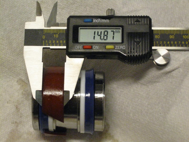

Andy,
Need some assistance with the wear bands.
Measurements are:
Cylinder bore (ID): 45mm
Piston (OD): 42.65mm
Groove 'wear band' seats in: 39.95mm
Height: 14.87mm
1. What material is this wearband made of?
2. Can you point them out on the www.mfpseals.com website?
3. Rule of thumb 'torque spec' for nut that holds piston in place?
Thanks,
Don

MWRP 45x15x2.5
45mm is the od, 15mm is the height, and 2.5mm is the thickness. Your piston is 39.95mm or 40mm for arguments sake. 45-40=5mm, divided by 2 because you are measuring both sides of the wear band gives you a thickness of 2.5mm.
As far as a torque spec goes, I figure the thread od and look at a torque chart. They can be found in any good catalog. With torque, more isn't always better.
Good luck, Andy
