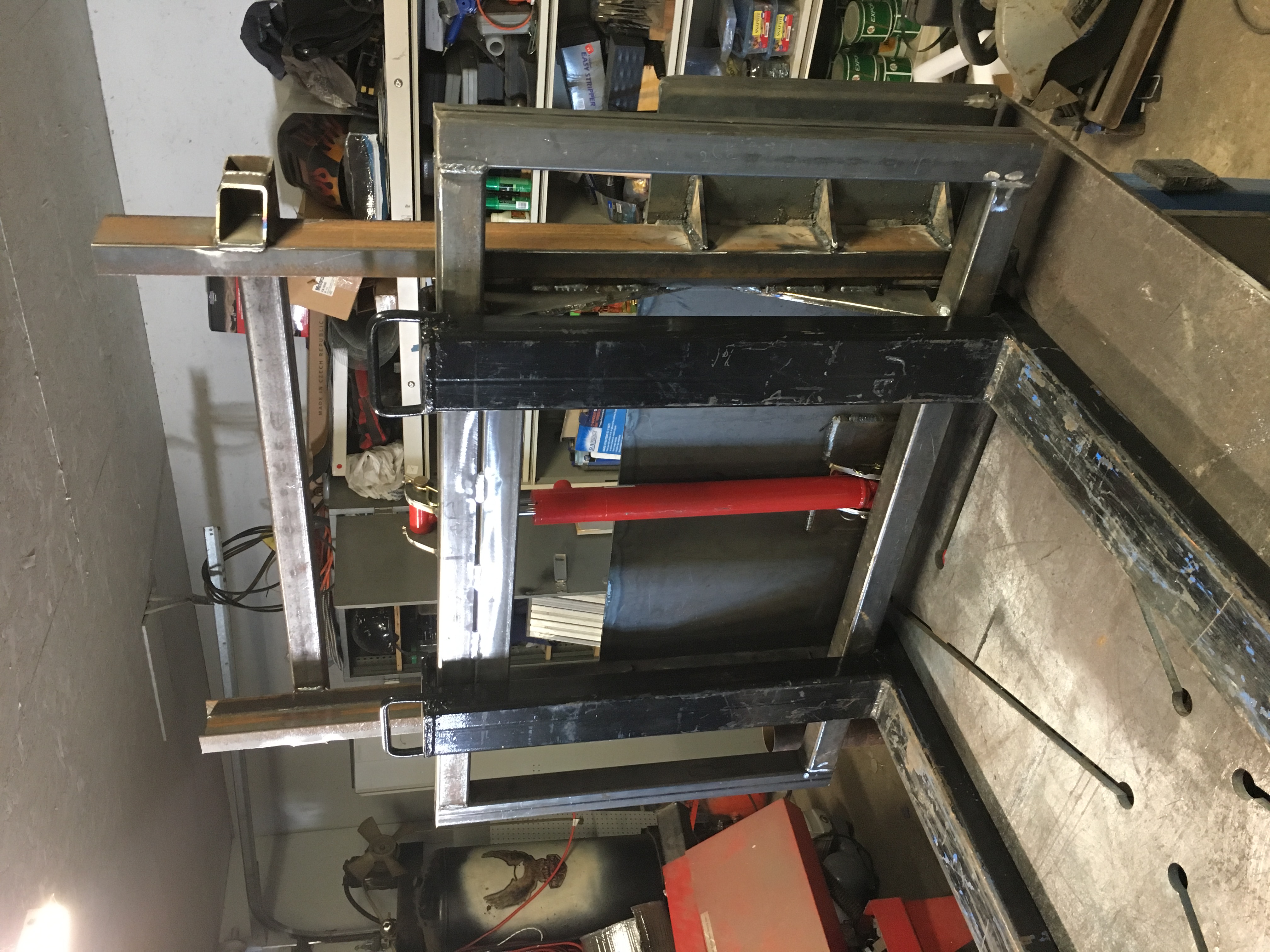

Mar 5, 2019 / Fel forklift #1 M metalbender Veteran Member Joined Aug 31, 2018 Messages 1,246 Location Sask, Canada Tractor Massey 1742 Asked about this a while ago. Just about done. Will give the extra height needed to get pallets into the barn loft.
Mar 5, 2019 / Fel forklift #2 Xfaxman Super Star Member Joined Feb 8, 2013 Messages 13,320 Location Guthrie, OK Tractor Toolcat 5610 G - Bobcat V417 - TORO+Loader :thumbsup: Thanks for the update, I remember the other thread.

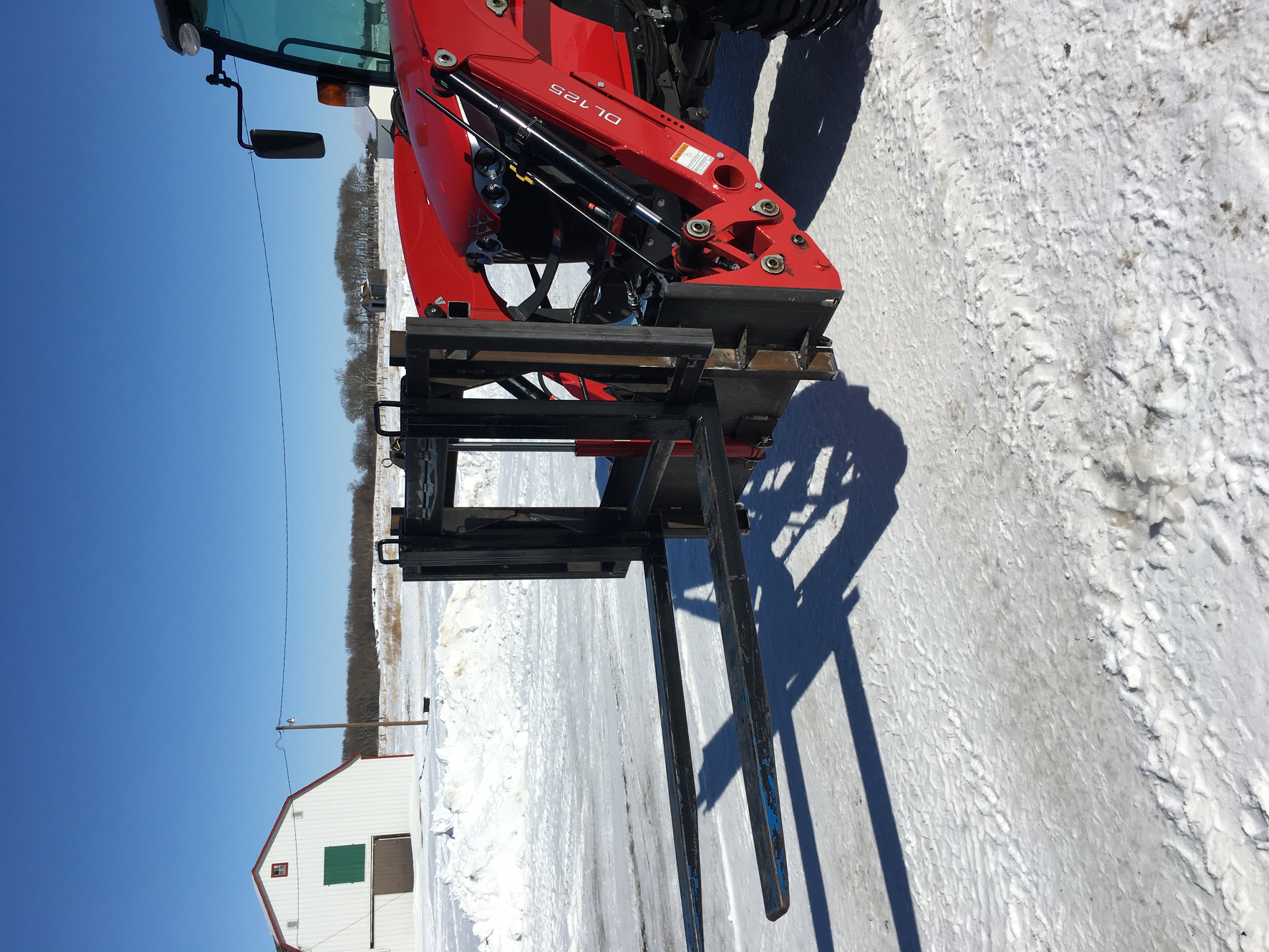

Mar 10, 2019 / Fel forklift Thread Starter #3 OP M metalbender Veteran Member Joined Aug 31, 2018 Messages 1,246 Location Sask, Canada Tractor Massey 1742 Getting close to done. Too cold for paint. Only thing I had around to test is a full 45 gal drum of heating oil.
Mar 10, 2019 / Fel forklift #4 thekkfan Gold Member Joined Aug 7, 2018 Messages 393 Location Triad Area, NC Tractor '17 Kioti NX5510HC, '65 Ford 2000 Nice. Any idea what it weighs?
Mar 10, 2019 / Fel forklift Thread Starter #5 OP M metalbender Veteran Member Joined Aug 31, 2018 Messages 1,246 Location Sask, Canada Tractor Massey 1742 No idea right now. Should have thought while I was testing. Have a digital crane scale just for that reason. I'll weigh it this week.

Mar 17, 2019 / Fel forklift Thread Starter #8 OP M metalbender Veteran Member Joined Aug 31, 2018 Messages 1,246 Location Sask, Canada Tractor Massey 1742 Checked the weight today. 293 lbs with my home built rec tube forks.
