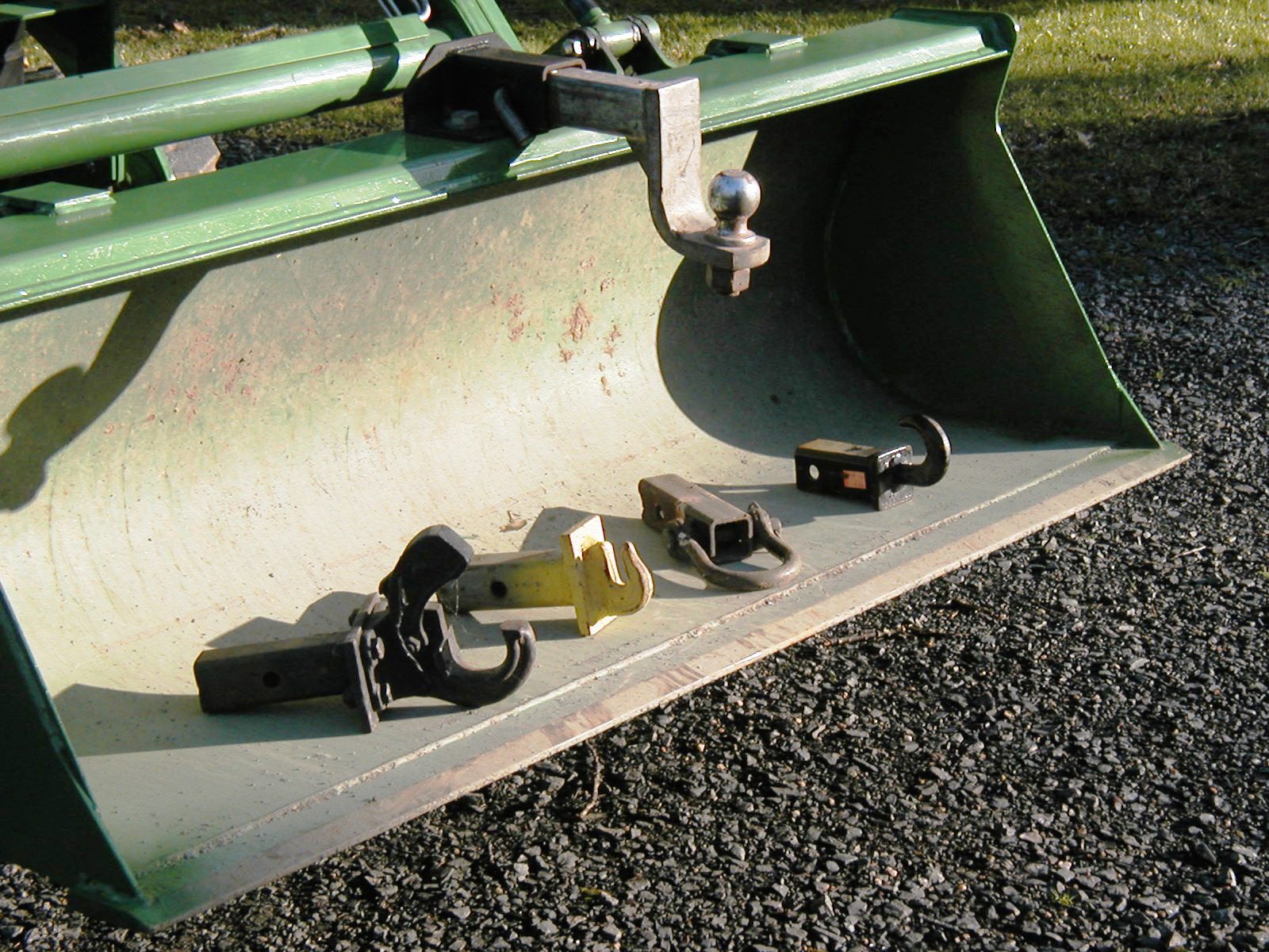

Except those nifty chain storage boxes :) and the rope comment I don't agree with most of this post. In a friendly way, not to be to harsh, I don't think there's a big safety issue but...
Lets start with the position of the hooks, first of all it's been established that outside of the lift cylinders is not the best choice, next is the angle you mounted them, defeating a good portion of the welded attachment area. I don't like it and I don't like 1/4 inch chain either.
The position of hooks on top of any bucket, not just yours, brings up another point I took in consideration when I made my "Bucket Buddy" (should trade mark that :) ) was that with top horizontal mount like most people do, in order to have hook vertical to facilitate grabbing and holding chain, you must roll the bucket forward to almost a full dumping position. which is the weakest point in the "geometry" of the loaders capacity, causing both more stress on the loader and lose of lifting capability.
Sure you can roll the bucket back once the tension is on the chain, but now you're fully engaging the cutting edge and chain. Probably not a big deal but still boogering things up a bit.
With mine, hook is in vertical position with bucket level, though there can still be some contact of chain with edge, having the bucket already rolled back that extra 90 degrees provides more lift from top of bucket instead outward on cutting edge.
I'm not a great debater, but I'll try :)

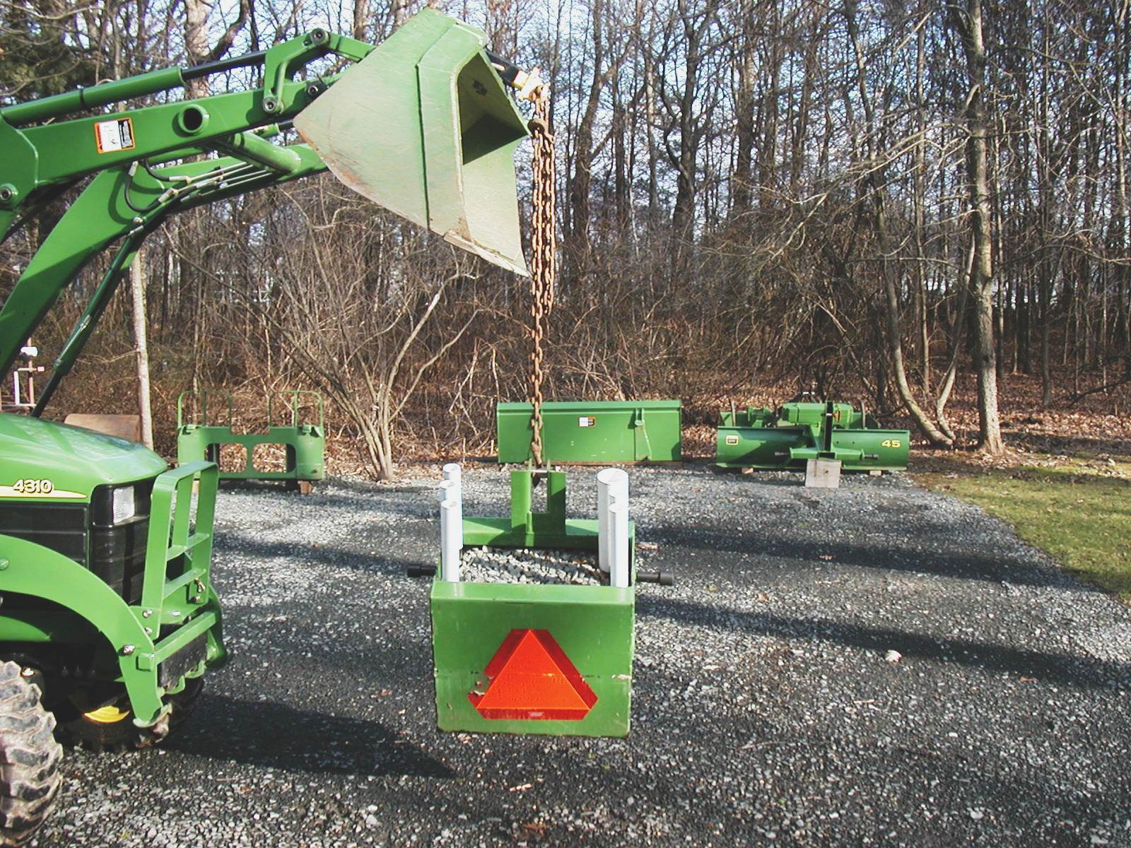

The post is intended to share ideas of what has worked well and to help newbees with different thoughts to consider.
"I think slip type hooks are poor, as you must then use the chain grab hooks, and gravity tries to unhook them. Skip the slip hooks idea. I'll debate this with anyone." The slip hooks is what I'm willing to debate.
The rest is my opinion and what has worked well for me. I lift heavy things with chain on both outer hooks, so little risk of tipping over sideways or twisting the massive LA1162 frame. For very heavy things I also have two hooks on the loader QA frame, so I remove the bucket to reduce load by the bucket weight and of course use both hooks.
No dents on the grade 70 chain yet.

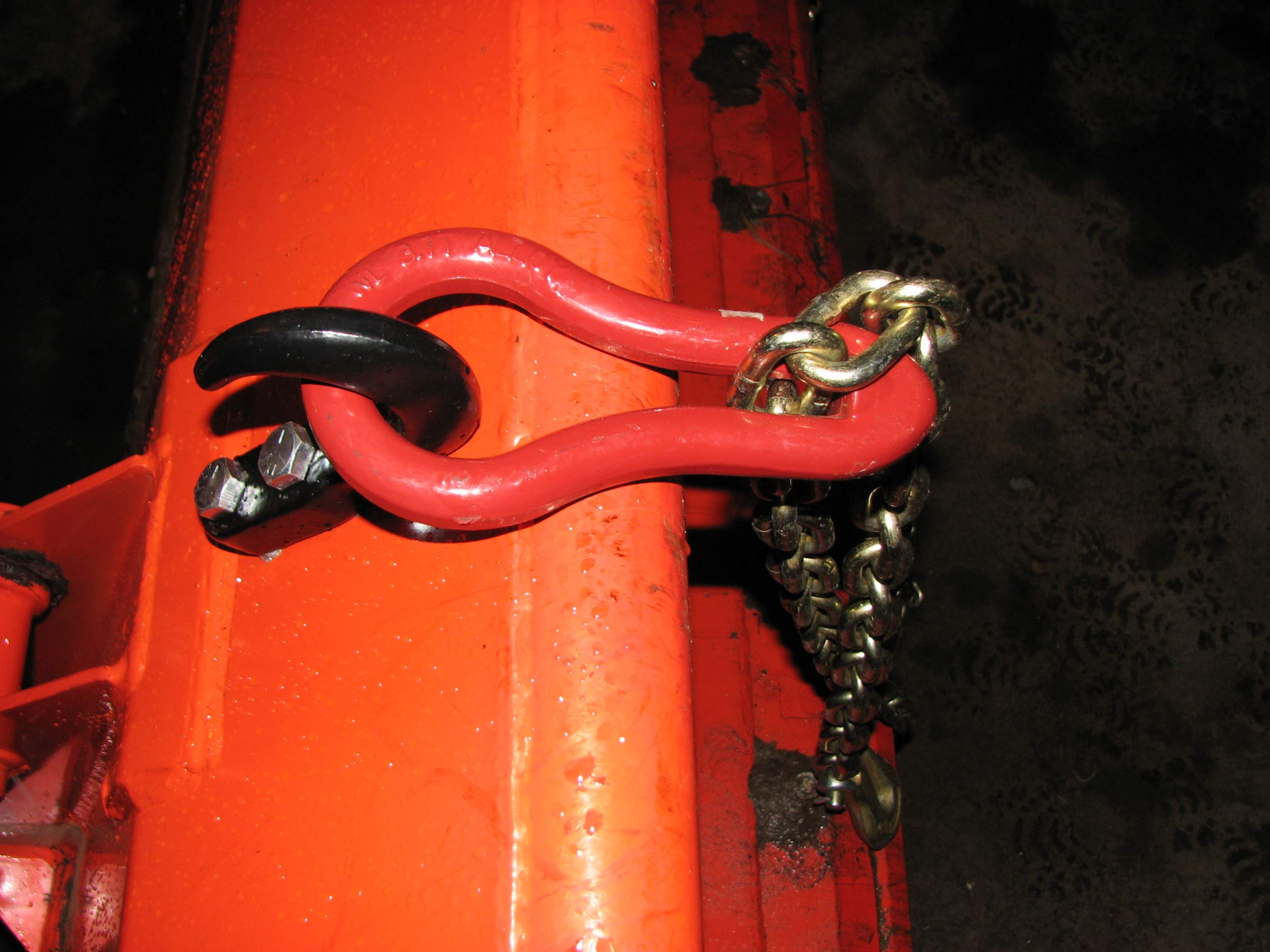

An option for slip hooks for when you wished you'd installed grab hooks:
-Jim
-Jim
Jim,
That device looks pretty slick! I have the same tow hooks on my bucket and that loop would come in handy. What is it called and where did you get it? Do you think they would have one at my local TSC?

Jim,
Not to speak for Baby Grand but I've seen them in AW direct's catalog. I'd like to get one myself.
Grade 70 Grab Link w/ 6,600 lb. WLL - 3/8 in. - Mfg# 44200
I've got one of these.
Grade 40 Clevis Link w/ 6,600 lb. WLL - 3/8 in. - Mfg# 695444
And these come in handy.
CM Grade 70 Double Clevis Link w/ 6,600 lb. WLL - 3/8 in. - Mfg# 82380
All kinds of useful, high quality stuff.

Grab link, Keyhole link, Banjo link?
Whatever you call them, they are very handy, and very easy to lose.
Never seen them at TSC, but you can always ask ...
Here's where I got mine:
Logging Attachments & Accessories - Labonville Inc.
Attached to your drawbar with a clevis you can quickly adjust tow chain length and resecure - almost like having a weld-on on your drawbar. Works really well for skidding with a boom pole & tongs:
