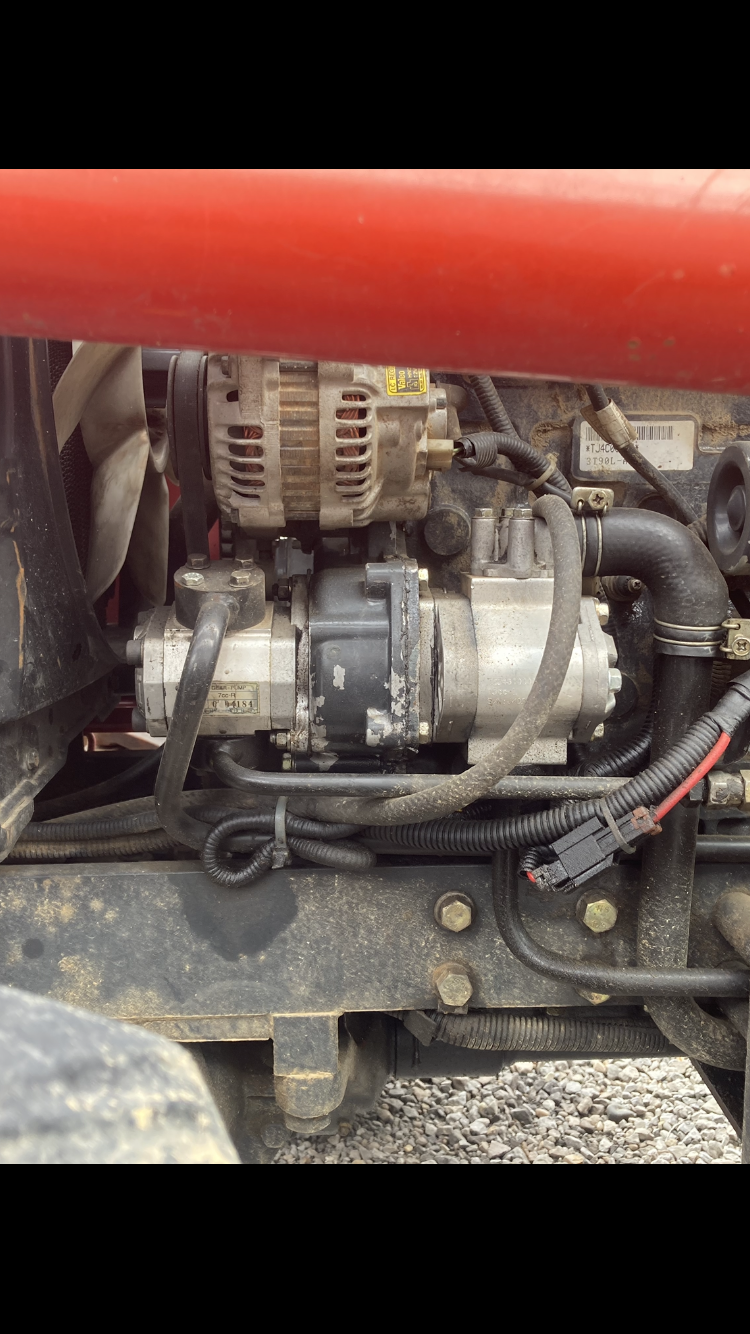

Here‘s a shot of my tractor‘s two pumps, hopefully similar to OP’s. PS on left Hyd. On right. Drive gear inside gray housing between pumps. It is a lot of work, getting to that gear.
Yes, looks like it would be.
   / FEL Hydraulics Just Died #36
Void to right is where that drive gear would reside, whole front cover of the motor is off in this picture.

OK, it appears that the main pump is not pumping.
I just pulled the plug out of the test port of the main pump outlet. A small stream/drip came out of the test port (I had a clear plastic deflector in front of the opening just in case lots of fluid would come out). I then started the engine. The small stream/drip then stopped down to just an occasional drip as the engine ran. So basically nothing was coming out.
So now I will move on to removing the pump. Turns out... the steering pump and main pump are held in place using the same 4 bolts. So I will have to disconnect both pumps to see what's going on. My guess is it could be the same situation as Mike0000's problem.
Thanks again to all.
