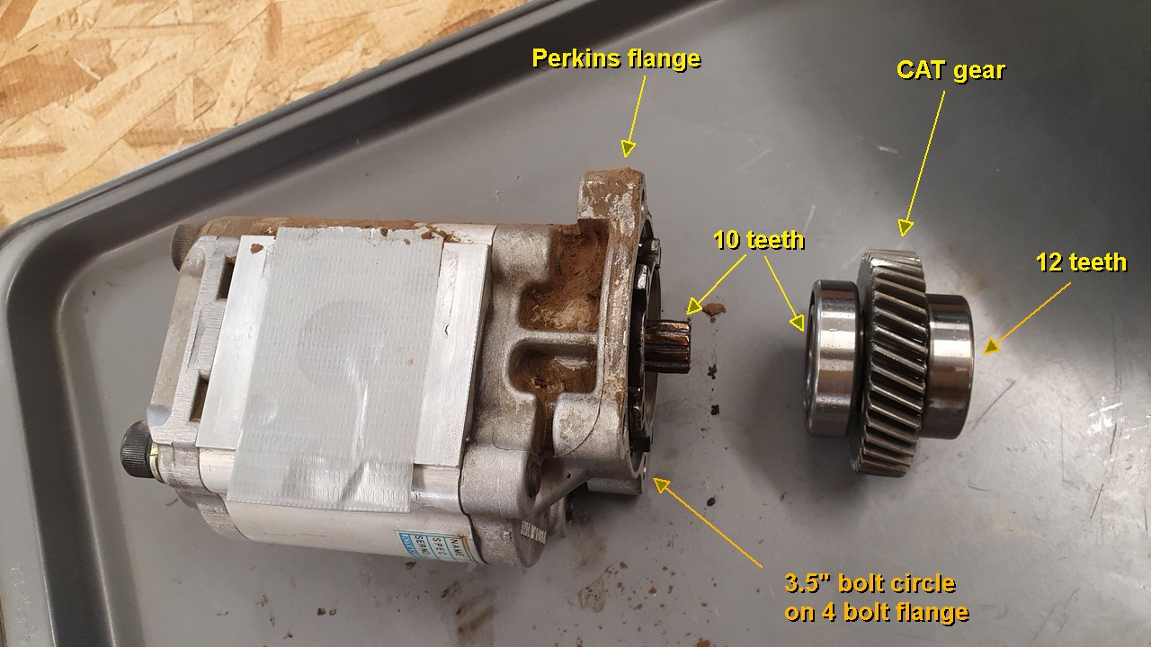

I would LOVE to put a different gear pump(s) on the engine. But at the moment... it's not possible. Here's why.
The Perkins built CAT engine has a housing hanging off the side of the engine. This is where the CAT drive gear lives which drives the pumps. The gear drives 2 pumps (one on each side of the gear). Only CAT makes/sells this gear. The gear has a 10-tooth hole on one side, and a 12-tooth hole on the other.
Gear pumps available with a 10-tooth splined shaft are rare. Gear pumps available with a 12-tooth splined shaft are rare. Much more common are shafts with 9-teeth or 13-teeth.
In the world of gear pump flanges... there are standards which are supposed to make the process of replacing pumps easier. For example, there are standard 4 bolt flanges and standard 2 bolt flanges in different sizes (for example, there is a standard SAE B 4 bolt flange which has a 5" bolt circle). The CAT housing which houses the gear has a non-standard 4-hole flange with a 3.5" bolt circle. NONE of the available generic gear pumps that I have found have a flange which will mount to the CAT housing flange.
Only the original pump manufacturer (Joyang in Korea) has a website with very detailed technical specs including showing pump dimensions and options for 10-tooth shaft and special Perkins mounting flange. I have found no place I can buy their pump/parts/seal kits directly in the US. I have tried contacting the company and have had no response. (I assume TYM will be sourcing the pump from Joyang in Korea again). They are the only place where I have even found a reference to the special 'Perkins Flange'.
If there was a generic pump (with 10-tooth splined shaft) whose assembly bolt pattern (and shaft location) matched my pump's bolt and shaft locations... I could possibly put the new pump body on my old Perkins flange but who knows if it would all seal up properly and work.
Then there's the issue of plumbing. The current setup has steel piping which goes to the 2 pumps. If I was able to find a generic pump which would meet all the requirements to install... I would have to discard the steel piping and re-do the plumbing with hoses, fittings, etc. This I could probably do but it's certainly additional hassle.
Bottom line... I can find NO generic pumps with correct size, flow, with 10-tooth splined shafts with mounting flanges that are the right size or even any mention of a Perkins Flange to replace the old pump. This is also true for the other old steering pump (12-tooth splined shaft) which has a 2-bolt mounting flange (but non-standard with the flange at an angle).
If you own a tractor... I would recommend thinking about what would happen if your hydraulic pump failed (in the middle of supply chain hell) and the mountings, etc. were non-standard. You might want to order a backup pump and drive gear from the manufacturer to have on hand just in case!

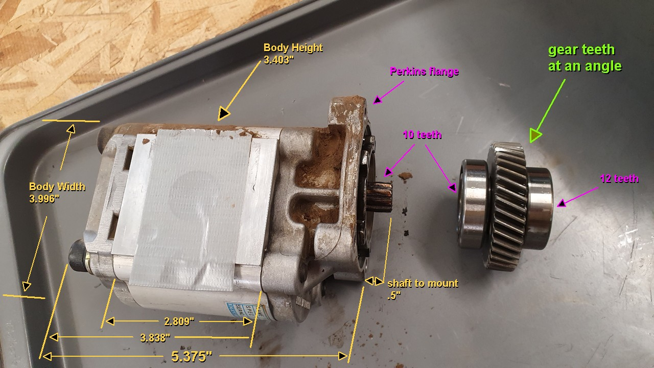

@oldnslo
Thanks very much for finding this. I will study the specs for this brand gear pump but I don't think this will work. At first glance, there is no Perkins flange and I have come to realize that the Perkins flange is special/required for another reason.
In addition to the 10-tooth splined shaft (sticking out the right amount from whatever flange to insert in the gear hole the right amount), the Perkins flange is special because the flange actually participates in holding the gear in the right position. The bearing on the gear (on the main gear pump side) actually inserts into the inner chamber of the Perkins flange. When tightened down, the gear is supported/positioned in the correct spot. Therefore the Perkins flange is required for the system to work. See attached image showing bearing and chamber on Perkins flange.
Looks like another flange can't be substituted.
Thanks again.
