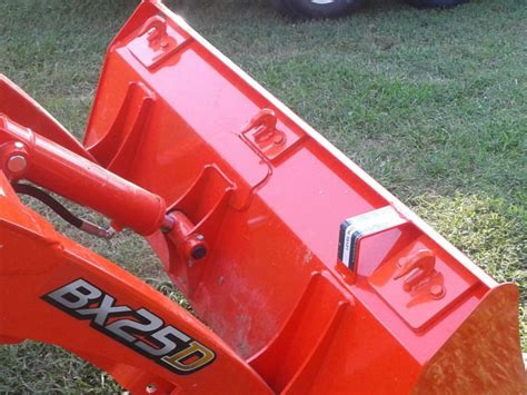

I get by with just this type. I can see the top flat and I can level at any height. When I place things above head height on a shelf this works well. When the top flat is level the bucket is level regardless of the height off the ground. The rods and such only work at ground level I think and the flat bar on the bucket works there too.
Thanks for the photo. Our Kubota has two of those handy horizontal brackets - one on both sides. It looks similar to yours, although on ours the reflective tape is on the top horizontal flat part.
It was nice of Kubota to make them so visible and weld them on exactly parallel to the cutting edge.
I wish I'd thought to do that with our other tractors years ago.
No moving parts, no rattle, instinctive to use, and always shows the true bucket angle. From on the ground on up to about half max height I can judge bucket angle with one glance at that bracket.
It's particularly handy to keep the bucket angled up a few degrees moving snow so it doesn't dig in.
I find the brackets to be more instinctive & useful than the tube & rod system. But some folks don't like to judge level that way and a few even get passionate about it. I don't understand why.
