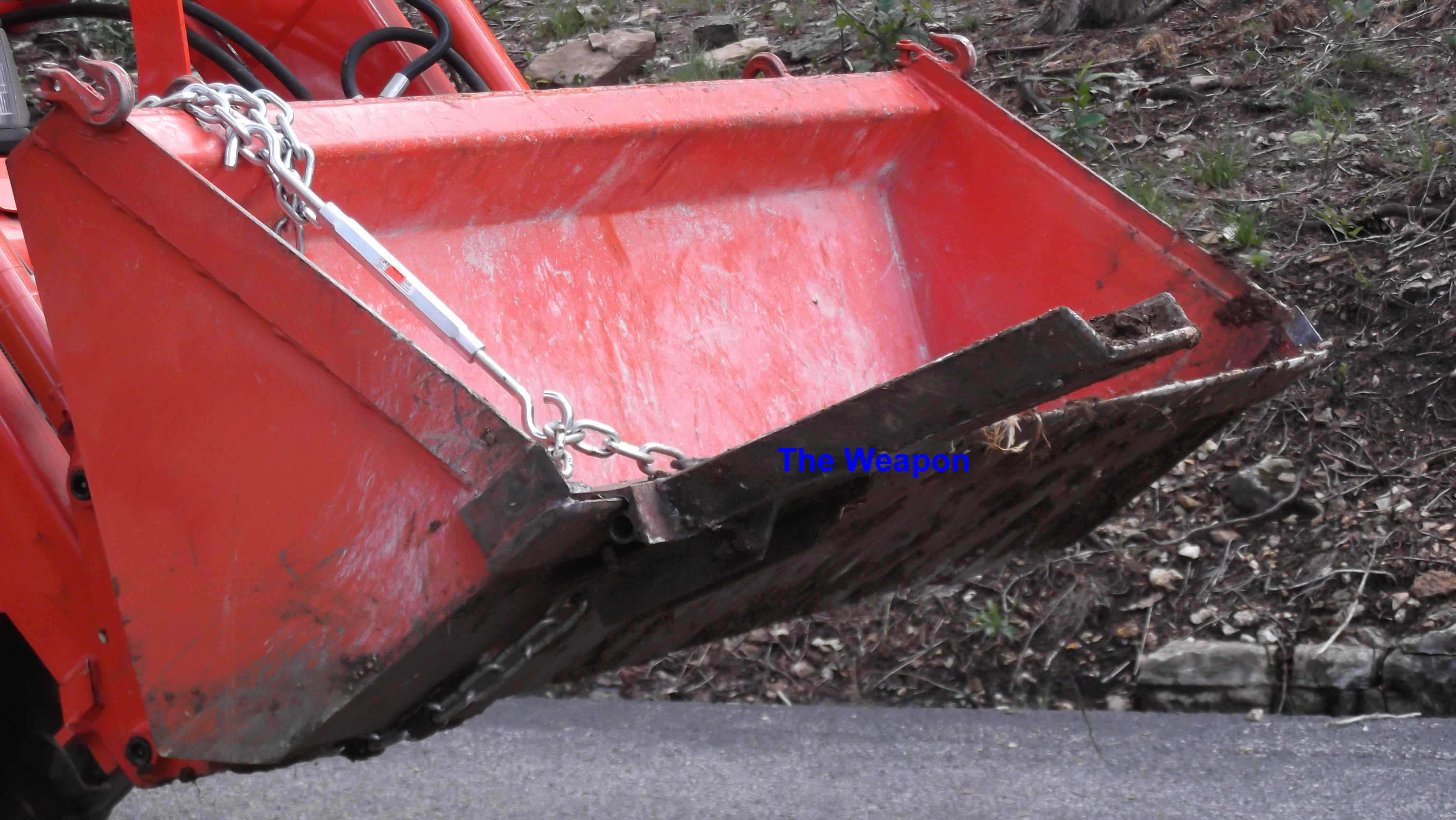

FWIW, the Paumco combo-spade was the first non-kubota implement we purchsed, but i think if I could go back, and do it over, I wouldn't buy it again.
It's a chainon version of those above- about 2 feet long by 20" wide.
Don't get me wrong, it can be useful, but mainly for more selectively picking up rock or logs.
What we wanted it for and were led to believe it would work for on our Kubota B2320 was to dig up stumps-and I believe we were sold a bill of goods by Paumco's owner, who told me that it would be able to do that on our tractor...
Not enough weight in your tractor? Did it do any damage to your bucket?
/ FEL (quick attach) Tree Spade #14
Well, having loaded our rears and using our greater than Kubota recommended weight ballast box has helped, but since all weight is in back, it hasn't helped that much.
I really think that it is a weight and power issue.
It had not damaged the bucket until last fall- mostly because it is chained around the whole thing.
Unfortunately, last fall while we were digging drainage trenches, we found a boulder, and as we were digging it out, the turn buckle/chain tensioner [lever type, not ratchet] opened up without us noticing it, and our bucket lip turned into a grin...

You can fix that grin with a hydraulic jack and a chain. Jack it slightly past grin, into the frown territory and let it spring back to straight.

Hi James,
Thanks- I used your links to search out bent bucket lip posts, and found quite a few that also suggested that.
I'm leaning towards putting spade back on, resting it on top of another boulder, and bouncing up and down on it, or jacking on it as you suggested.
