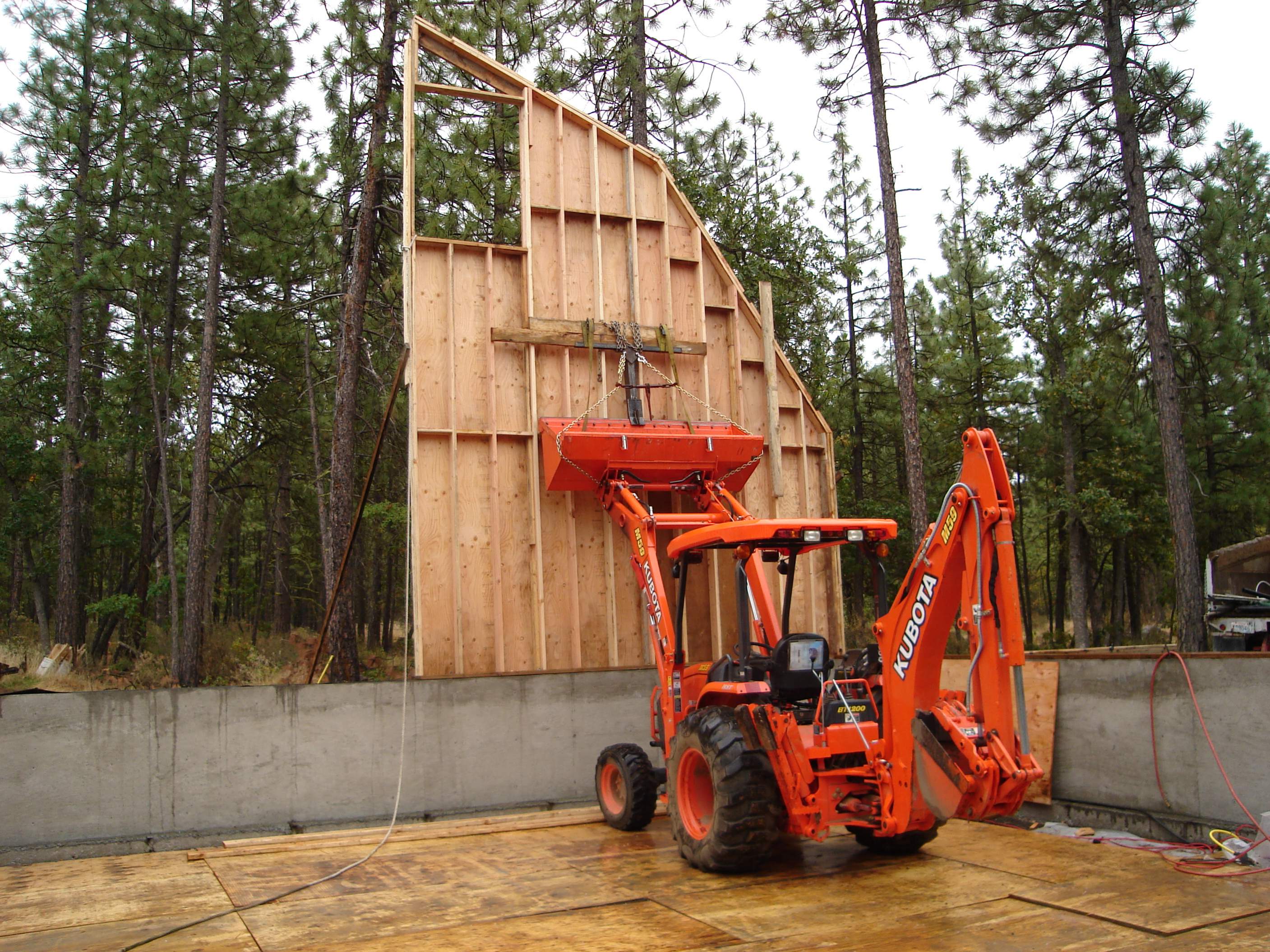

This is an interesting subject. If you look at that 20' pole hanging from the bucket of that tractor, most people's first instinct would be to say it isn't safe. That's exactly what I thought when I first saw it. You're using the machine in a way it clearly isn't intended to be used, so of course people are going to say negative things about it. You'll get some who support it and some who won't. I don't see any reason to insult either party for their beliefs on the subject. Just because somebody sees this and disagrees with it doesn't make them less of a man than anybody else. It's a forum, criticism will come out sooner or later, and definitely sooner on more extreme things (such as a 20' pole hooked to your bucket, for example).
With that said, I never saw the previous post about this so I'm wondering how it all works (without tipping the tractor over, etc). I had a full bucket of dirt, about an inch off the ground, made a very slow, tight turn on dead-flat ground and my tractor started tipping over. So then, how can you lift all that weight that high and 20' out from the bucket without incident? Did the rear end of your tractor ever bob, even slightly?

I use a boom pole like that and have a piece of plywood with four corner cables on it attached at the end.
I can put up to 2 bundles of shingles on it and lift it right up on my roof. sure saved my back, and I would say its safer.Not to safe carrieng a bundle up a ladder..LOL

My guess is that he is moving the tractor very little on and on smooth ground after lifting. Also there would not be an need to lift high until very close to position.
Also from the roof of his tractor I am guessing that is a TLB with a heavy backhoe on the back for a counterweight.

My only resource was archived plans off university websites for inspiration and a look into how things used to be done. The door pillars arose out of my reasoning that a 16' opening in the end of a 30' barn had to compromise its racking strength. So I ran the foundation up to the top plate 4 feet either side of the door. I do tend to overbuild to compensate for my lack of engineering. As a mechanical contractor I do have a lot of exposure to building systems and a lot of friends in the trades and I pick their brains for most of this stuff.
Regarding the safety of the boom pole, it came down to a matter of necessity. I certainly would never presume to recommend any of these extreme modifications, but we all have to evaluate our own risk aversion and all have to accept responsibility for our own choices. I am not willing to do nothing because there is an element of danger, I do all in MY power to minimize that danger.
I will yield the soap box now as I am not SO egotistical as to think everyone should agree with me:) I realize when I put myself out there that I am inviting scrutiny, but I can honestly consider others recommendations and still choose to do it my way, it doesn't mean we cant be friendly.
Many of these boom loads are much lighter than a bucket of dirt, and I always move as little as possible and make great use of my backhoe for counter balancing. I also do dry runs and performance tests to get the feel of what my tractors limits are. But in the end, ya just got to get er done.

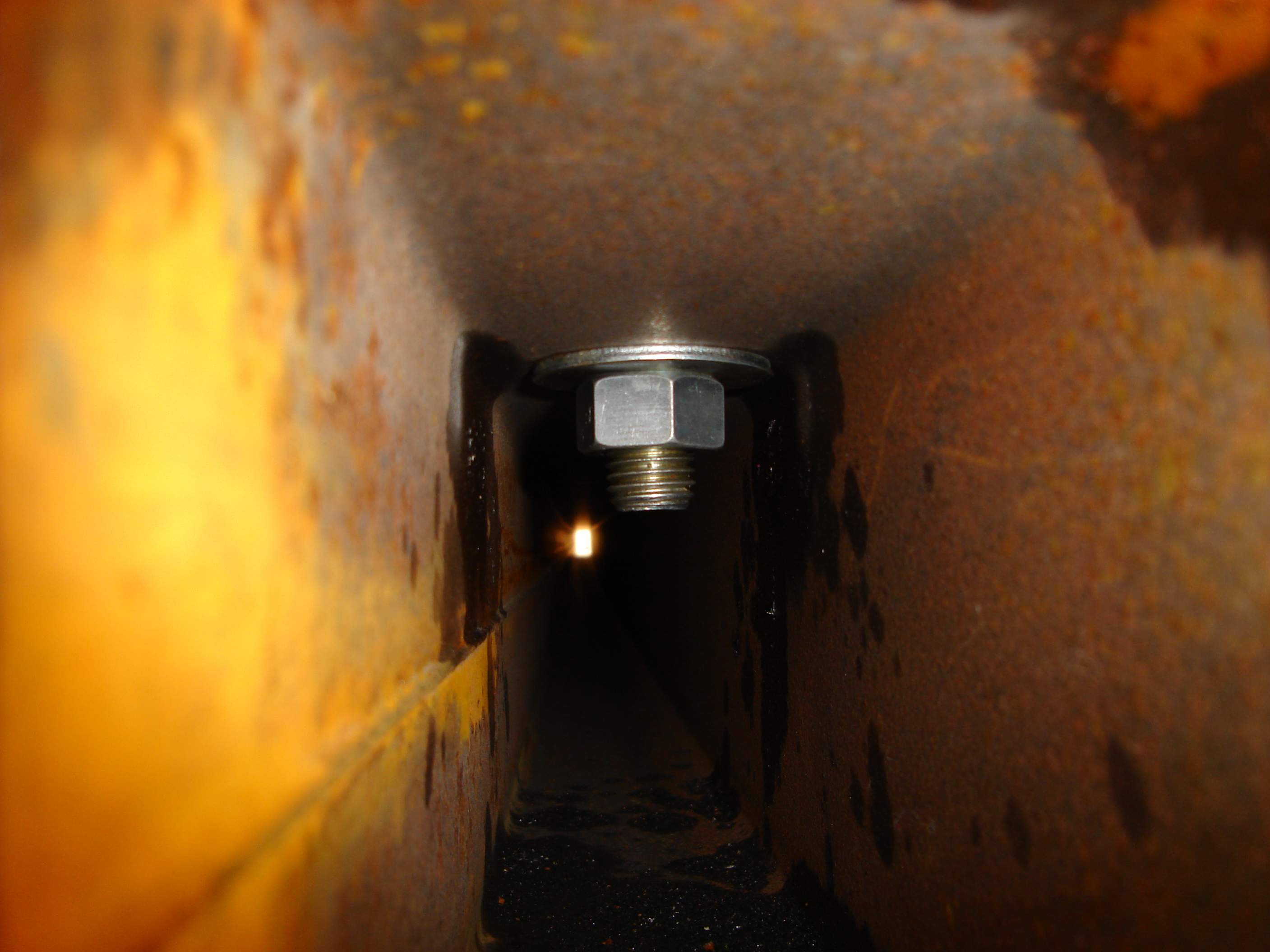

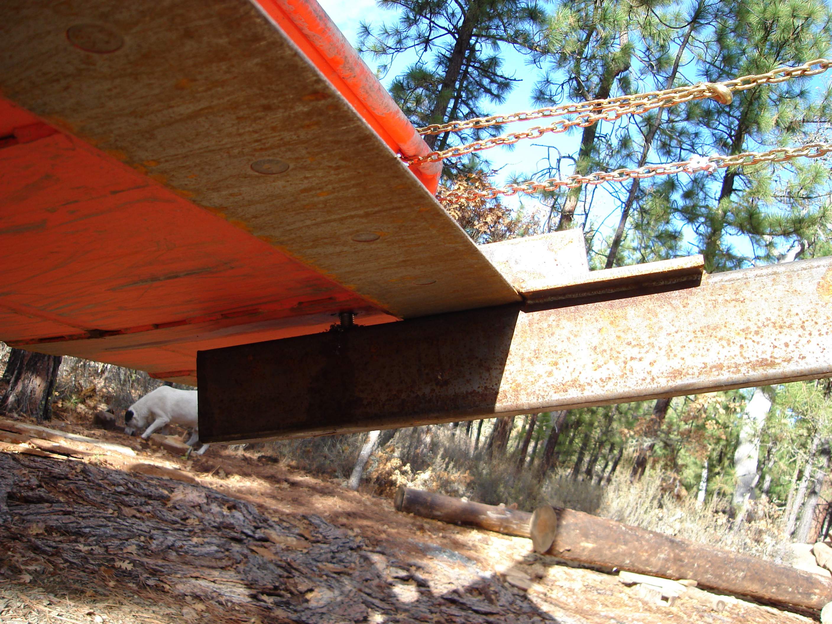

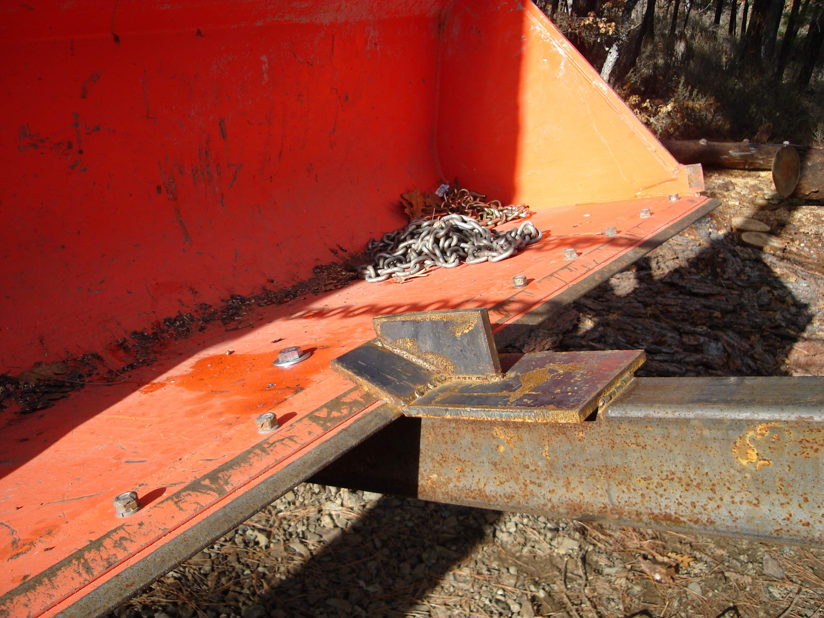

Nice work. I like your design.
What keeps the boom from tilting back on you? Is it back-bolted to the bucket?
   / FEL Tractor Crane *Proof of Performance* #38
Primarily I just keep the load and boom angle well forward. I do have a 3/4 inch bolt thru the bucket into the end of the boom tube, but its only purpose is to keep the end from shifting side to side. The mating cleat is inline with the bucket edge and all other non-inline (downward) forces are handled by the chains.
