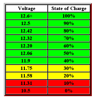

After reading through this and other threads I checked battery voltage --- it is a one year old NAPA replacement for the original Kubota battery -- and it measured 12.3 volts. I thought it was unlikely that it was the battery, but I went to the Kubota shop and bought a new battery and installed it. I turned the key and it started :). Here is the history of my problem:
I experienced some intermittent starting problems just prior to the RTV900 being taken in for service. I would turn the key and there was no cranking sound, no dash lights, nothing. After various intervals --- sometimes a day, sometimes several days, sometimes an hour -- I tried starting again and the vehicle would start. I would use it for various tasks and then the intermittent start problem reoccured. Kubota service found no problems.
After the vehicle was returned from service, I used it for several hours and then after dumping a load of rocks and the bottom of my driveway, it would not start. At first the symptoms were similar to past starting problems only there was a buzzing sound from the engine compartment if I turned the key hard to the off position. This would happen sometimes and not others. Then after one starting attempt and buzzing occurrence, when I turned the key the dash lights came on but still no start. After this, with each start attempt the dash lights came on, the horn worked, but the RTV still did not start.
While the vehicle has started just fine since battery replacement, I am not sure there isn't some issue with the ignition switch and I may replace that as "just in case" insurance: getting stuck in bad spots and having to be towed is its own problem and cost.
Anyway, an apparently bad battery was my problem for the starting problem. I would not think that a year or so old battery would be the issue, but replacing it did solve the problem.

For clarity, I'm Old School. Back in the day, batteries worked if they had 12V in them. That seems to not be the case now. Measuring voltage on a sedentary battery doesn't tell you much. What needs to be measured is load draw. I recently replaced $730 in batteries on a JD road grader. Both measured 12V. Grader would not crank. Replaced batteries, problem solved. I didn't have the ability to measure load draw. Frustrating, but at least you solved a problem. :)
   / Fellow Kubota RTV900 owners / mechanics - H E L P P L E A S E #96
A battery with a bad connection, like the cable, may read good battery voltage but won't allow enough current to turn the starter. It can even be an internal issue with the battery its self.
   / Fellow Kubota RTV900 owners / mechanics - H E L P P L E A S E #97
this is a good point and I thought that maybe the cable connections were too loose, but I don't get how the intermittent starting would be affected by that. Anyway, it works now and I probably will not be the last person with this type of issue so thought it was worth adding my experience to this discussion....
   / Fellow Kubota RTV900 owners / mechanics - H E L P P L E A S E #98
Electrical trouble shooting 101: Always start with a known fully charged battery. The national chain auto parts stores will load test your battery for free.
A 12 VDC flooded cell battery that measures 12 v is only 50% charged. Sulfation and other internal degradation can cause a battery to indicate sufficient voltage, but the battery will not put out sufficient current to start an engine.
