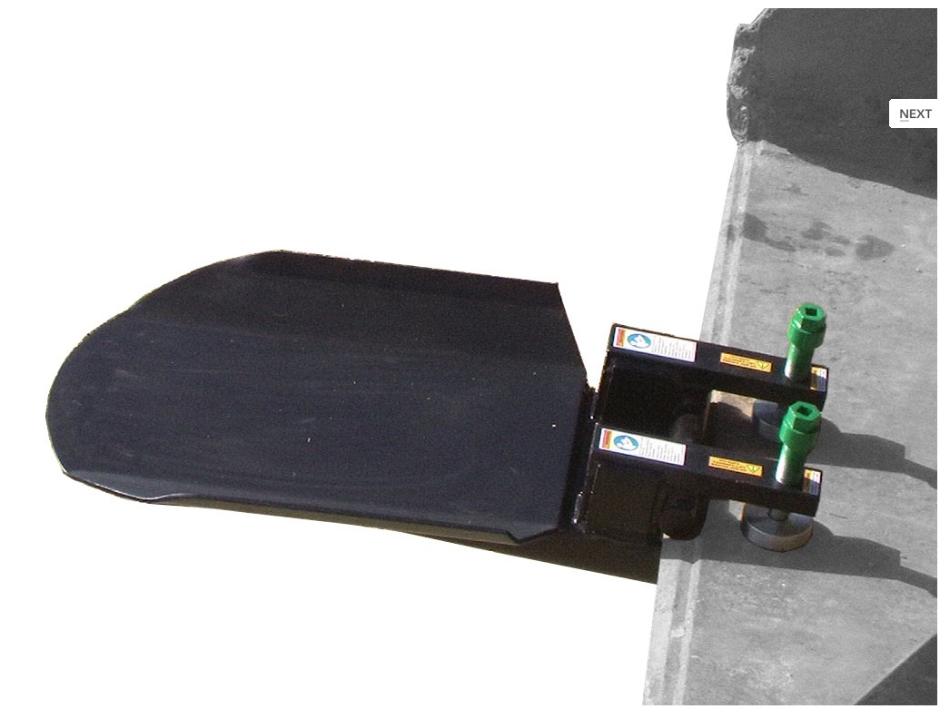

I attach a bucket attachment spade on my [AFFILIATE=1, nofollow=true, newwindow=true, title="Kubota"]Kubota[/AFFILIATE] L3400. That said, I'm very carful to make sure it's exactly centered on the FEL, and dig only when there's been a good rain and the earth is as soft as possible. I go in at a shallow angle from multiple directions, then more directly to break down the edges of the hole. This works fine. But I never try to plunge the thing in more vertically and then try to pry out a large chunk.

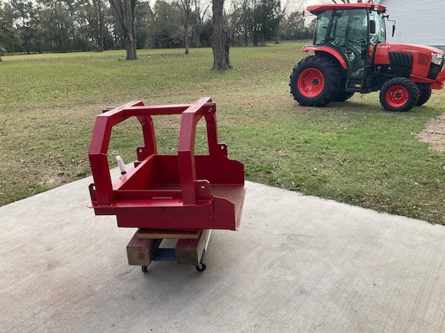

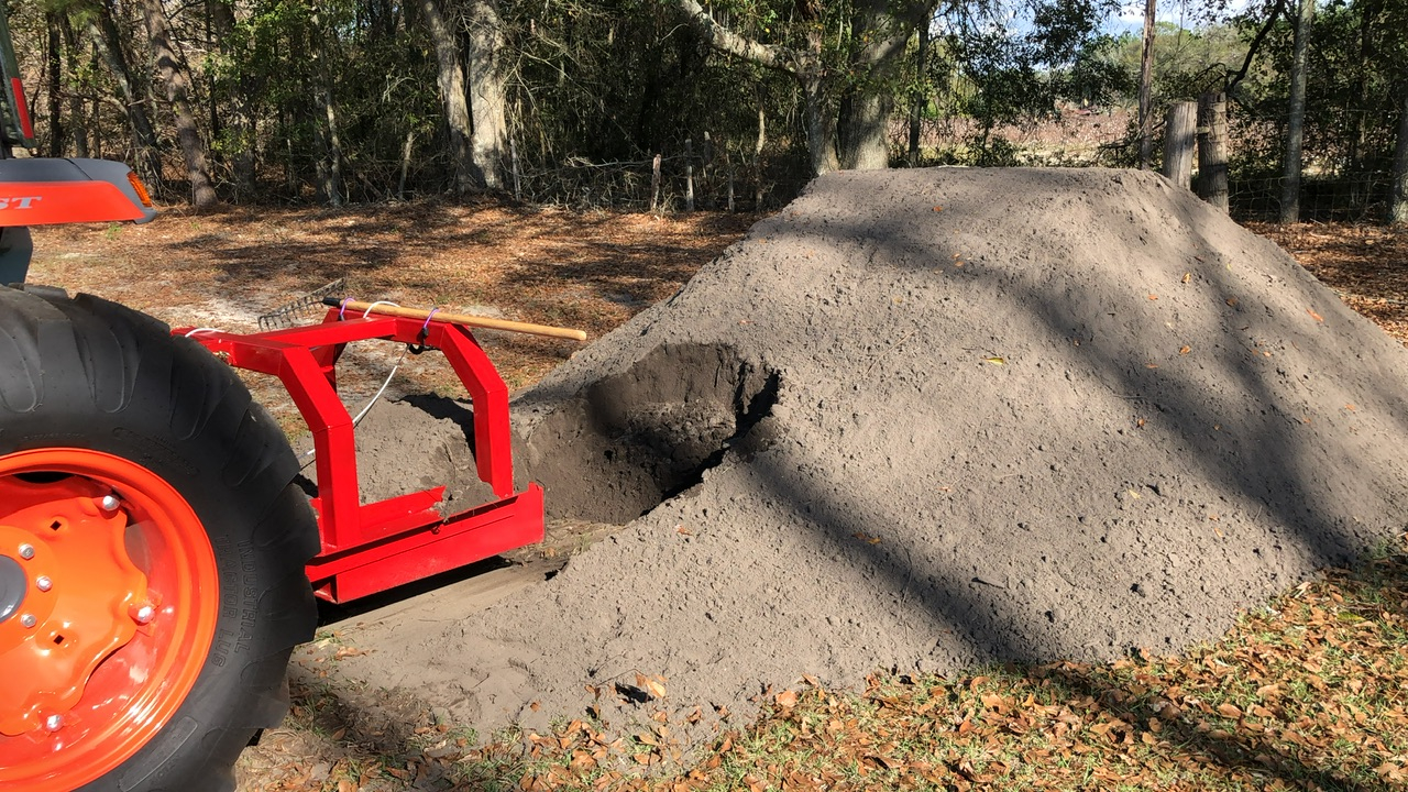

Pond scoop, or called a dirt scoop around here. I have one I bought slightly used at a farm equipment graveyard for $200. (no FEL here) Definitely old school and it has it’s limitations but works well once you figure out its quirks. Dig a trench or skim going forward or scoop from a pile in reverse. People ask “why not a FEL”. Well currently they are back ordered for about a year, cost $6000, and I don’t have much use for one, I mostly mow.
   / FELs and digging #47
Pond scoop, or called a dirt scoop around here. I have one I bought slightly used at a farm equipment graveyard for $200. (no FEL here) Definitely old school and it has it’s limitations but works well once you figure out its quirks. Dig a trench or skim going forward or scoop from a pile in reverse. People ask “why not a FEL”. Well currently they are back ordered for about a year, cost $6000, and I don’t have much use for one, I mostly mow. View attachment 778384View attachment 778386
Yours is about 1/3rd the size of my 2 M9's. I run R1's as well with cast centers.
