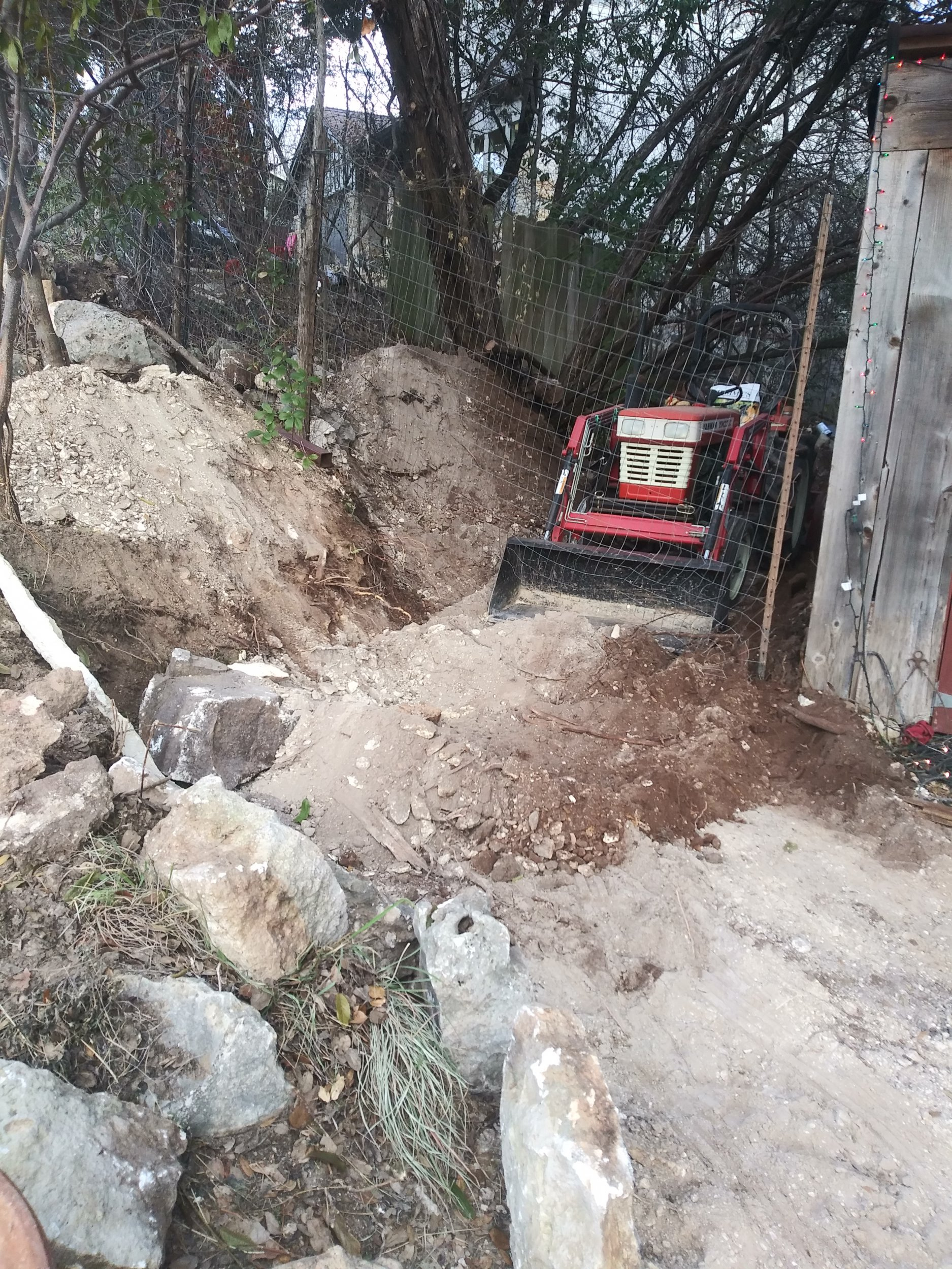

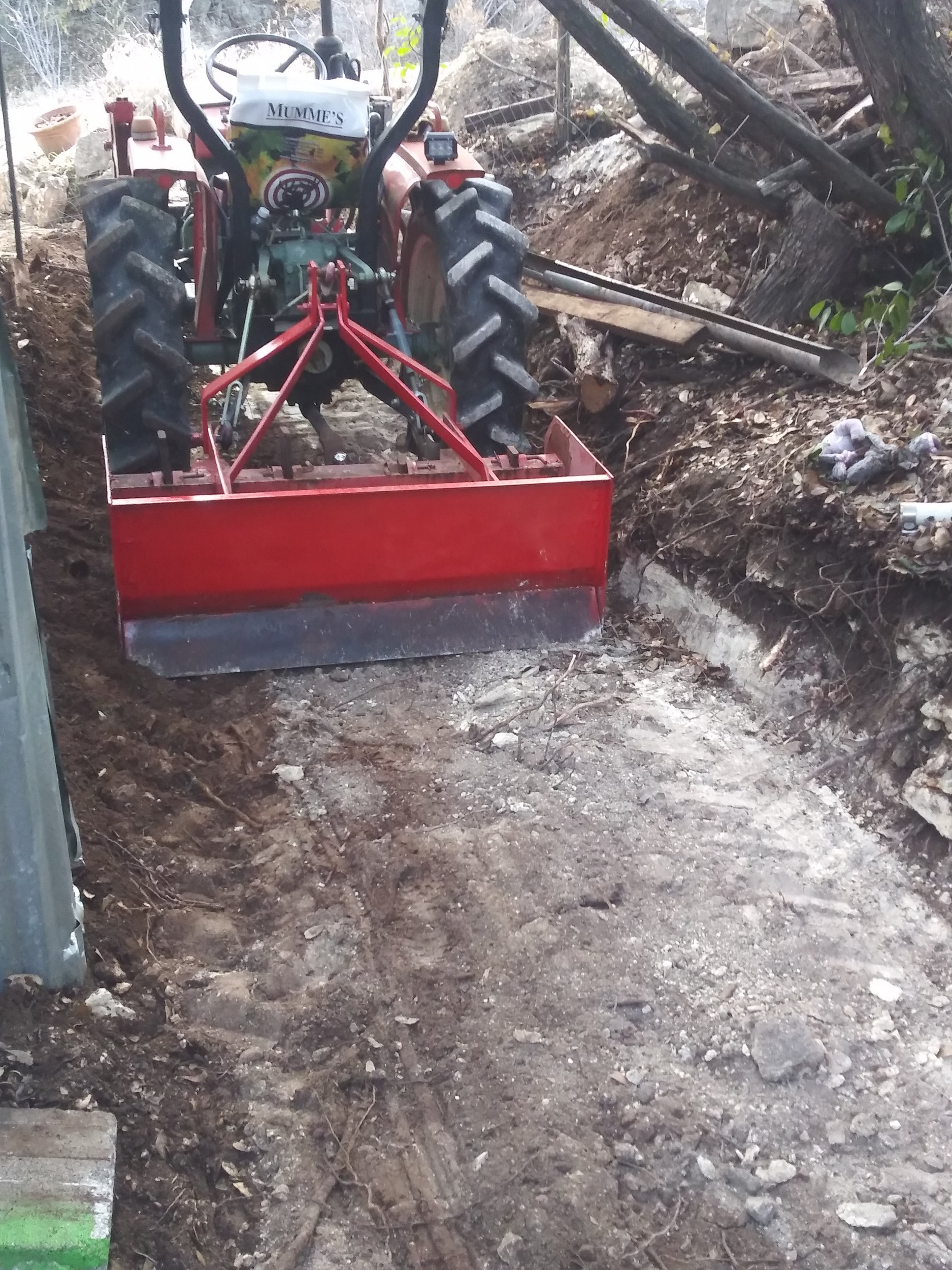

I just carved out a rock hillside with a light weight flat tooth bucket on a koyker 80. Went real slow and used the rippers when I could. Had very little space so bucket did most of the work.
Went slow but job is getting done. Just pushing along the top of the rock scraping a few inches at a time.
Might as well use it. If it breaks just fix it.

Not sure on the Koyker 80, but on the K2 K3 and 200 +series FELs they designed the FEL to Tie into the rear axle with heavy supports, a large cross support in the middle where the FEL uprights are and then forward running supports that mount at the front of the tractor.
At least with This style of mounting, much of the stress/force is transferred to the rear axle and is spread out. These new tractors mostly ditched the design and mount mainly to engine side supports.
Koyker's older design May not be Pretty and limits engine access a bit, but if you are going to dig with a non industrial CUT chance of success is probably improved.

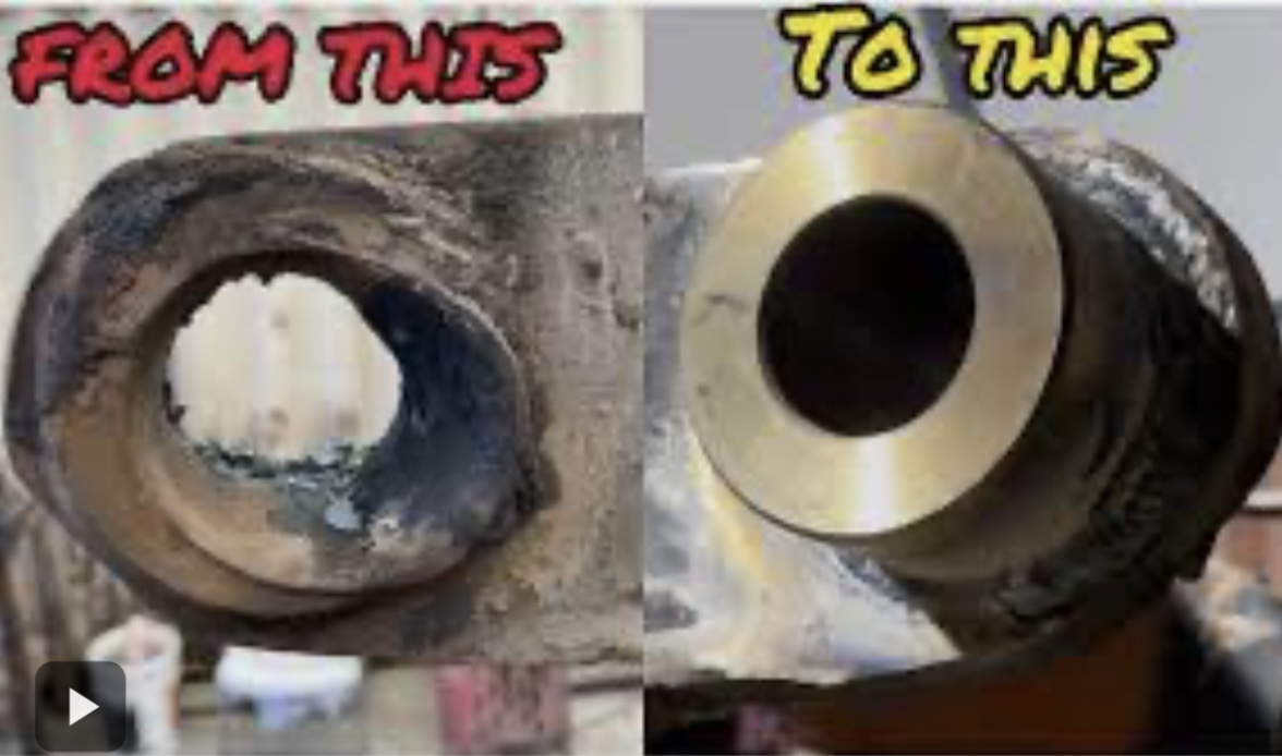

Look at the following image. On construction (read earth engaging equipment) machines the pins and pin bosses are oversized and frequently use replaceable bronze bushings. The bossess will be 1+ inch thick with gusseting. Now look at your tractor bosses. The are only 1/4 inch thick without gussets and light duty. Using your AG or residential quality tractor will result in premature wear and equipment damage like the image below. Your tractor isn't designed to handle the loads created in earth engaging work.

That looks like more of poor maintenance than anything else. Not an issue with either of my units as I re-machined all the pivots and trunnions and fitted them with Thompson Linear roller bearings and alemite fittings. Even on my 2002, 6000 hour unit, all the pivots are tight with no slop. Neglecting equipment always has a price. On fact, both my tractors get greased every 10 meter hours. Grease is the cheapest commodity you can buy. Use it. Same applies to all my vehicles. Oil changes, filters and fluids get changed regularly and often.
