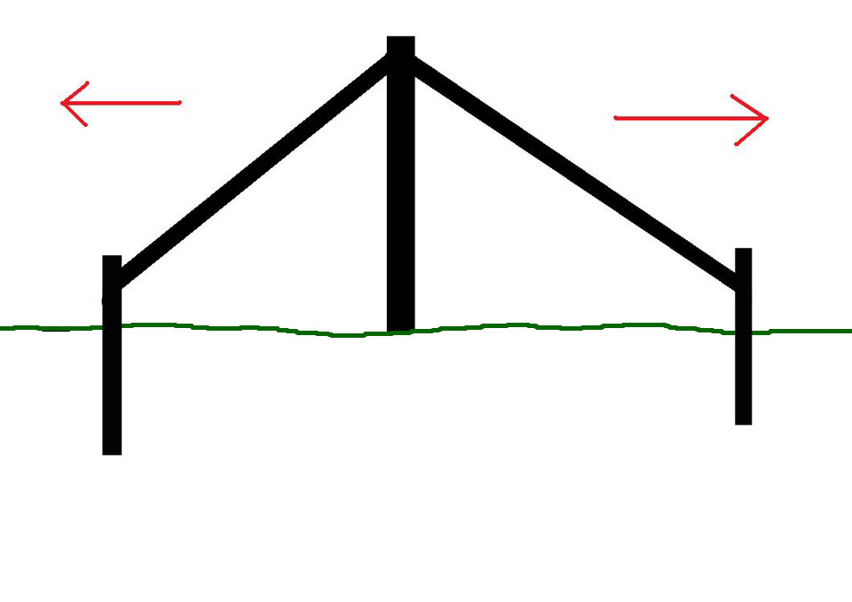

Does anyone have a good website or tutorial that shows how to properly build a deadman brace for my inline braces? I know the pressure from the deadman goes into the ground, but I don't know if the angled post terminates slightly below the ground on/in a concrete footing, or if there is another pipe welded to it that goes down in the ground like the rest of the posts.

Brian, we have 2 "deadmen" around here. Say you had a narrow ditch running under your fence, but its fairly deep 3' or so. You can tie a tee post to it after the fence has been pulled tight. Then drive a short tee post at an angle in the the ditch then pull the fence tee post down and tie it off the the tee post drove in the ground.
The second one would be in a catch pin or very short run of fence maybe 100'. Maybe if you where runnng by a short drive way or round or some obstruction. It is a corner post built out of a power pole or railroad tie. Something fairly large. You put it 5' or so in the ground. At its base right below the surface of the ground you bury a 4' post running horizontal on the pulled side. The post laying in the ground is the "deadman". This can also be used for posts which headgates are bolted too. They dont seem to be to effective on long runs where the weight of the wire is great. The work real good to use a single post to change direction.
I have'nt found anything stronger than the old relible H brace. I would'nt think about using anything else.
For your question on how much to pay a welder to do your work. I guess you pay him/her what they ask for. You have to decide what you can pay. If I was taking this approach I would just go to a couble welding/fab shops and get some prices on me dropping off the materials and drawings and be did with it. Unless you have that welds that you trust. Do all the fabbing your self have it ready for him and let him weld. Although I would suggest suppling the beer after the work is threw.

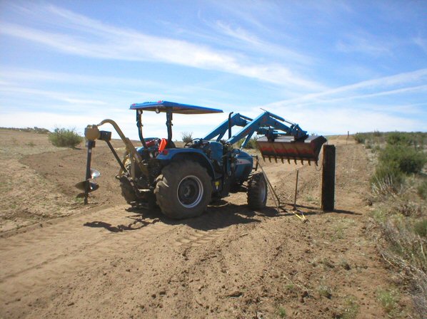

I am surprised at how few people use old telephone poles. I don't see the need for all the bracing myself, I guess it might just be my conditions though.
