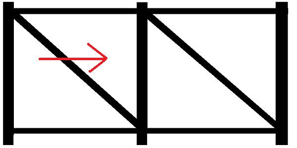

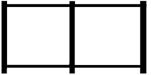

My plan is to use 4" pipe for the corners, braced with 8' long 2 7/8" pipe top and bottom and a diagonal. I am going to try to attach a sketch to show what I'm talking about. I plan on using these double h-braces at all corners, and every 330' or 660', not sure which (advice?). I am going to run 47" Red Brand Field Fence (9 guage top and bottom wires) around the whole property, with a hot wire across the top through t-post caps, and one in the middle.
I plan on using 6' t-posts spaced every 12', with 52" sticking above the earth.
I will be containing cows, horses, and possibly sheep and goats. Also, I'd like to keep it semi-dog proof (another plus for the field fence).
Is the design on these h-braces adequate? Do I need the cross bar? What size of pipe should I use (sch 30, sch 40, etc) I plan on sinking the posts 6' in the ground (skid steer with auger rental), and concreting them in. I also considered filling the pulling post to the top with concrete before it is capped.

I think it's more than adequate. When I redo my fence I'll be using a standard "H" brace and make sure that it's in the ground at least 3ft in concrete. I prefer my "t" poles to be 10 feet apart if keeping cattle. When you say field wire I assume you're meaning barbless wire. If so then hears how I'd accomplish it. Top strand barbed, next 3 strands barbless, 4ft. goat wire in front of that. Main reason for barb on top is horse will have a bit more respect on the fence and won't be to eager to lean on/over for that tasty morsal on the other side. Should keep all other critters in there place without any problems.

I guess with the h-braces, I'd like to know if I need the diagonal brace, like the sketch above, or if top and bottom braces alone will be adequate, like the sketch below.

If everything is welded and you sufficiant depth then I don't see why you'd need diagnoils. Generally the way it seems to be done around here is using your last picture shaped into a corner brace with a single "h" brace every 100ft. This will allow that should the wire be broken through you'll have a mounting/stress point without redoing the entire strand. I personally am not a big fan of electric. I guess I'm more old school. You're wire looks fine but I'd still back it with barbless for added strength. I've seen bulls walk through most wire fences and some have jumped 5" fences to get to the neighbors cows.

My main questions are as follows:
Do I need the diagonal cross brace for the corners?

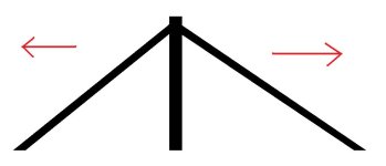

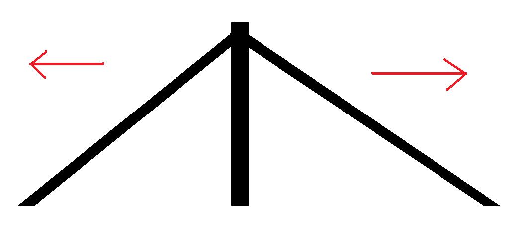

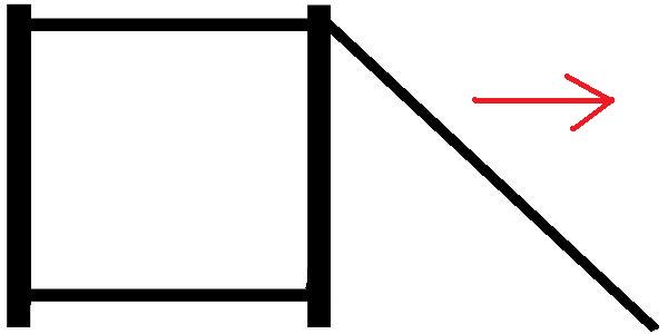

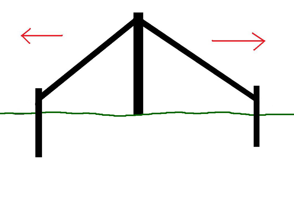

Another design I have seen is to have a single h-brace with a deadman, as I have attempted to sketch below. How is the deadman anchored in the ground? Welded to a pipe set in a footing? Set in a 3-4' deep footing as far down as the angle will allow?
Would putting up single h-braces, or a single post with a deadman on both sides (as sketched below), every 330' be adequate? This is the length of the rolls.

Since no one else has mentioned it, first off all, welcome to the site. And, as you can see by the replies so far, there is certainly no harm in starting your first post with a question.
I like your first "H" brace sketch with the diagonals myself. I also think a single post with two angles would be an adequate line brace.
That said, I just "Goodle"d up Red Brand Fencing and they do indeed have a website with downloadable installation and bracing guides. I stopped when I saw how long the bracing guide was taking to download though.
I have no personal experiance with Red Brand though I know plenty of horse people like it. Most of the installs for horses that I see have a board across the top to negate the effects of leaning but electric will do as much. Having used fencing from a number of other suppliers, I always study up on the manufactures recomendations first. That is not to say that I adhere to them though.

The first h-brace with the diagonals would be the strongest I'm sure, but also the most expensive. The least expensive would be the single h with the deadman, but I am not sure how it is built (how the deadman is anchored to the ground). I imagine sinking the posts for the h-brace 6' deep it would be plenty sturdy.
I have seen the floating deadman, with a band used for tension and the deadman itself on a piece of wood, concrete, etc, but I don't want a band of wire that close to the ground, that spells trouble to me (think hooves, tangles, cuts, sprains, breaks, etc).
Thanks again for all of the advice guys! Hopefully somebody can explain to me how the deadman brace is built.

The few times that I used a deadman, I just placed a piece of concrete or a large rock in a hold dug into the ground to negate sinking. The tension is towards the ground. Securing to the post depends on the material which in your case is welded pipe?
I use a five foot fence for my mares and geldings. I set an eight foot post three feet into the ground with concrete. For my stallions, I go with a six foot fence and add a foot to the depth of the brace posts, ie; I use a ten foot post.
I do not like diagonal wire bracing for my braces either but I do use it. Usually, I had used tensile which is dangerous to horses especially in loop form. When I built some fence last summer, I used "Hotcote" (coated tensile wire). It was extra work but when I built my braces, I used tensile wire for the diagonals. Later, after all of my runs were in place, I took my scrap pieces of Hotcote and replace the tensile. For the single "H" braces, I used a single wire with crimps securing the bottom and a "Gripple" securing the top. Hotcote wire secures to wooden posts with a screwed on plastic clip or a stapled on piece of plastic tubing. I took the four inch pieces of tubing and slid them over the crimps and excess wire that is required with Gripples.
Reluctantly, I used a loop for my double H braces for the required equal tension. Rather than Gripples which did not secure as well in this instance, I used the ratchet style connectiors. (The coated wire is visable and the horses respect it as though it were hot)
Brian, I use 45deg diagonals on all my corners. I use the 45deg braces on my h-braces if I did'nt use concret, and just used a true H-brace if I did. You want the 45deg braces in your corners to braceup the top of your corner post from the pull. The top of your corner post has to get its strength from the it's side post at the ground level where its strongest. Sure horizontal bracing might look better and seem to be strong enough when first built but in matter of months you can shake your corner post and might have noticed your fence sagging way before then.
This may be what you are looking for. I've seen this design used by the DOT and US Military around their installation perimeter fencing. No deadman used just short pieces, what would have ended up as scrap, set in concrete.

What I suggest you do first is go for a drive. Look at fences you know have been up for a long time. Try to figure out what has happened with the fence over time.
One of the problems with braces on tensioned fences (if you stretch your fence right it will be under tension) is the corners end up being jacked up or jacked down by their braces. The best way to notice this is to look at the second or third post in a welded brace system. Invariably they will be either raised up while the corner post is pushed down or they will be pushed down and the corner post will be raised up.
The standard H isn't much help for corners. Unless of course you make the H into what is referred to as a box brace. The way a box brace works is the bottom of the brace post is used to push against the top of the corner post. This is accomplished with a twisted wire or turnbuckle method.
I look at it like the brace is a sheet of plywood. When you stand the plywood with the short side up you're putting pressure on the end nearest to the force of pull. When you look at it like that you see those prefabbed welded braces like they sell at TSC and some hardware stores where the uprights are four feet apart aren't worth a flip.
What I would do if I wanted to build a brace for t post fence that would live for a long time I would make a double H. I would have three uprights eight feet apart. I would have two horizontals, one at the top and one at the bottom, again, think of a sheet of plywood.
If your brace post is the fulcrum then the longer the lever, sixteen feet versus eight or four feet then you have to have more strength.
The hiccup in the get up with this is your soil. If you're in dirt then you're at the lower end of design and construction for an effective brace needed. If you're in sandy soil then you're in the middle. If you're in clay then you really need to look at overdoing it being barely enough to get by over time. This is because the clay will expand and contract over the season between wet and dry times. The closest thing to it for the non-clay citizens is frost heave. So you not only have the tension of the fence working against you, you've got the clay doing its darnedest to rid itself of the posts.
When you stretch a woven wire fence you will have tighter and looser horizontals. Even with the newer fabrics where you have everything pre-kinked there will be a difference in the tension. What I use is simple tool. I can take V Mesh which is double horizontal twisted every four inches and run them up and down a grade. When I'm done you won't see the slack strands because I've pulled out the slack. You can go back later as the wire relaxes over time and abuse by the livestock and retension it with the tool.

I had originally thought of doing the double h brace, with a diagonal brace in the middle. There is a sketch of what I was thinking in the first post. I will use 8' between the corner post and each brace post (16' total length), with top and bottom horizontals.
I plan on sinking the 4" pipe about 6' in the ground, in concrete, with 2.5" sch 40 cross bars.

I believe I am going to go with the double h brace on all corners, with the top and bottom horizontals. I will put in a single post with two deadman braces every 330' (the length of the rolls of field fence). All of my posts will be set in 6'x12" holes, filled to the top with concrete.
