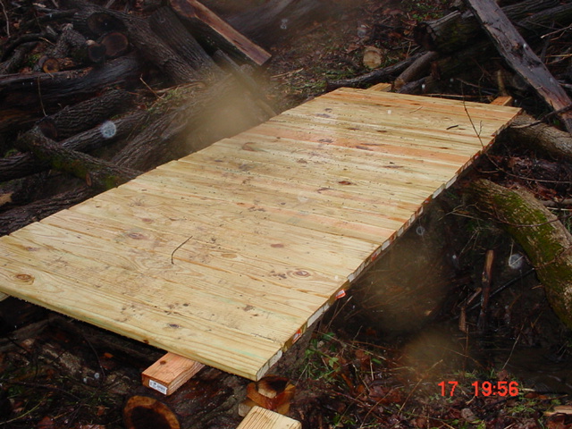

I am missing where the boardwalk in the last picture is going. At first I thought it was a pallet and I thought it was an extension of the pallet thread. But it appears to be a boardwalk and it heads to the tree with the hog wire on it. So I guess I answered my question.

That "boardwalk" is a footbridge across a creek right next to a small waterfall. I want to keep the tree since it provides shade in this wonderfully picturesque spot. And I have to get the dang fence out of there so folks aren't tripping over it or stepping on it and getting tetanus.
Nice. And it looks like you have some firewood too? Given the creek and the lay of your land and the wood, getting that fence wire out may be a little more than you bargained for, but it can be done.

Thanks for all the suggestions. This tree is at the bottom of a ravine, which precludes taking the tractor to it.
I got most of the fence removed. I used the come along and the fence pliers to cut it. Took a total of approx 3 hours. Once I got the section that was wrapped around the tree removed I found out the rest of the fence was laid out flat and buried about 6 inches. It just kept coming and coming. Next step is take my metal detector down there and find the pieces that are left.
I am somewhat perplexed by this. The tree had grown around the fence in a dozen places. I thought that the loggers had wrapped it around the tree about 8 months ago, but it looks like it's been there for years. So now I have to find out what they did with the fence that they removed. This whole section (maybe 20 acres) is pretty rough and I have not been over every square foot yet. Maybe another surprise in store.
