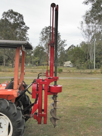

With your post all cut to the same length it comes down to having a consistent post hole depth:
- we use a depth markings on the auger drive shaft & limit the hydraulic cylinder travel our pcitured rig (same principles apply with a standard 3pl PTO PHD or Hyd Auger unit ).
- As an alternative & as much speedier method of fencing, where ever practical our preference is to use a post driver - again limiting the driver hammer stroke to the desired depth for consistent post height.
- If the post holes are already in the ground & you're trying to correct/eliminate a height variance prior to setting the posts, clear any loose dirt pile from around the post hole, measure the hole depth to the undisturbed/original ground & set/adjust the depth so it's consistent in all holes.
- Or as BCP advises lop the posts to even up ......though the wire runs need be spot on & the post needs enough "surplus" for this to work.
Personally, there's something that drives me crazy about fencing which is neither straight nor level - I'd much rather take a little longer & adjust to get it right than live with consequences of a "near enough" job for years (our farmhands I sure will endorse how pedantic I am on this task)
