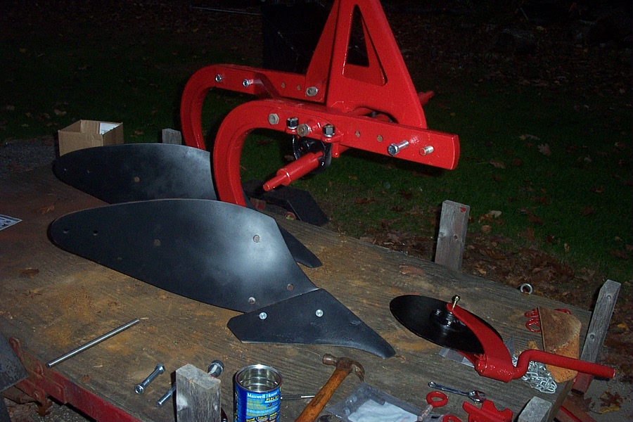

Good Evenin Guys,
I finally hung the rest of the parts on the plow tonite ! ;) Other than a few washers and lock washers its about done. Its getting cold out there, even in Ct its in the 30's so I imagine much colder in Vt. Im hoping to get the plow up there in about 1 1/2 weeks, and at least try to run a furrow if its not crazy cold. Im sure this thing wont work well in frozen ground ! ;)
I have taken a few pics of it tonite, and have a question for our resident plowing experts. When I hook this thing up to the 3 pt hitch is the drawbar going to stay at that angle, as it is in the pictures ? Also I dont see what is going to keep those coulters from wondering around or do they just track fairly straight ? I guess its time to reread " Plowing New Ground " :)
Anyway I hope I can get it dirty this year but we are really cuttin it close !

/ Ferguson Plow... Opinions #104
The coulters'll track straight when she's in the ground, but you may need some help keeping them in line while the plow is raised. Not only can the front one find the tire, it can end up swinging over enough to catch the fixed drawbar. You may need "limiter" chains. They were common on a lot of the older plows. Many newer (read 60's/70's ect) plows had coulters with a limited swing.
I have to do my homework on that style of drawbar. One side or the other SHOULD move forward or rearward to make the plow track correctly. That'll control the width of cut for the front bottom.
You really do need to start searching ebay for an owners manual for that exact model of plow. The folks who built it can explain little details better than I can ever hope to.

Scott, it appears that you have the adjuster on the drawbar rotated all the way down..I believe it should be somewhat level. If I remember correctly, there are marks on that rotating "sleave". I'd loosen the u-bolts on both sides and get the drawbar somewhat level to start. You will then have to adjust it laterally (front or back to bring the plow towards the previous furrow or away from it). Your first furrow will need to be done with the plow bottoms level to the ground. Once you have a complete first furrow, you will need to put the right side tires into the furrow with the plow up--(this will make the plow look lopsided--off level, now adjust your 3 point lower arms so the plow is level with the ground while you sit in the furrow...So when you lower the plow it will again run level in the ground. You following???
I note that your furrow wheel appears to be set back away from your landslide. Have you not put any grease in it?? If you had, it would be sticking out toward the furrow wall. You want that wheel to sit flush with the furrow wall that the rear plow share has cut. Hope you get the jist of what I'm trying to say...another pic from directly behind the plow would be helpfull. BobG in VA
