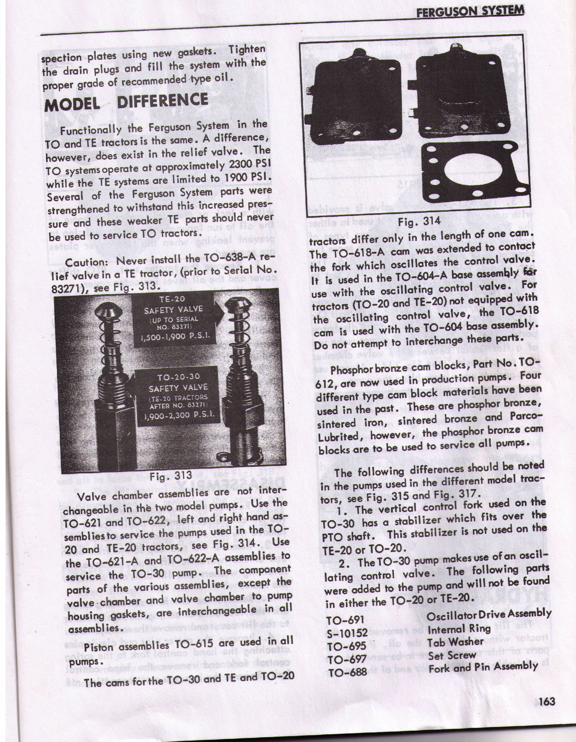

Hmm.. I don't have ma manual with me.. post what the description is for the 12/13.. i know one is just a retaining ring..

12 ......181 162 M91 ........Drive Assembly, Valve
13 .......195 788 M1 .........Ring, Snap, Drive Retaining
   / Ferguson TO-20,30 Hydraulics #24
I'm guessing that part is likely to stay in the pump.. I don't see it seperately in any for sale lists.. etc.
is your part like that damaged?

post 19 is a pic of the assembly out of our pump. The rod is somewhat bent and distorted. but seems to slide in the pump freely, so it might be ok.

The part is attached to the control valve held in place by the snap ring, so it comes out with the valve.

Here is a page from the manual, might shed some light on it

My point was that it is removeable.. IE the snap ring.. I only see the outter parts for sale.. not the inner parts.
