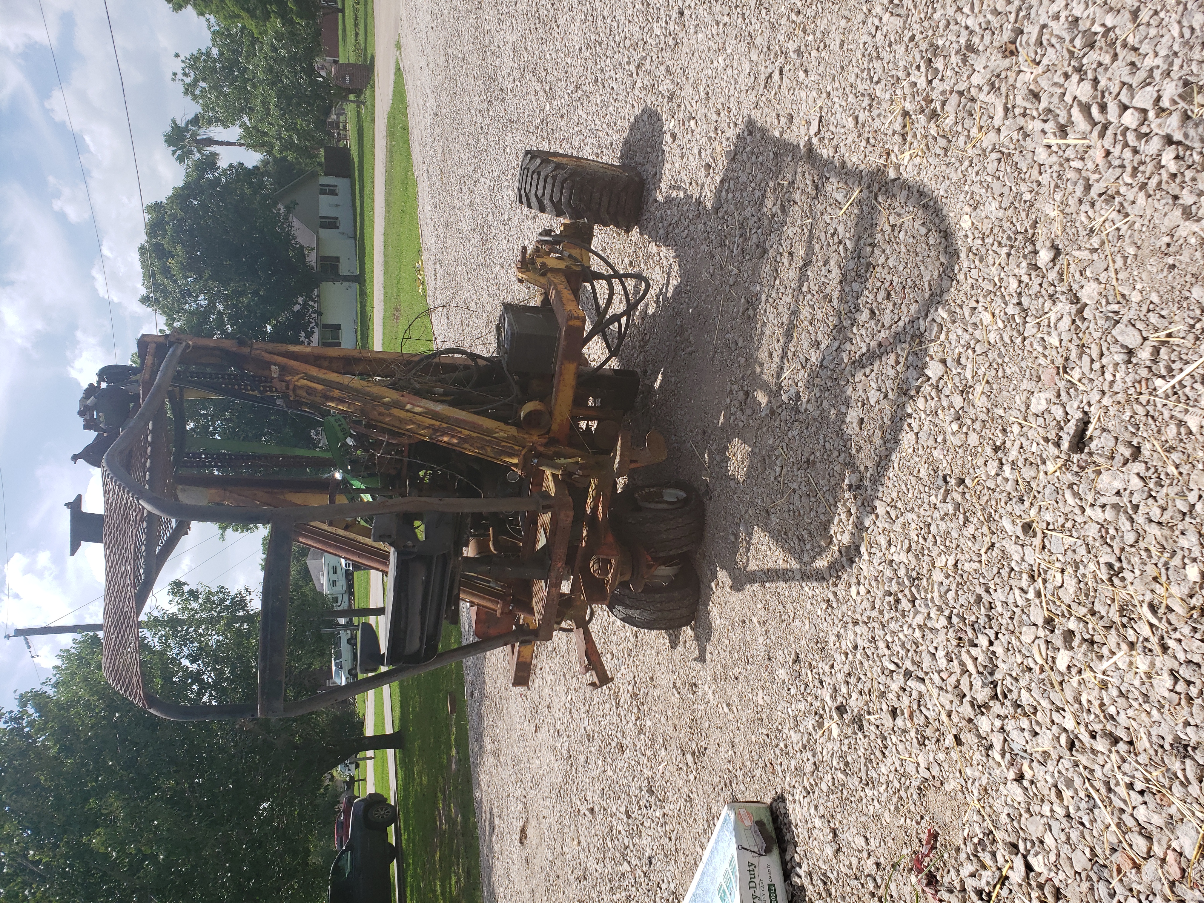

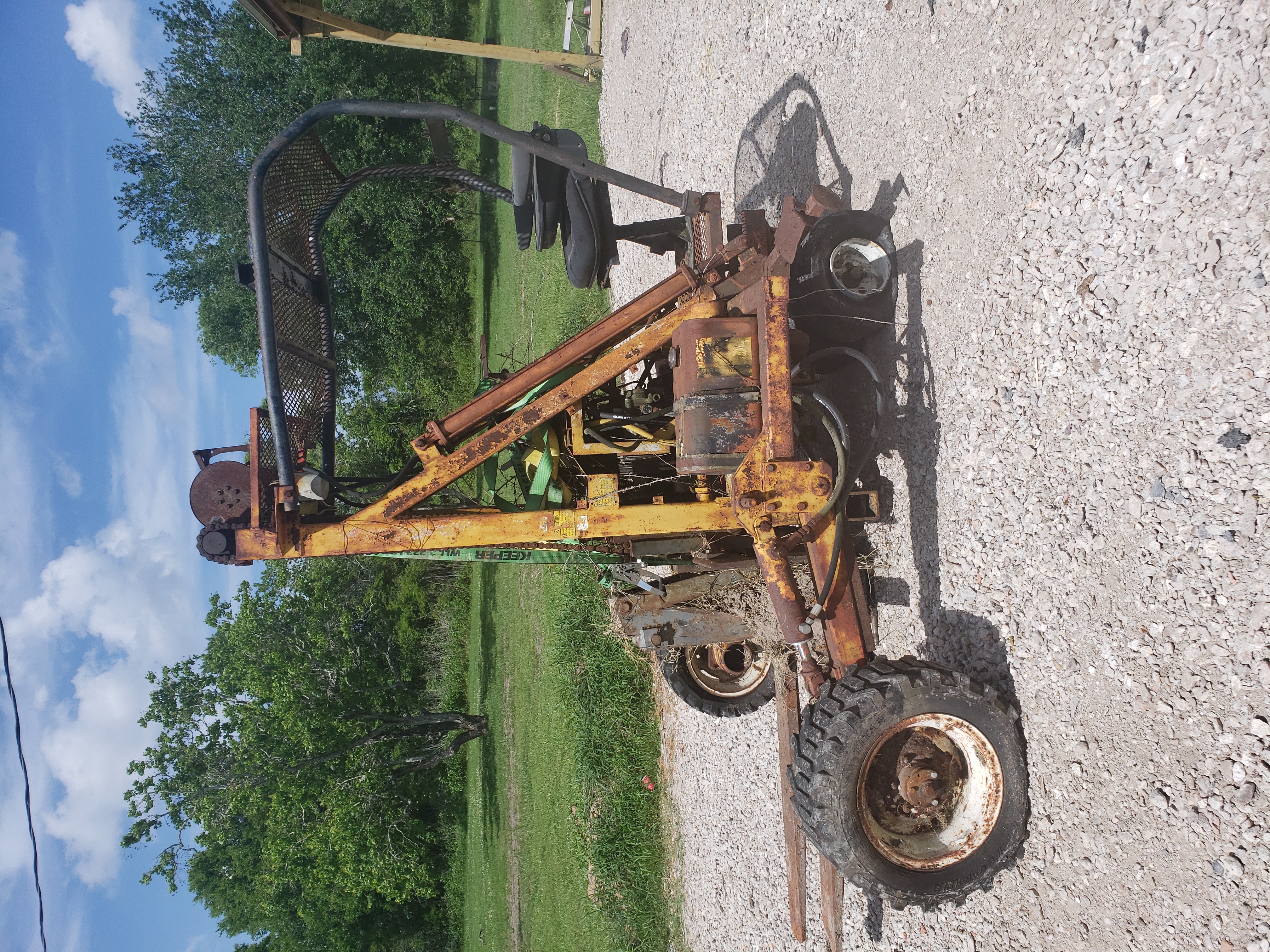

I've been driving past this derelict machine in a pasture off the side of the road every day since I moved here 3 years ago. It wasn't until I drove past it on the tractor going a whopping 16mph that I had time to notice the sun-bleached For Sale sign on it. I stopped to look, and immediately wrote it off as a piece of scrap that a few potentially useful hydraulic cylinders on it. Particularly the cylinders on the wheel arms, which would make a nice hydraulic top link, and a pump which I assumed would make a good PTO pump. I enquired with the owner, an old lady, who said it has been parked there nearly a decade and I was the first person in years to Express any interest in it. I told her it had a few parts on it that I was willing to give $200 for and she said she wasn't interested in having it torn apart on-site and that if I wanted anything off of it, I would have to take the whole machine. But she said I could have the whole thing for $200 because she just wanted it gone. OK I said. But the ground was too wet to do anything.
That was a few weeks ago. I just went and got it yesterday. I might be fatally naive, but during the long and arduous process of loading it (wheels wouldn't turn and mast was frozen all the way down against the ground), and upon inspection back at my place, I begin to see some restoration potential in it. It looks like crap. Not a single square inch of it is rust-free. But it's mostly surface rust, and everything that matters, shows hope. It was parked with all the cylinders 90%-100% retracted, and those rod ends which were exposed, aren't bad off; they're chrome plated. As I look at it, I get the impression it wasn't that old when parked. I can't find any data plate to see the year of MFG or the brand or model or capacity or anything, but it's got a big Kohler engine that looks just like the ones they still sell.
At a minimum it will need all new tires, hoses, paint, gas tank & carb cleanout. Not sure what else to expect. Not sure if it's worth the effort. What say you?
I can't find any information on the company. As I said I don't know the model number or anything. I only know it's a "Spyder" brand from Google image searches. I can't find any company website for Spyder. Any info on the company or the machine is appreciated.

No harm in bodging things up with a hanging fuel jug and loaner battery to see if it will run, then take it from there. Definitely worth $200 for toy potential. What is that box between the forks that looks like it has hydraulic hoses going into it?
   / "Field find" SPYDER rough terrain forklift. Looking for info on it.
I don't want to try turning it on until I verify the hydraulic system free of water. If it has water in parts of the system, i would rather it stay contained where it is than being pumped into all the components.... But i suppose i could just uncouple the pumps first. That's what a smart man would do i think. ... ok, with your help I've talked myself into it.
The box between the forks is an ant hill. It has scissor-type extending forks and the ants over the years apparently transported probably 50lbs of dirt up from the earth and into the machine.

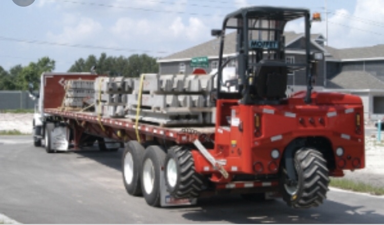

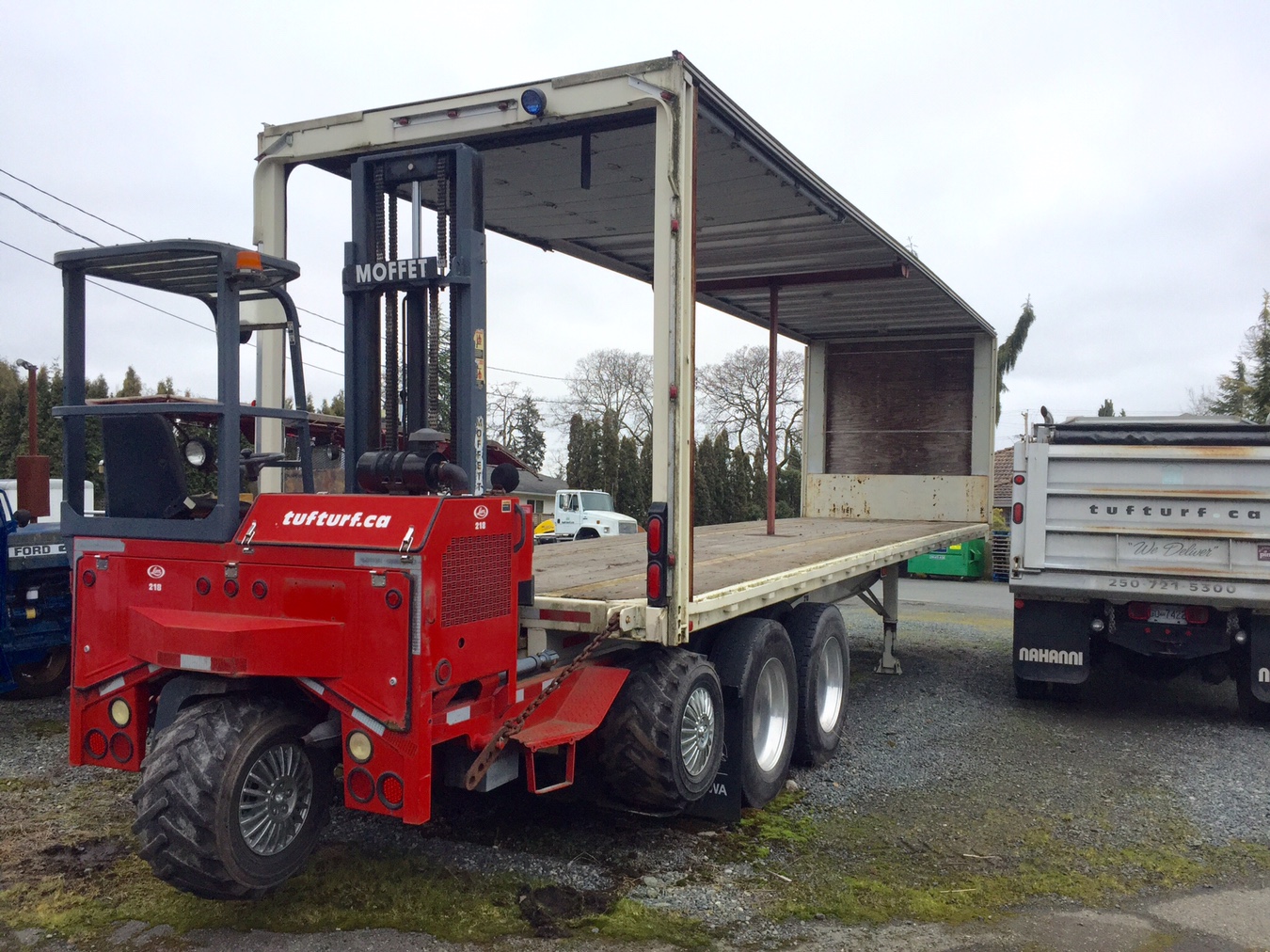

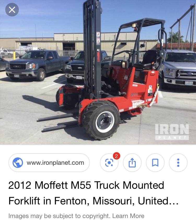

This is my guess......

Thanks. I'll contact those folks and see if they can tell me anything about it. I poked around their website and found some familiar looking images.
mlpweb
Compared to a brand new one, mine appears to be missing the panel with all the gauges and hour meter. Or maybe that's a new feature. It seems odd that there's no hour meter on mine. I figure there had to be one at some point.
   / "Field find" SPYDER rough terrain forklift. Looking for info on it. #8
Your Spyder is a piggy back or truck mount forklift. The mast has double hydraulics to push DOWN to lift the unit up.
I used to have one. I will try to find better pics tonight and provide a little more info.
I’m quite certain you won’t find a website as they didn’t exist back then.
