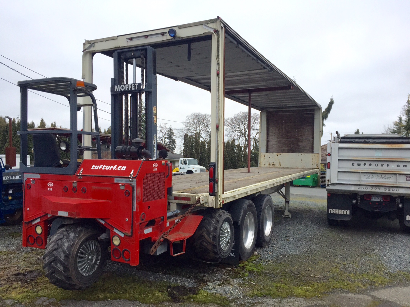

That's a different brand but same concept. That one is nicer than a spyder.
I purchased my Spyder new in 1990. When I sold it 14 years later it had the dubious reputation of being perhaps the only known machine in existence that hadn’t been rolled.
We have two Moffets and a far superior Kesmac now.

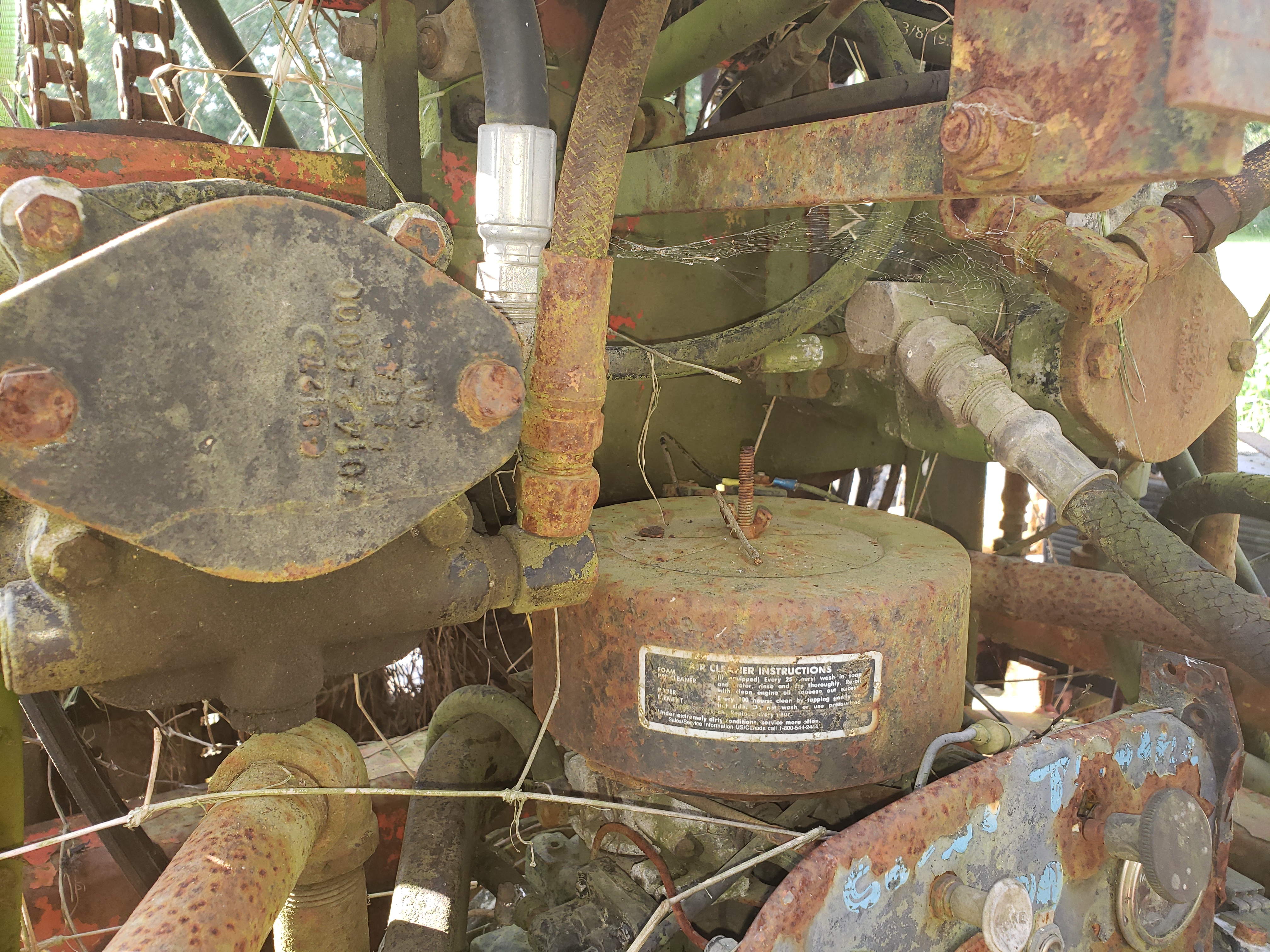

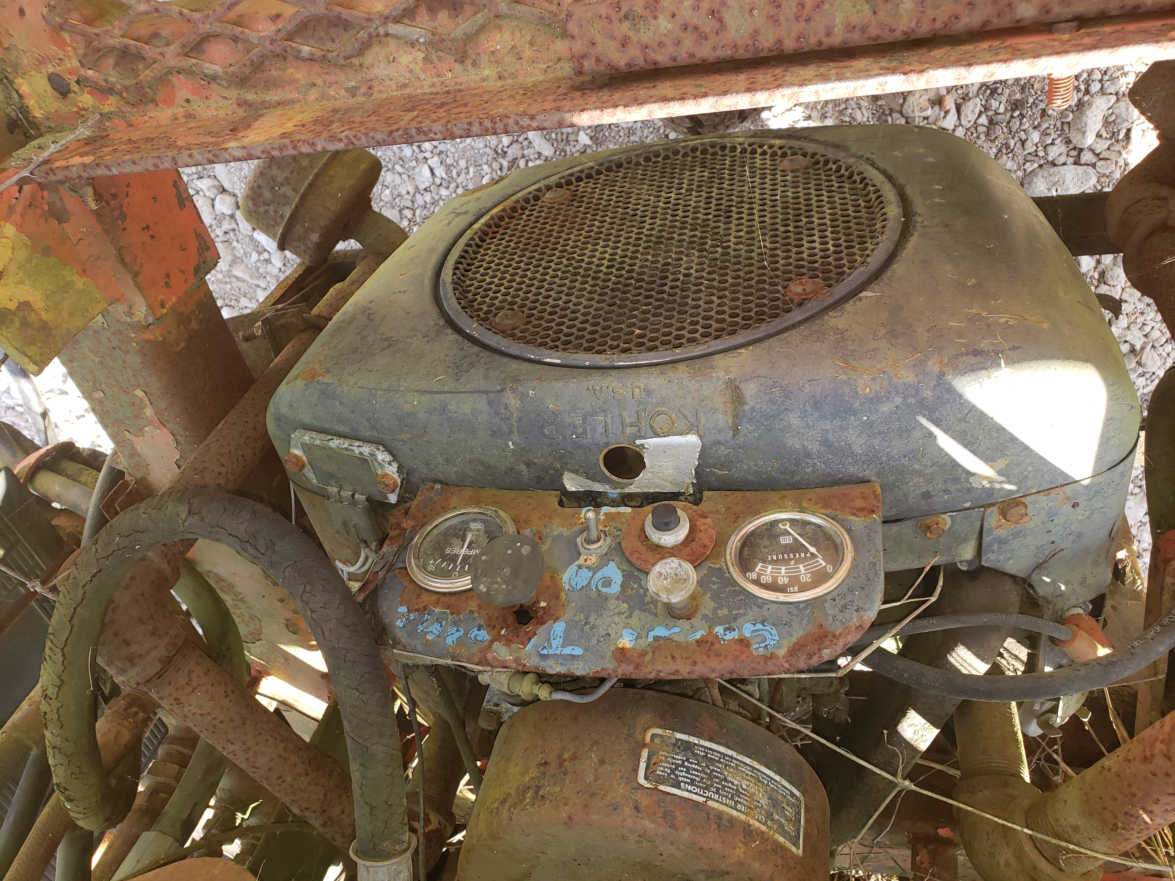

Ok motor/pumps:
It has (2) Eaton 70142-6000 variable displacement sawshplate/piston pumps (very exciting!) For the two wheels and (1) pump with no identifying marks appears to be a fixed displacement gear pump that powers the valve block for all the cylinders. I can't find any markings on the engine other than "Kohler USA" but it's pretty darned big for a horizontal shaft small engine and from the specs posted on the newer units earlier in this thread, I estimate it's somewhere between 30 and 50hp. Would be a perfect donor for that adult-sized go cart I've been dreaming of building for the past 15 years.

Those two Eatons are belt driven?
Is there a clutch on the motor or the Eatons to disengage the pumps when starting?
Yes, belt driven. There is some kind of screw-in pulley/ belt tightening adjustment knob accessible from the operators chair, the details of which are currently obscured by thorny vines. It appears that the 3rd pump (gear pump) slides up and down. I'll clear it out tomorrow and see what that's all about. I had wondered about that, if that's supposed to be used during normal operation (hence accessibility) or if it's just to set the belt tension. What do you think? Your question implies there should be some sort of clutch? Maybe this is it. But if it is, that seems a little weird.
