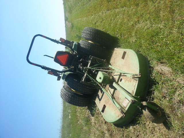

Well I was talking from a traction viewpoint. As far as stability goes this is how I do it. I wish I know how to fix the picture but I don't so you'll just have to imagine that the roll bar is up.

I can’t imagine bush hogging what I bush hog with that much rubber pushing everything down. Love my loaded tires with 2 sets of wheel weights and I bush hog some hilly stuff.

I can稚 imagine bush hogging what I bush hog with that much rubber pushing everything down. Love my loaded tires with 2 sets of wheel weights and I bush hog some hilly stuff.
I usually mow back and forth and one set of duals is already on the mowed grass so there is really only 14" of extra grass being compacted down. When I come back the action of the mower lifts up the compacted grass and I actually get quite a nice cut.
I've mowed irrigation ditches where I ran out of room because of a fence and was situated so steep that I had to lift the mower a bit to get the rear tires to come back down onto the grass enough to move forward. I can't imagine that loaded tires would be preferable in a situation like that.
