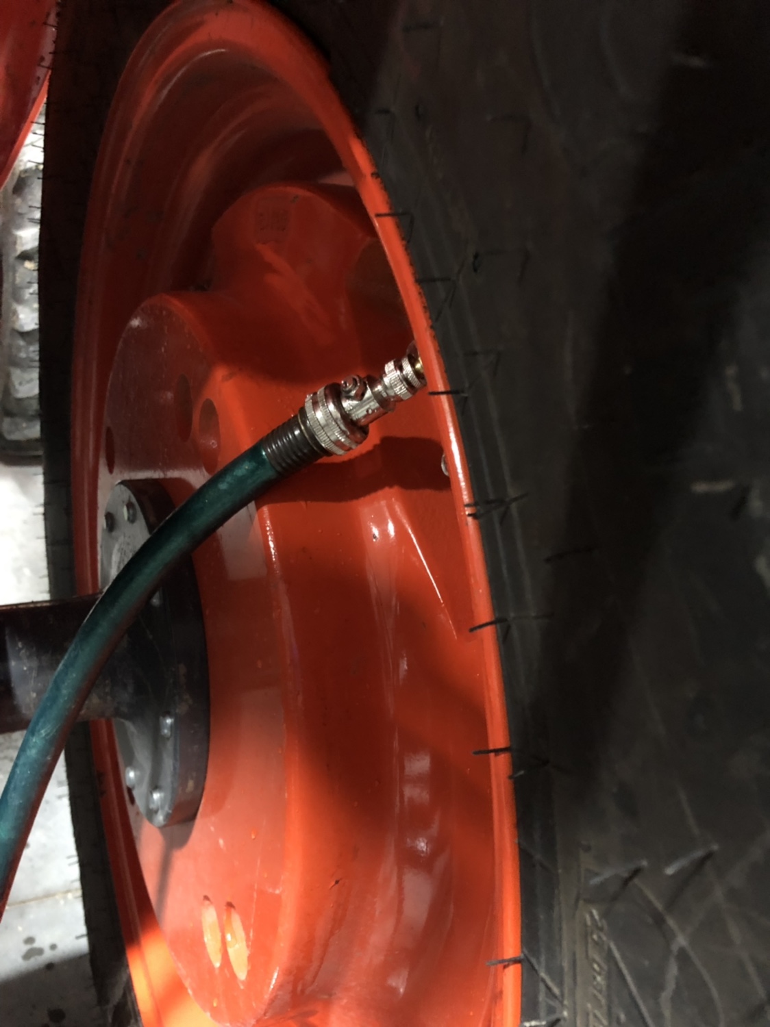

I took the gawdy Tall R1’s off today,
Fluid Filled all Four New R4 take offs & installed them on my 5085E :D
It’s so much lower geared, useable & takes gear smoother now for my applications.
   / Filled tires, tubes or not? #37
220gals x 8lbs = 1,760lbs Heavier with all 4 Fluid Filled Tubeless :D
No more bouncing, more stable & better traction.

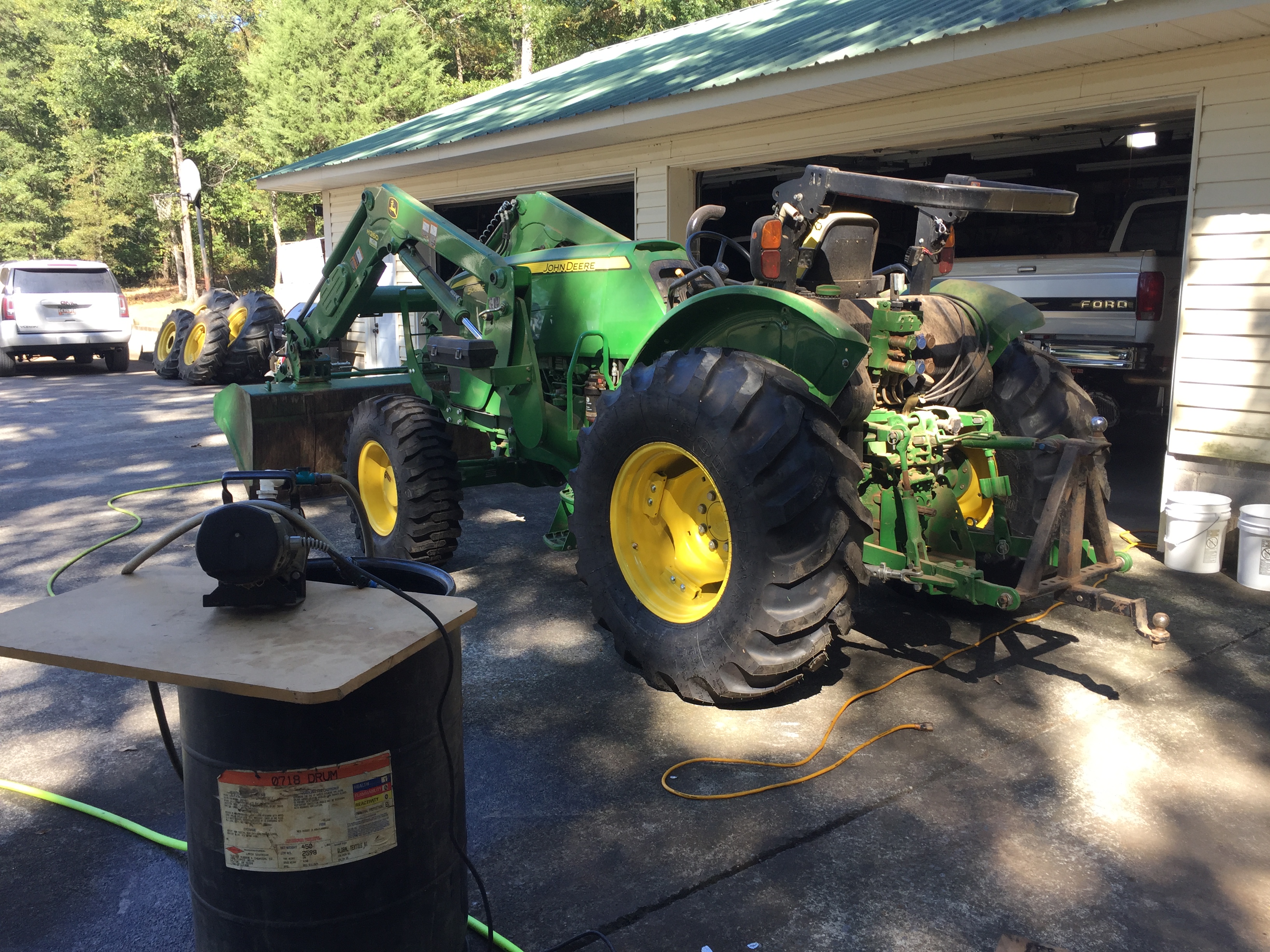

Filling mine up tonight! I just decided to use water. I may add some sort of rust inhibitor later if I decide too. My tractor is never going to be left outside in freezing weather, and it will be stored in a heated shop so I’m not worried about it freezing.
   / Filled tires, tubes or not? #39
Do you have the weight of tractor off the tires ?
You’ll love the difference with the extra weight in the tires & NOT on the tractor.
   / Filled tires, tubes or not? #40
I don’t! I should have weighed it before and after but I just haven’t had a chance too!
