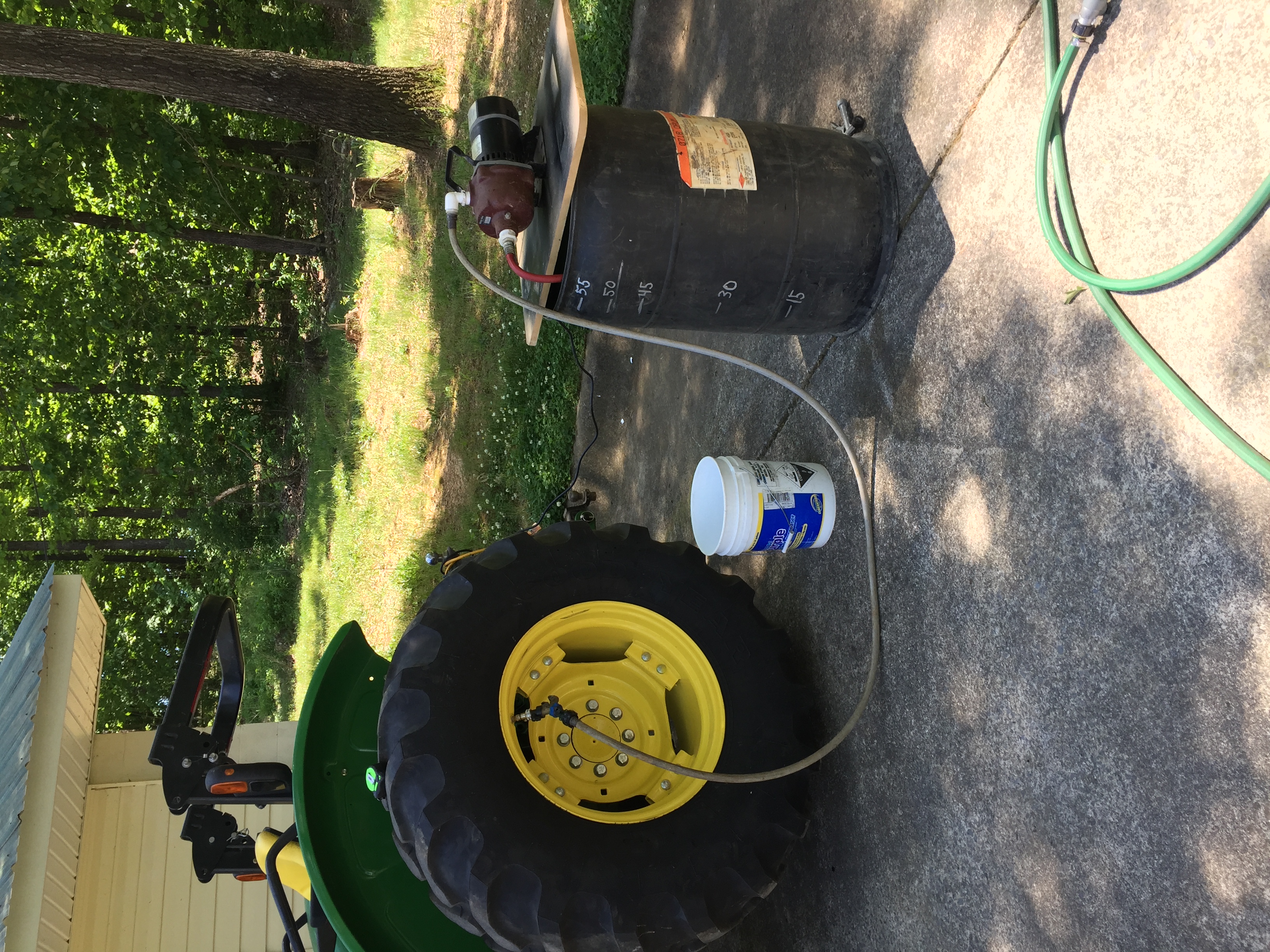

That’s an extremely slow method.
I plumbed me up a 120v water pump that sucks out of a 55gal barrel so I know exactly how many gals I’m pumping in : 80gals in each rear & 30gals in each front. All Tubeless with 25% AntiFreeze mix.
I have an inline Tee with a cutoff to bleed air out of tire with the pump turned off
   / Filled tires, tubes or not? #48

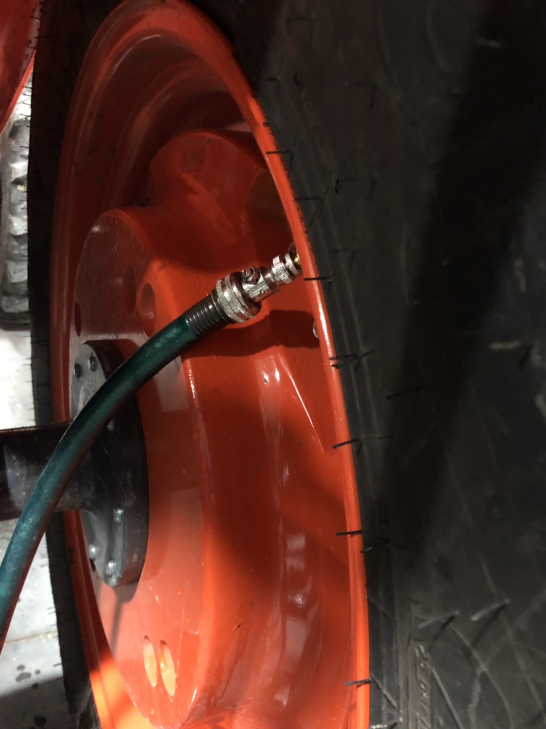

If you have a 12V sprayer, you can rig up something similar. The 12V pump maybe a little slower than a 120V pump. Those YouTube videos called "Dave knows how" or some such has a video on exactly how to plumb up like Brown Dog did.
   / Filled tires, tubes or not? #49
Does that fitting vent the air out while filling or did you have to disconnect it and periodically bleed the air off?
You have to shut it off every so often and vent it.
