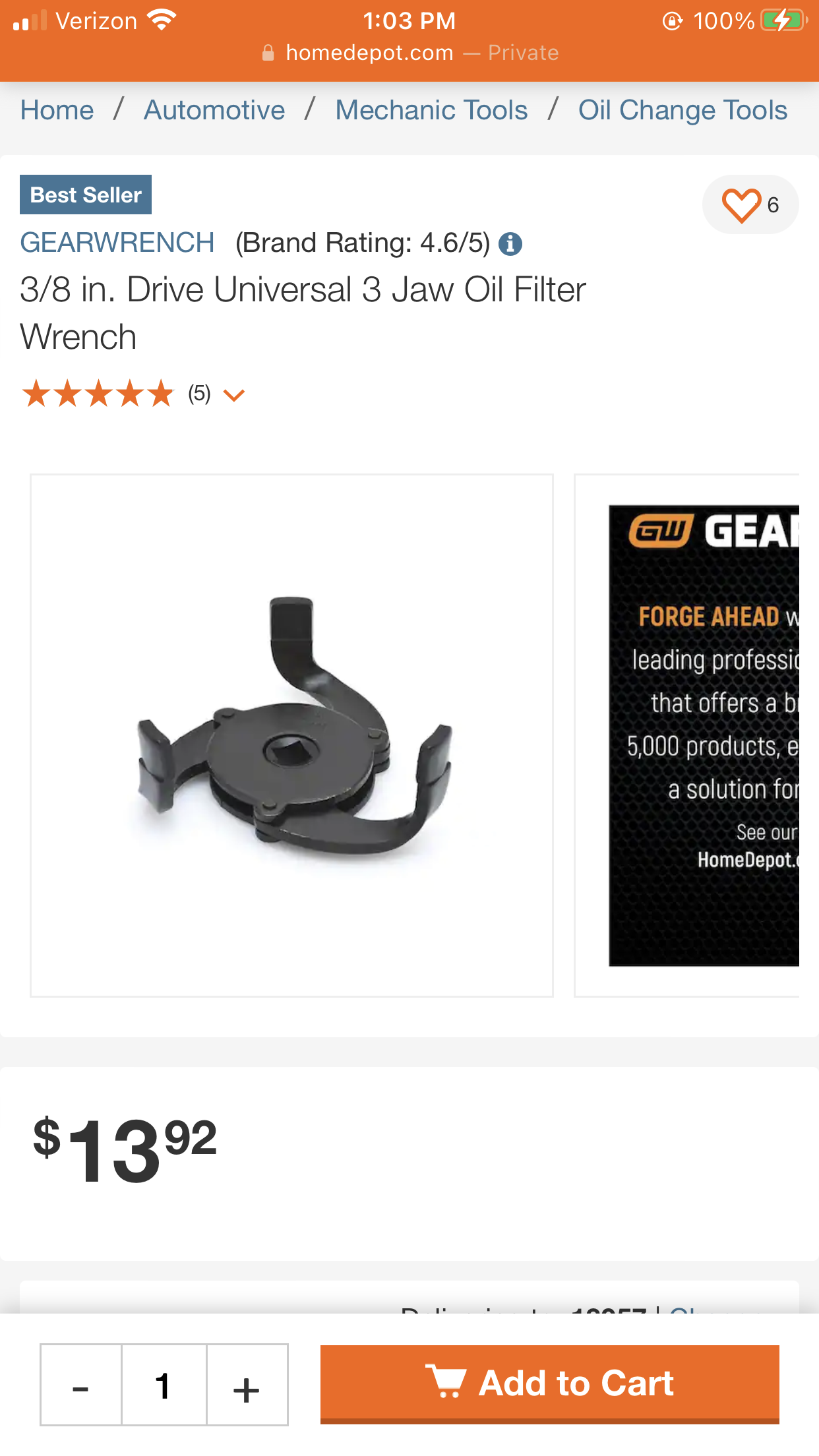

I use this style (one i have is a little different).
I can set it in place (grip the filter) in tight spots with my fingers, and then put the socket wrench in to loosen it.
I remember when these things came out in the late eighties and early nineties. They look cool, but don't work well. Use a chain wrench.
/ Filter wrenches. #28
Problem though is that there might not be enough room around the filter to use that chain wrench. That’s what I interpreted the OP’s issue to be (in part). That’s why the style I showed/used is so great - can fit into a tight space, then use a socket wrench with an extension to loosen it.
/ Filter wrenches. #29
Two sizes of metal strap wrench, 3 jaw ratchet wrench works great for ATV and outboards with smaller filters with no clearance, plews channel lock style for tougher or larger filters. Also works great on RV septic connections and keeps your hands cleaner.

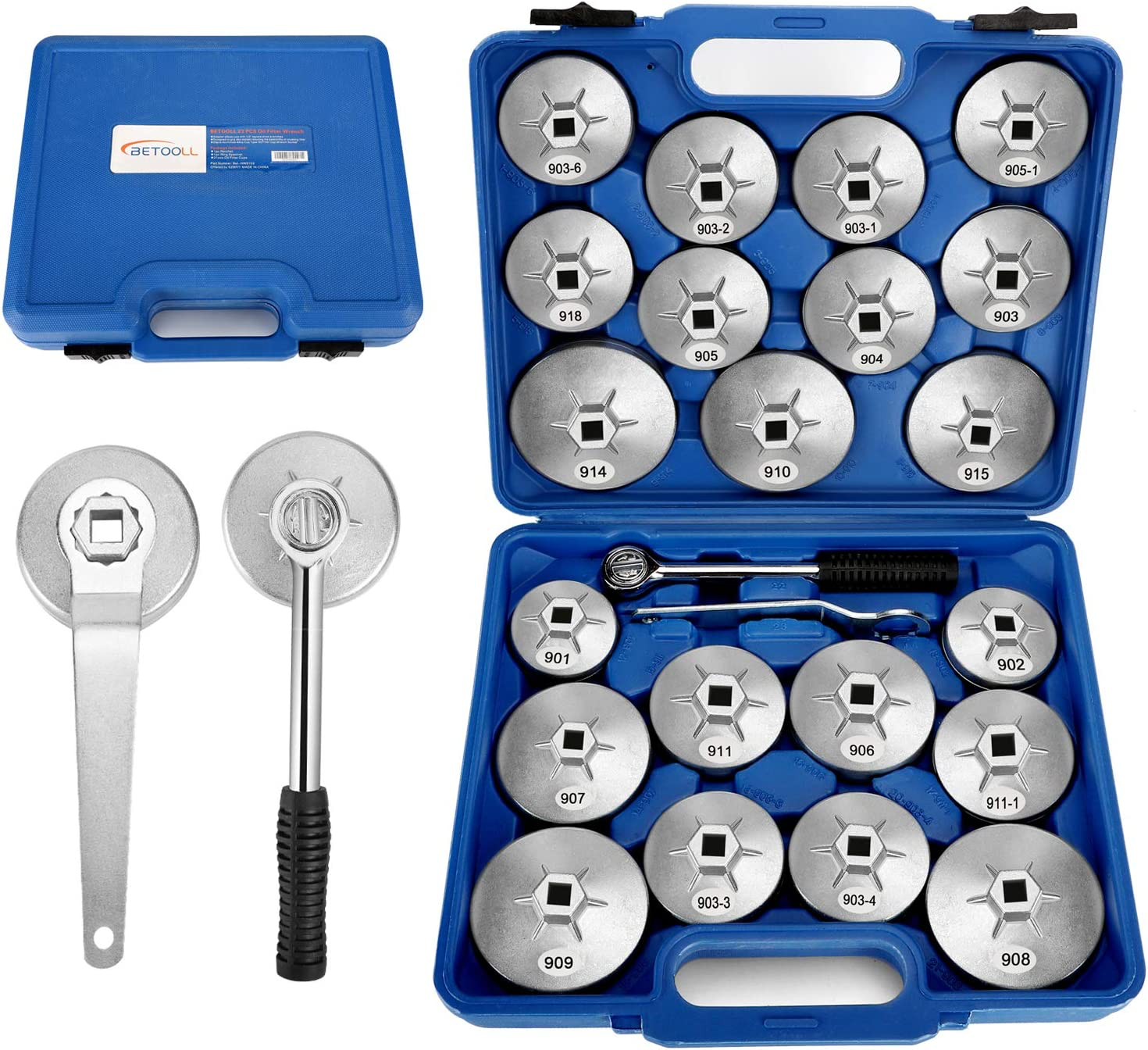

I too own a extremely large variety of filter wrenches. I think one of the reasons they make so many different kinds is because there is always a filter installation where the ones you have (no matter how many that is) won't work.
/ Filter wrenches. #32
I bought one of those for my 5.9 Cummins truck motor because there’s no room to turn a lever type handle due to the way the filter is positioned. I had no luck with it. It kept slipping so I returned it. I bought a cup type wrench that I can attach a ratchet and extension to. It works great, but it takes some searching to find the correct pattern and size cup wrench for your filter.

/ Filter wrenches. #35
It's a darn racquet between hard to reach unspinnable oil filters and filter wrench manufacturers. Lol why can't they just put a six point nut on end like some do? I look forward to the day when I can clean this drawer out and use a socket with ratchet with all filters.
/ Filter wrenches. #36
OMG cheap chinesium products at amazon break???
I find the metal cups grip better than the plastic ones that tend to deform.
The original ones were made by OTC and they sucked back then too. The tool just slips.
Insofar as filter wrenches go, the only cool thing I've seen happen in the last 30 years is adding a grip surface to the filter wrench, like Lisle is doing (a chain wrench is still the right tool for painted on filters).
