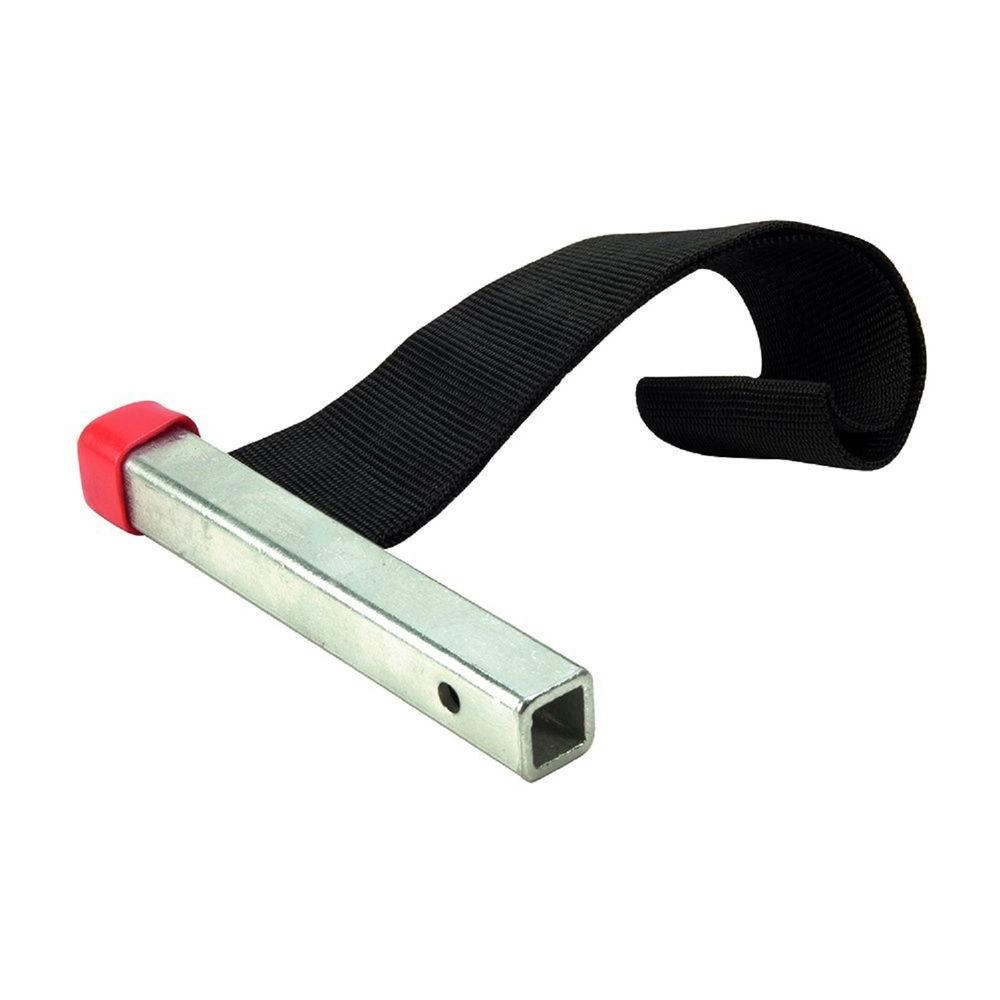

I have about five of those band-style in a set from 2-5". They are great, IF YOU HAVE ROOM ON THE SIDE. I use a strap wrench when there isn't. I also have a number of the socket style in steel, but you have to bring an arm full to find the right size. If it looks like there isn't side room, I go straight to the strap wrench. It's 1/2 drive and I usually take the breaker bar with it. That will crush tight filters too, but I've gotten them off. In all my years, I think I resorted to the screwdriver method maybe twice. And as I recall, they were both GMs.

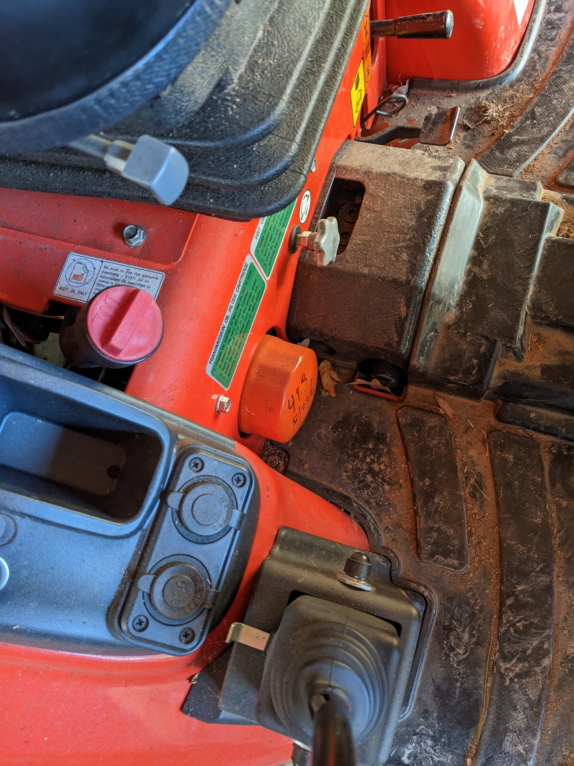

This filter on my CX2510 was a *******. It's kind of tucked in to a corner. The socket style I had wasn't deep enough and kept slipping off. The 15 inch pliers I mentioned before ended up getting it off.
What a horrible location, accessible to damage ur heel hitting it and bad spot to remove, that's crazy what we're they thinking

I have used this one: Filter Wrench
I have used every strap wrench, every object calling themselves a filter wrench, and even a homemade wrench called a screwdriver-through-filter wrench. But those channel lock style wrenches work the absolute best!
Absolutely agree with this.
There's self-adjusting versions as well which is what I use. I like this particular one because they open up wide enough for the gigantic spin on filters on my medium duty truck
