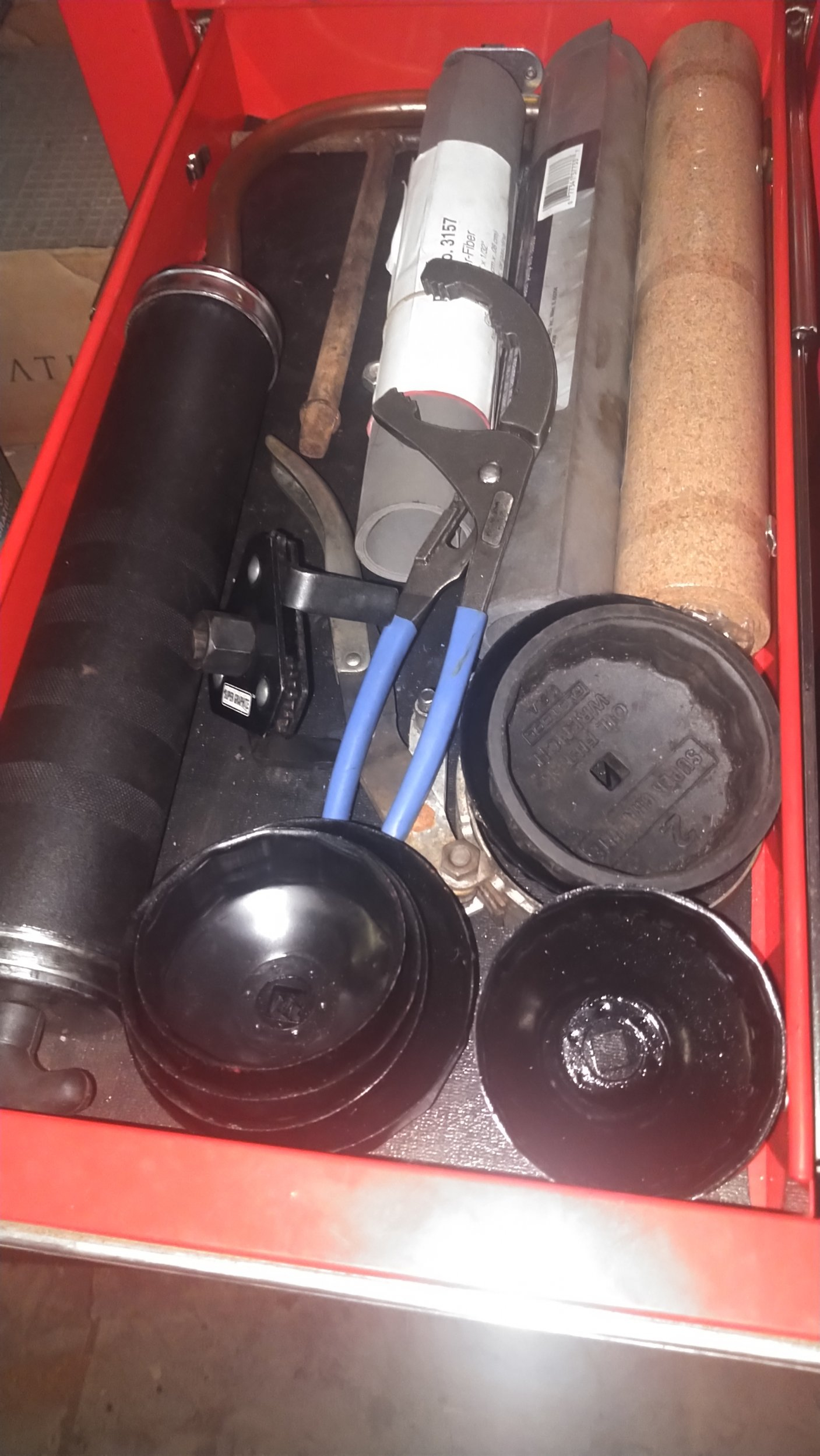

A lot of these hard to reach filter locations could easily be remedied if filter manufacturers would get together and start putting hex nuts on end of filters Imho.
Is that why K & N filters cost so much?
/ Filter wrenches. #62
Not completely sure on filtering capabilities on k&N filters compared to OEM however I usually change filters at least annually, To me anyway it's worth the extra cost to ease my four letter word removal frustration and messes I've made. and is usually same price or cheaper than OEM. I have also noticed more aftermarket filter manufacturers have started putting hex nuts on end of filters.

In my opinion and experience as I'm sure most experienced folks know installing oil filters running a little bit of oil on the o-ring not only aids in helping seal it better on base but I feel it helps taking it off with conventional oil filter wrenches, that and not over torquing it of course helps in my shade tree mechanic experiences
/ Filter wrenches. #68
I'll say it again I have never stripped a nut off the end of an oil filter. Maybe I'm lucky or just don't use a breaker bar to install them, lol

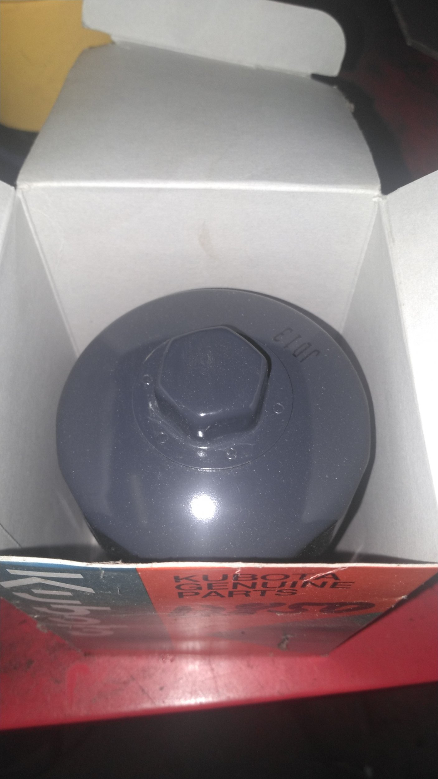

Nope I disagree. If you READ the instructions with these filters it clearly recommends NOT to use the nut when installing the filter. But everyone does anyways. So now that filter is too tight and upon removal the nut breaks off or is rounded. So unless the nut is ONLY used for removal….it’s fine 😉
/ Filter wrenches. #79
Imo I think a lot of folks don't clean the base off so if there's some slight seepage or even leaking caused by debris on the filters base so they torque it down way to much. In fact I remedied my folks car when they visited it was leaking oil all over my driveway not only was it way over torqued but the oil change place left the o-ring from the old filter on the base.
/ Filter wrenches. #80
I’m talking about a filter with a nut welded on to it. Has nothing to do with dirty seating or not making sure that the old gasket has been removed. However those issues are certainly not good…😬
