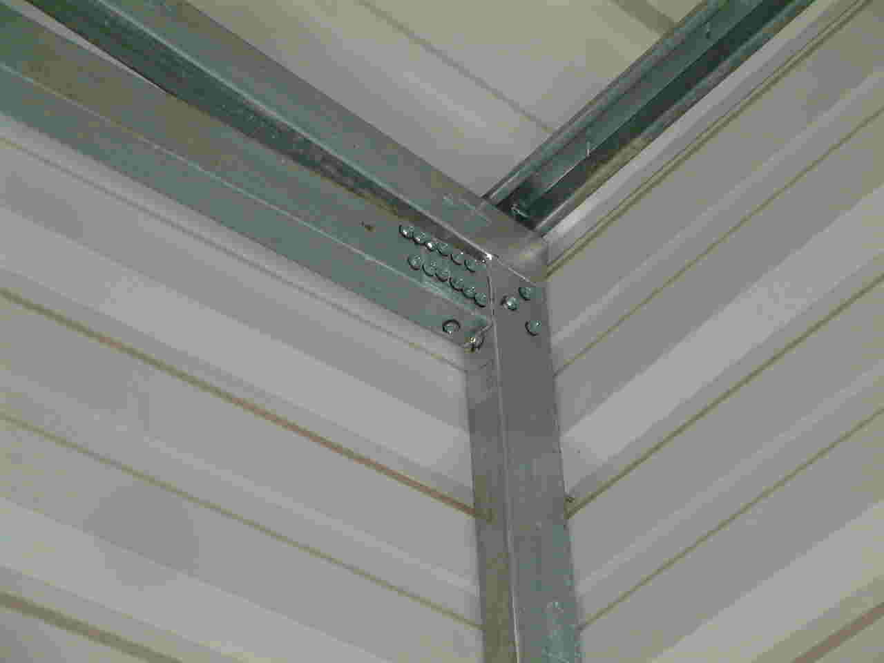

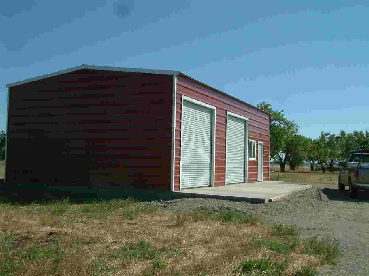

Here are a few photos of my shop/garage.
Image 1

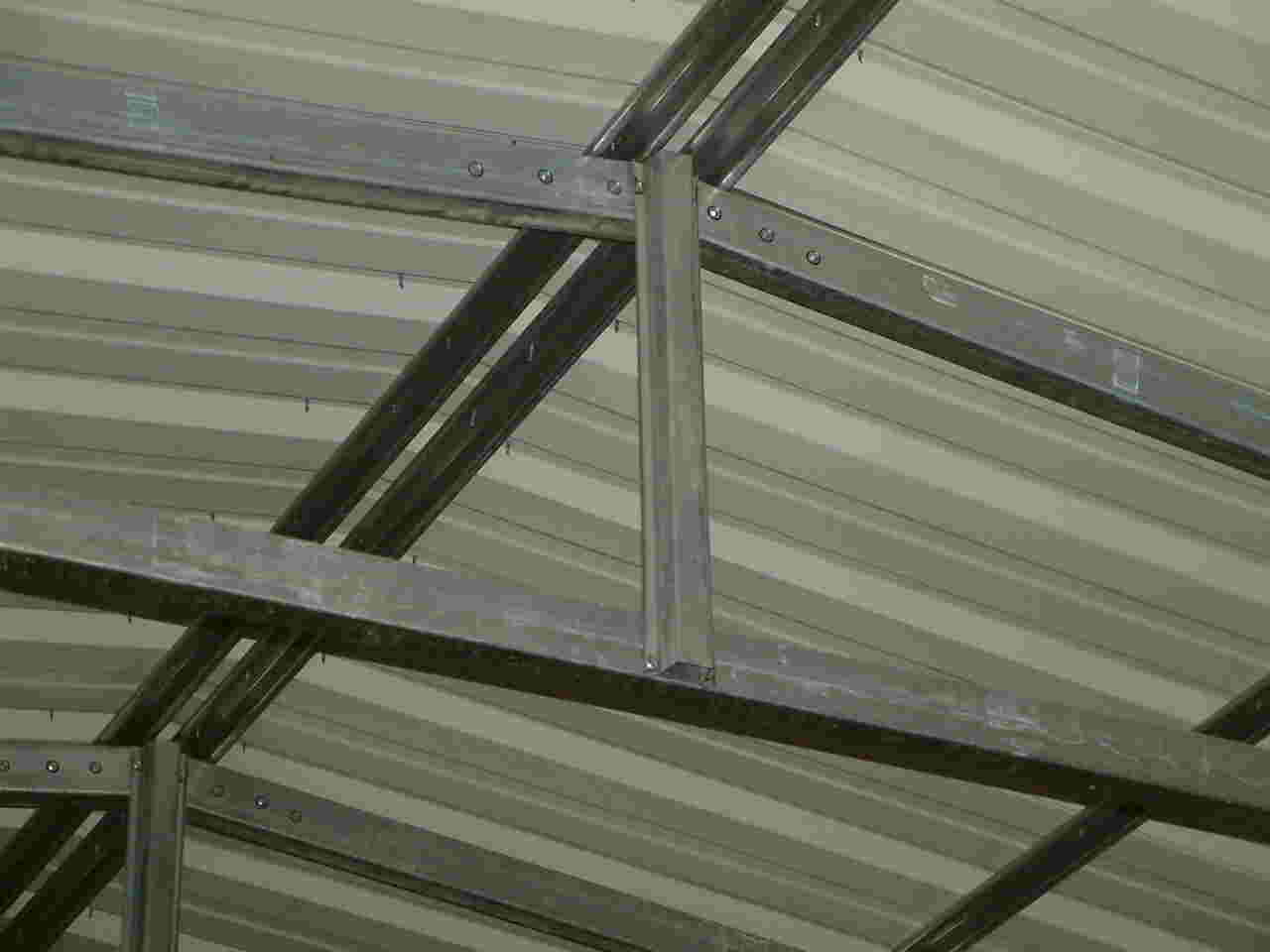

   / Finally, a barn built with our new connectors #55
Image 2

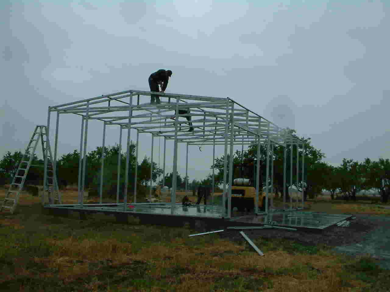

   / Finally, a barn built with our new connectors #56
Image 3

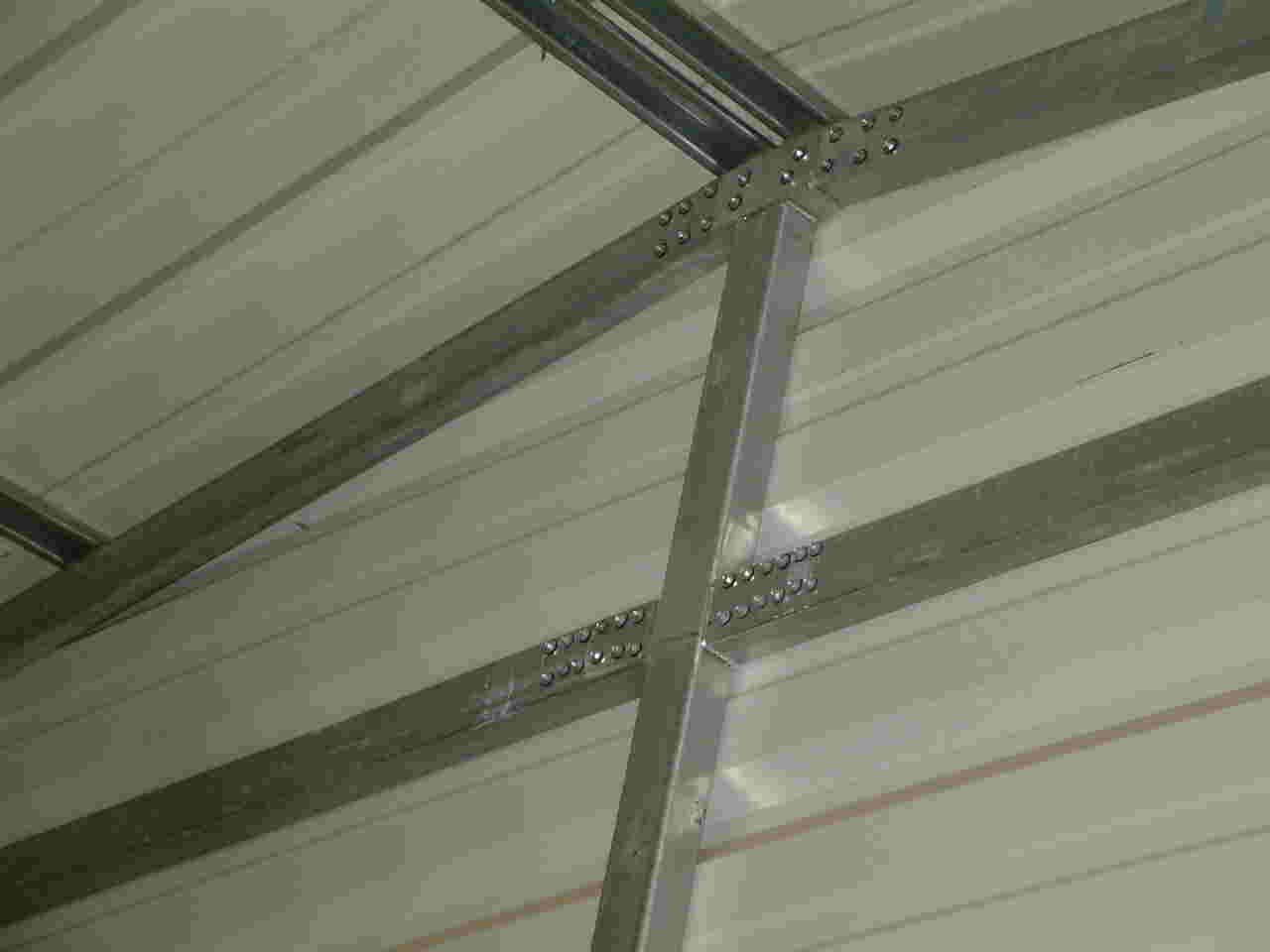

   / Finally, a barn built with our new connectors #57
Image 4

That's a nice looking barn you have there.
At first all the screws at the joints confused me. But then as I studied the layout and construction I think I understand their reasoning.
Correct me if I'm wrong but I believe the bulk of your framework is sixteen to eighteen gauge. That would explain the need for all the screws.
I would really appreciate any information you have on the gauges of the different components.
As we're finishing up the original barn I'll post pictures of it so you can compare techniques for us. I'd appreciate your comments and critiques.
   / Finally, a barn built with our new connectors #60
Here goes:
The frame is 2x3 inch Allied Flo-Coat rectangular tubing, 14 ga.
The siding is 26 ga Reyerson Hi-Rib 4. No purlins needed for the side walls since the siding corrugations provide the stiffness.
The hat channel (for roof purlins) is 1-1/2" 18 ga McElroy "Mac-Girt".
Fasteners are #12 and #14 self-tapping screws, 1" long.
The roof pitch is 1.5:12.
The structure is designed for 75 mph wind load, exposure B; seismic zone 3.
The roof design live load is 20 psf.
The materials used in this design are pretty standard in the metal structures business. The reason for the multitude of fasteners is to handle the loads imposed on the frame by the design requirements, which may be a lot different in your neck of the woods.
