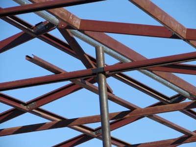

Here's a shot of the roof structure over the lean to.

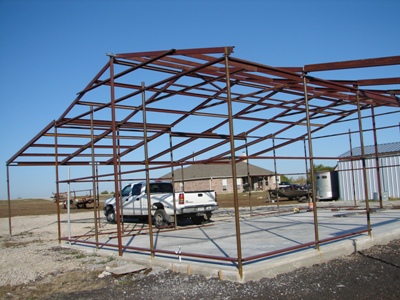

This is a shot of what they-we have gotten done as of this morning.
I got in yesterday evening. Scott left for Colorado Thursday morning, something about a renegade elk that deserved being hunted down and killed like a dirty dawg. /forums/images/graemlins/grin.gif So it'll be a couple more weeks before it's complete.

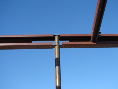

One of the complications this building brought to the table was the overhangs or lean to's. They presented spans I wasn't comfortable with handling with only four inch purlins.
So I designed a beam not unlike a laminated beam you see out of lumber at the lumber yard. Two four inch purlins held in place with the brackets at the posts with a six inch purlin vertically between them.

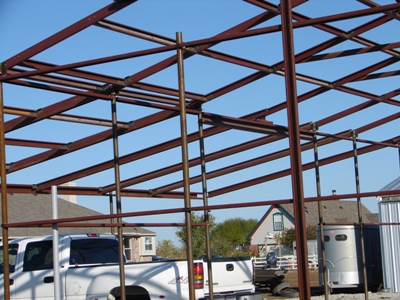

Here's a close up of the south west corner of the west lean to.
The rafters of the lean to were supplemented with three inch purlins to allow the four inch to be used in a vertical position.

We used the same laminated beam idea over the doors to the shop. I don't believe this would have been necessary, we could have just used the strength of the sheets. But we have rafters coming in mid span. So I adjusted accordingly.

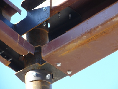

This might help you see how the ridge is constructed. The rafters come up and are connected via brackets attached to a pipe pilot. The purlins are connected to the rafters using the purlin to purlin brackets.
This picture was taken with a telephoto lens. So the vertial wall structure appears to be inside the ridge construction. It's an optical illusion.

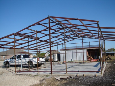

Here it is without the telephoto distortion.
