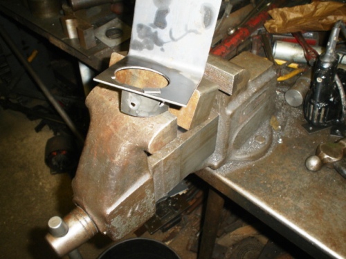

   / Finally, a barn built with our new connectors #32
Harv, the genius of your system lies in its simplicity.
Just one question, given that you are using steel vertical posts and there are different wall thicknesses for steel tube, will you specify a specific wall thickness to be used for the buildings? It strikes me that wind loads could crumple the structure if someone tried to cut corners and use tubing that was thin. It also strikes me that you could just about make a building hurricane proof if thick tubing was used.
#33
Good observation Bob.
In a discussion yesterday we talked about that very thing. They expressed concern about the strength of the screws and I explained that the screws weren't my concern. It was someone going down to HD or Lowes and buying some of the their fence posts instead of using pipe.
We will have a disclaimer explaining the difference between the different gauges or wall thicknesses of pipe or pipe appearing material.
What I like best about the system is it enables the builder to explore options not offered by other methods. It offers the flexibility of wood construction but with the strength and corrosion resistance of steel.

Harv:
not a bad idea, I looked at all the photos but being 100's moiles away I can only sumrize a feww things but wanted to point out what I noticed and suggest what I would change based only on observation of the above photos.. I noticed the screws like others and like them the screws are ok idea but are not very strong, I would step up to a 1/4x20 hardened screw and make at least 3 holes for any purlins. (I say 1/4 20 not the slightly cheaper 1/4x14 as any long term setteling and wind loads could cause racking of the structure and the 14's don't hold up as well as the finer thread at resisting any tension loads which could result. hardened for shear strenght. many of these screws are only tip hardened so watch suppliers and spec them for sure.
the angle brackets on the roof used 2 screws on each side, adine I would up this number to 4 per side and add a angle bracket on the top and mottom edge to resist the twisting forces which would put a tension load onto the closed screw at the point whee it begins to pull appart. what wuld be even better but slower would be through bolting on these holding 2 brackets one on each side of beam for the roof purlin/structure to attach to.
I didn't notice much X bracing anywhere, was the photos missing of these or does the system seem strong enough to be without? this would be a cheap and easy item to add as added wind loads or snow loads become an issue
anyhow just a few items...
MarkM
