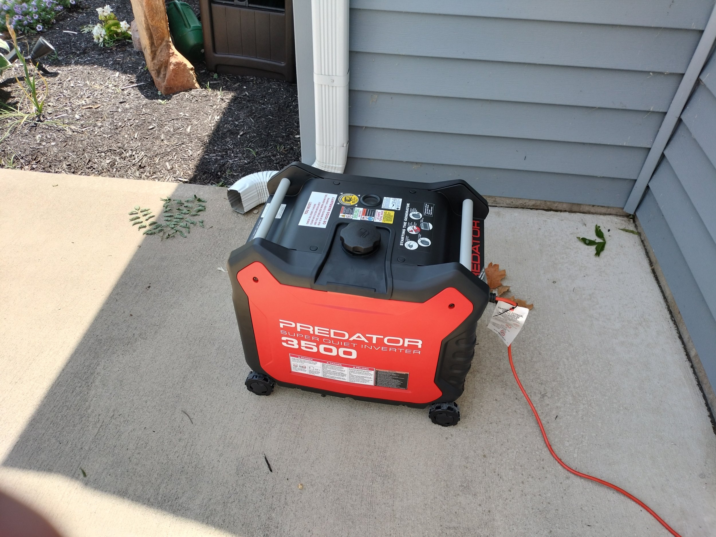

After massive storms ripped through western IN last night, I finally bought a 3500W Inverter Generator from HF. It will run almost 24 hours on 5 gallons of fuel.
So far, quite impressed. Easy setup and starting, also very quiet. Rumor says we could be without power for 6 days. Looks like I can keep the freezers running and the air fryer too 😂
Wish I had not waited so long View attachment 808683
Bought the same one about 5 months ago, they had a coupon thing going so I paid $720 , have only put 1-2 hours on it so far. Changed the oil after about 1/2 hour of use. Seems to start very easy when it’s warm outside but not very easy when it’s cold outside. Kinda surprising how heavy the little thing is, if it wasn’t so heavy I’d probably store it inside the house during cold weather to insure it would start Easy when I needed it. I probably should have bought the next smaller size, they are quite a bit lighter so would be much easier to carry by hand and probably would put out enough power for the little I would use it. Power outages have been pretty rare where I live and rarely last more than an hour, about 30 years ago Power was off for about 24 hours because of a serious ice storm.

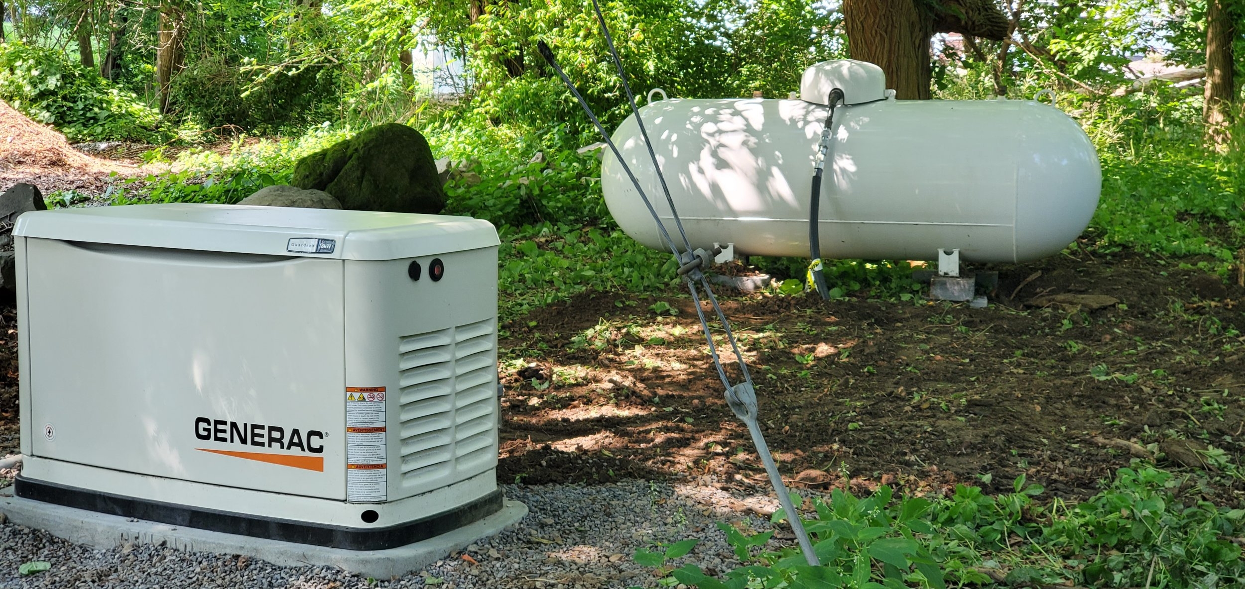

We just had a Generac propane generator installed to replace our portable gasoline Honda unit. We wanted something that would run our well, oil burner, fridge and freezer. It is supposed to run 4-5 days at 25% load off of the 250 gallon propane tank.

We just had a Generac propane generator installed to replace our portable gasoline Honda unit. We wanted something that would run our well, oil burner, fridge and freezer. It is supposed to run 4-5 days at 25% load off of the 250 gallon propane tank. View attachment 809652
So does that equate to one day at 100% load? Just curious. I am considering a whole house propane unit, but fuel use and the ability to have my propane tank refilled in an emergency are my huge concerns. I am talking a severe storm with power out for several days. Not just a infrequent outage.
They say at 100% load the generator will use 5 gallons per hour. So that would equate to about 2 days. They also say it may overheat and may shut down to cool off.

So does that equate to one day at 100% load? Just curious. I am considering a whole house propane unit, but fuel use and the ability to have my propane tank refilled in an emergency are my huge concerns. I am talking a severe storm with power out for several days. Not just an infrequent outage.
Generac publishes usage tables against loads, and that is the easiest way to sort out how much propane you would need. @PJRAM brings up a good point that full load is not a sustained full load unless you get a Prime power rated generator. (Basically one designed to be on at 100% power all the time, in high heat.)
@grsthegreat is the expert, but I would try to target a generator that can run happily at about 50% when your normal loads are on, but pay extra attention to your AC units and well pump to ensure that your generator has enough capacity to start them up. LRA (startup amperage, aka "locked rotor amperage") can be 3-7 times running power, and your generator will need enough capacity to be able to start the AC. Inverter AC units, aka variable speed (infinitely variable, not three speed) ACs typically have startup currents very close to running currents. My $0.02 is to upgrade your AC when you are installing whole house standby backup power. It makes the load management much easier, and makes the demands on the generator much more reasonable.
I think that you should pretty much count on not getting refilled during an emergency. Firms almost always prioritize getting propane for heating out first. Our local branch of a national propane company told me when I asked that when there is an emergency, they don't fill generator propane tanks as a matter of policy until the the emergency is over and they are caught up with heating fuel deliveries.
You also need to look at the evaporation tables that will de-rate the flow from a propane tank by temperature and load to make sure that when it is cold you can get enough fuel out of the tank. That is mostly a small tank, above ground tank issue. Personally, I would take the longest outage that I had ever seen and double it. (at least)

Great info, thank you.
If you haven’t installed the propane tank, yet, get a big Honkin 1000 gallon tank. We have a 500 gallon tank, and we have never come close to running out while using our 17 kW Kohler standby generator. But the longest power outage has been about five days. Interestingly, the gas supply company said that they would be willing to take out our 500 gallon and put in a 1000 gallon tank. My friend who has a fairly steep driveway, did that, and so his propane furnace lasts all winter long without a refill. I’ll have to ask him what his current consumption rate is like on his generator. It is a 22 kW Generac.
Meanwhile, when we built our place in 2002, we had the electrician install an external year plug and a 60 amps generator subpanel connected to it, with the proper lockouts. We then bought a King portable generator that was 6500/5500 W, and it powered what did we needed just fine. Now that we have the 17 kW whole house generator, we consider the portable one as a back up in case, for some reason, the main generator fails.
Interestingly, they did a lot of upgrades to the power pole system here, but we have been getting more power outages than before. It seems that every time there’s any kind of storm, including a rain storm, the power goes out. Fortunately, Hydro One, our power utility, is very well equipped with trucks and personnel, and they fix it up right quick.
I picked up a similar-size Champion 10, maybe 12 years ago. So far only times I've run it have been semi-annual exercise runs, haven't had a power outage longer than a couple hours since I got it. Got a couple halogen work lights I plug into it for a load. Always starts easily, but I haven't tried it in the cold.
Got it mostly to power the refrigerator and freezer during a summer outage. Nothing I'd really need in the winter.
A 250 gal tank is absolute minimum generac recommends. Most of my customers have 500-1000 gal tanks. mine is a 1000 gal buried tank.
a generator never runs at 100% if sized collectly. Mine runs less than 50% for extended outages. Highest in winter with heated water troughs and heat tape, lower in summer. I have a 22 kw and had a summer outage that lasted about 4 hours. Had 5 ton ac running entire time, lights, refer, freezers, etc and i had a Flo-Pro meter installed to watch actual gas usage. I averaged 1.25 gal per hour. I was amazed that the isoft starter i installed on my ac unit allowed my unit to run at an average of 25% according to my real time genmon monitor unit. The ac used to lug down my generator, but not anymore. It took about 60% off of the starting amp draw.
