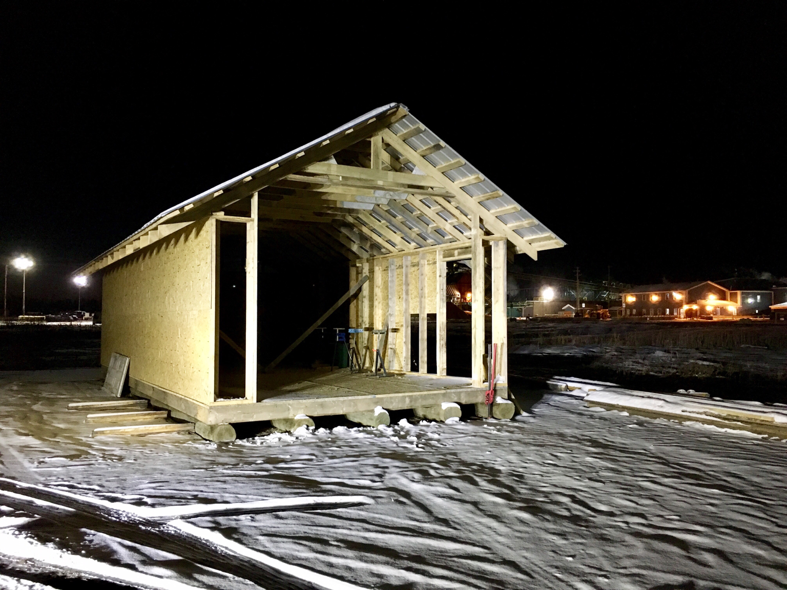

Well I was really hoping to at least get the sheeting and tyvek on but winter haul is going full bore so I guess this project is on hold until next year now. I haven't had a day where I was done work before dark yet but this is how it stands now. IMG_4513.JPG

Neat picture with the snow and the lights. Will the snow affect the OSB on the walls?
   / Finally building my storage shed. #28
Nice project. Night photo makes it look ... cold!
Did you choose a tin roof because of durability, light weight, or ???. I have a garage on my property built long ago from wood milled at the property. Trusses were not engineered as it was a .... no permits required ... type of job.
I've been thinking about sheeting it with OSB and putting a composition roof on, but I don't want to put more weight than it can handle. I don't know how to figure out what weight is appropriate. Except the tin must be much lighter.
   / Finally building my storage shed. #29
Metal roofs are much lighter than composition. My homeowners insurance company also prefers metal for better wild fire protection and fewer wind damage claims.
   / Finally building my storage shed. #30
What is the spacing of your trusses and how steep is your pitch? One of the advantages to metal over shingles is that you can space your trusses out a lot farther. Shingles need trusses 24 inches on center, or closer. I personally space my trusses out 4 feet and then use 2x4's on the flat for purlins across the trusses so I have an easy target to screw the metal down. Pitch is how steep the roof is. For metal, you can get away with 2:12 without any issues, but for shingles, you should never be less then 4:12
