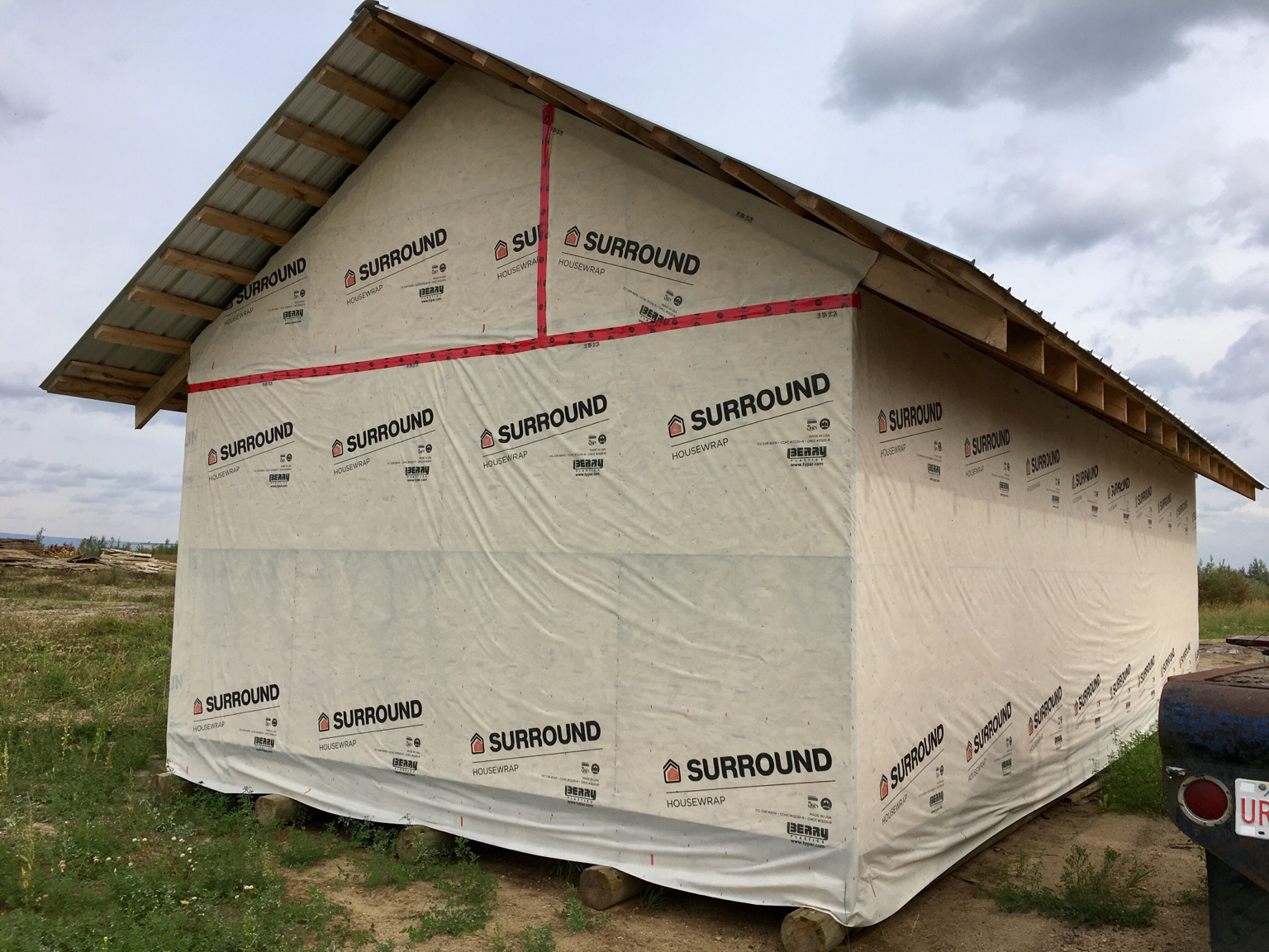

I went with tin for a number of reasons; I sawed all the lumber myself and I didn't have enough to plank the roof, the OSB is too thin therefore I would have to buy sheeting if I wanted to shingle which would raise the cost, tin doesn't allow any real snow build up, with tin I should never have to worry about redoing the roof in the lifetime of that shed, and last but not least the tin, roof caps and screws cost me $938.
   / Finally building my storage shed.
#42
What is the spacing of your trusses and how steep is your pitch? One of the advantages to metal over shingles is that you can space your trusses out a lot farther. Shingles need trusses 24 inches on center, or closer. I personally space my trusses out 4 feet and then use 2x4's on the flat for purlins across the trusses so I have an easy target to screw the metal down. Pitch is how steep the roof is. For metal, you can get away with 2:12 without any issues, but for shingles, you should never be less then 4:12
The trusses are 24" on Center same as the walls, with 2x4 strapping on 16" centres. The pitch is whatever looked good and gave me a ten foot ceiling inside. Haha. But for actual measurements I think it's around 7:12 or 8:12, I would have to go measure again to be sure.

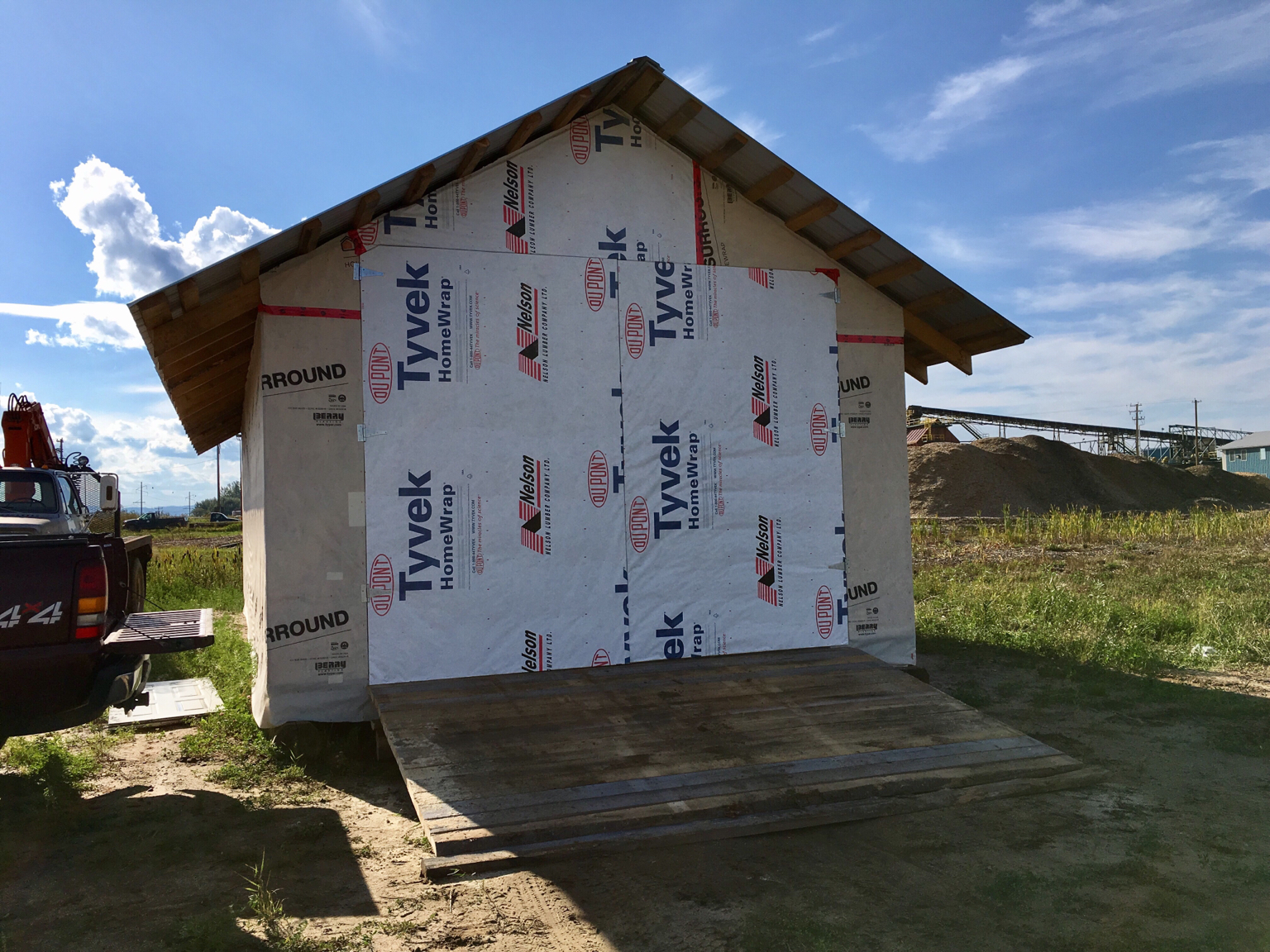

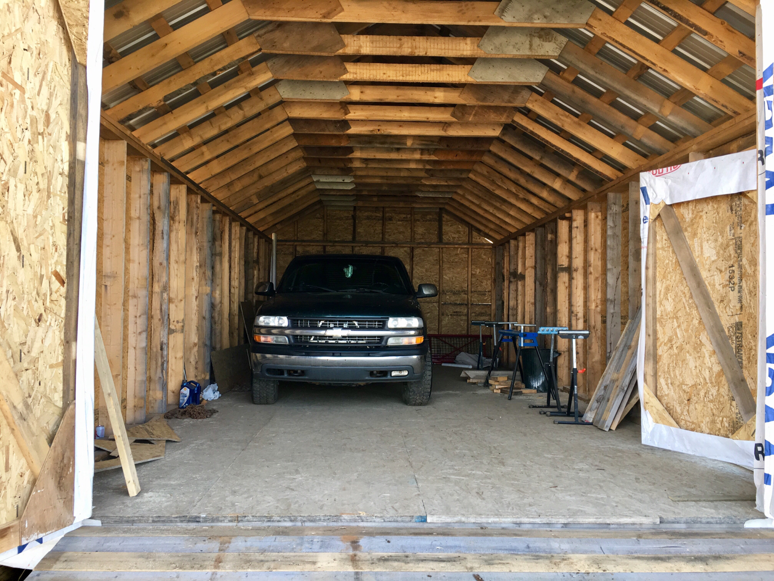

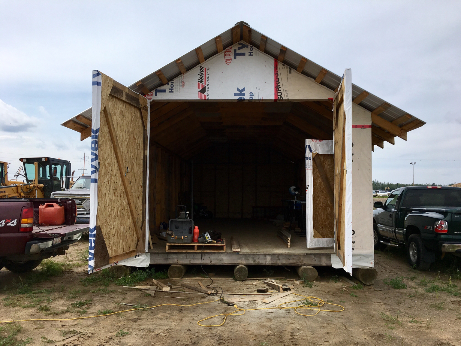

Well spring and summer has been non stop but we finally got rained out from work.
Tyvek is on.
Doors are built and hung.
Ramp is built.
The Chevy is finally in its new home.
Just have a few things like door handles and locks etc to do, and get everything cleaned up.
