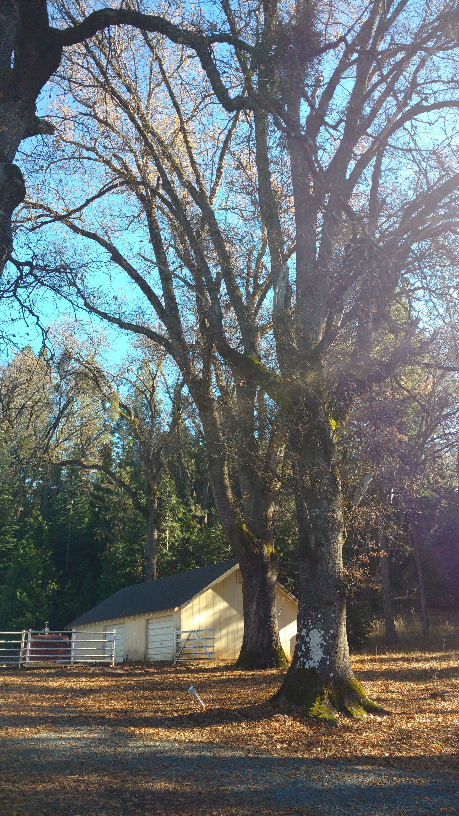

I would need some major logging to get 50 foot clearance between my tin roof and trees ..... the building is 24x36.
   / Finally building my storage shed. #39
Awesome trees! As much as I love trees, those would be far to close for me. With wind, disease and the possibility of wildfire, I wouldn't be able to sleep at night.
