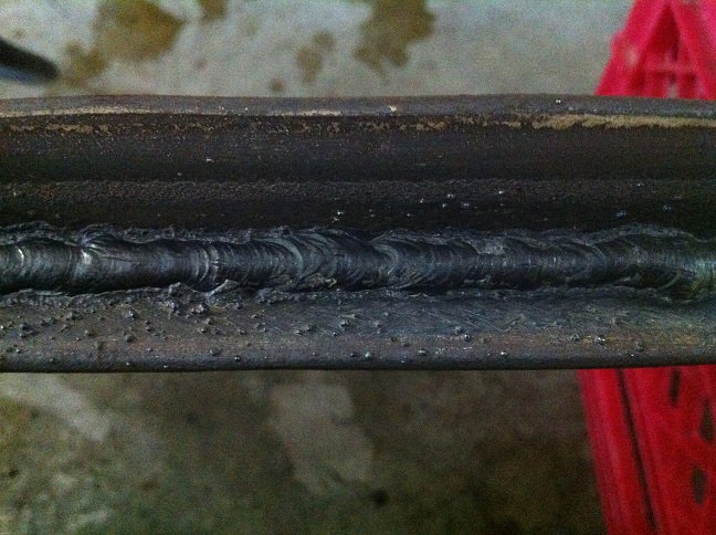

Man, you guys got me wanting a welder....again......after 25 yrs(as a teenager on the farm)....using a lincoln tombstone.....
i have researched these new welders for about 2 months....and finally ordered a new welder....
Today i set it up in the garage... MAN....these things have come along way.....:thumbsup:
I went to my local AIRGAS welders supply and ordered a Thermal Arc 211i.....took them about a week to get it in....
The guys there got me fixed up on rods/wire/gas..gloves, cart,clamps...etc.....
Ran my first bead in 25yrs.....:laughing:

Welcome back to the Welding World. Nice welder choice and now you will be dreaming up all kinds of projects.. That machine has some nice features. Power factor for one lets you pull big amps out of a 115v 20 amp circuit. You actually got 3 machines. 3 in 1 as they are called. Good luck..

I agree with shield arc, you can see at the edges it didn't dig into the plate, just kind of sat on top. It might help if we knew what you were running, at what power. Not knowing that, I would crank it up another 10 amps or so, and see if that fixes it. The other thing I find helps is moving the rod in little circles, so it really ties into both pieces well. That probably didn't help at all, I am useless at explaining how to do something, so much easier to show someone.

Nice start, warm it up a bit. Have fun!

Looks to me like it is some type of gas less flux core. With all that splatter, could be holding too long of stick out. Hopefully he is left handed!
/ Finally decided to get back into welding...... #7
I guess I assumed it was stick seeing the spatter, I have never ran flux core, so it didn't really occur to me. I thought it was 6011 or 6010, at least that are what mije look like.

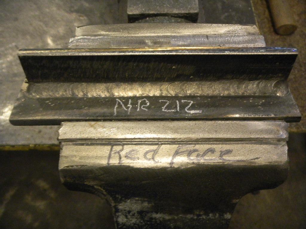

I have used Lincoln's NR-211 in Alaska with up to 90-MPH winds! Had to be very careful when walking around or we would be on our butts in a heart beat!
Here is a picture of the newer NR-212.

Thanks Guys. that 1st bead was with flux wire on mig..... it was set a little low because i was trying to weld the metal flange on the T-post i was learning on.... its been a neat 1st piece of scrap to practice....
last night i got adventerous and cut the T-post in to with my torch,.... then ground it down and welded it back together.... THAT WAS A CHALLENGE>.......:laughing:

I was playing with my new welder today.
