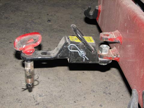

I started with straps, but quickly changed to chains for holding the tractor down. The straps got chafed pretty fast on the edges of my trailer. I use one chain through the rear pin hitch, to each corner of my trailer and a load binder. On the other end, I used to chain it to through the FEL arms going over the buckets. But I then added a tow hook to the front of the machine right on the "shelf" where the FEL lift cylinders, directly in the middle of the "shelf". I run the chain through that and to each side of the trailer. Then I rev it up and drive backwards to put tension on the front chain, set the parking brake, and spin the front tires until the brakes engage both front wheels. Then I tighten the load binder on the rear chain, the machine squats on all four tires, and its not going anywhere.
When I used straps, I used one on each ROPS arm to the sides of the trailer. One one each side of the hitch pin to the sides of the trailer, and one across any implement I had attached to the tractor to both sides of the trailer.

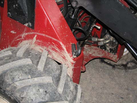

I had Tazwell weld chain hooks on all 4 corners - comes in very handy. Might not be too late to have them add that. Had Carl's done that way too. I can not remember where the weight starting point is (or if there is a weight starting point) but DOT requires tractors have 4 separate appropriately sized chains/straps for the tractor and one for the implement (such as a bucket) if attached to the tractor.
