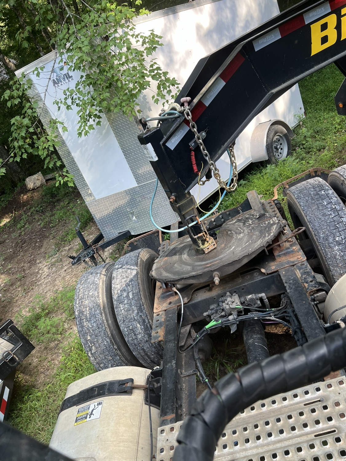

I had to make one since they don't seem to exist for the square tube goosenecks.
Needed it to tow a trailer out of state with the 3500, then put the 3500 on the trailer for the trip back home, now pulled by a 5th wheel.
That was a temporary solution and I'll make a "receiver" for a B&W turnover ball right behind the 5th wheel. That way there's still free movement even side to side.
For the electrical side of it, the Jackalopee I used works very well.

That's my plan, put a gooseneck ball right behind the 5th wheel, but it'll have to be removable not to interfere with a king pin. And with a sliding 5th wheel I can place either one right above the axle or a bit forward of it.
Not really sure why I even leave the 5th wheel on there, but since I still have two trailers for that setup it might as well stay. If nothing else, its weight helps the ride quality.
It'll be interesting to see how long it takes to learn how to stop right under the gooseneck's coupler with this new-to-me tow vehicle. I could also dump the air springs, but the two trailers that it makes sense to tow both have hydraulic jacks.

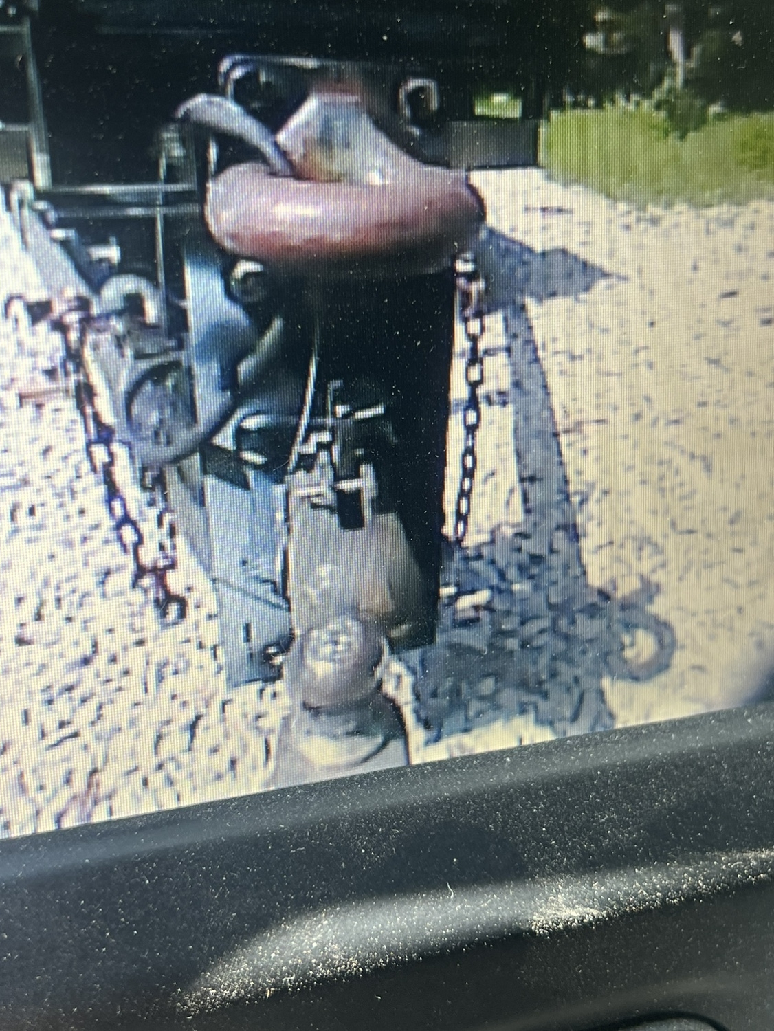

I can easily see out the Volvo back window to hook up. My 4 door pickup doesn’t offer the same ability. View attachment 4133548
Mine does. I have a 12” screen with a camera up in the headache rack. Came with the Ram.
Makes getting centered under the ball a breeze.
There’s a second camera down by the bumper pull hitch, too.

Your Ram is 3 years newer than mine. I only have the regular backup camera. A bed camera would be nice.
