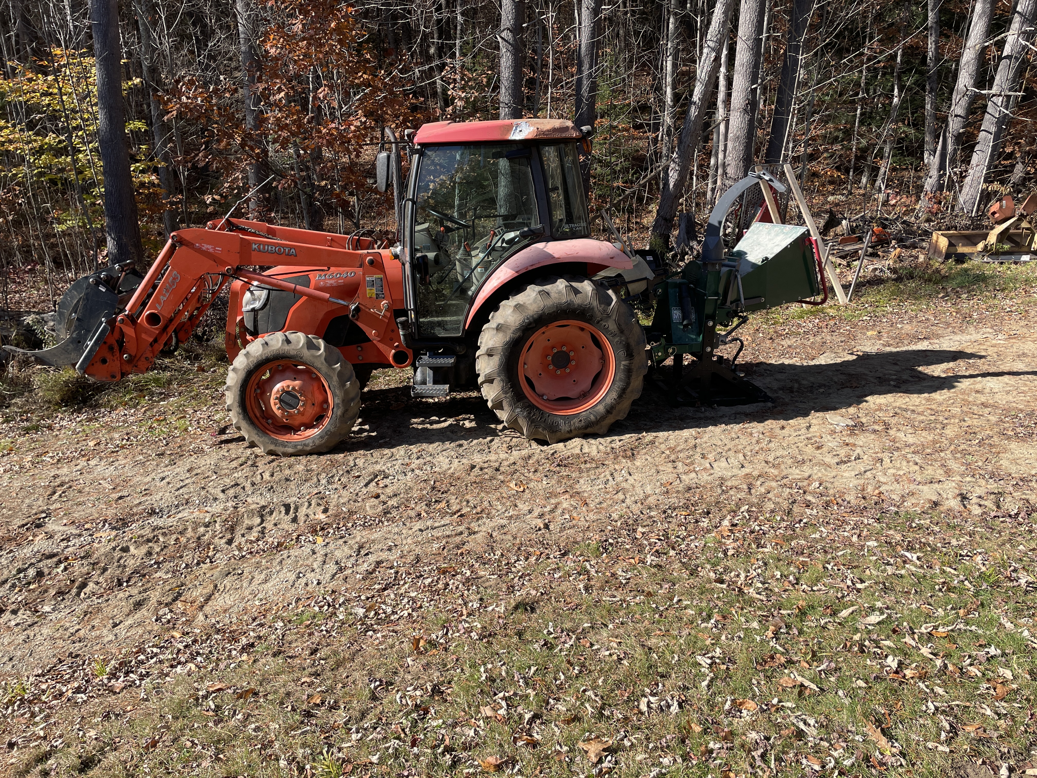

I have been searching for one for last few years and this one showed up on marketplace a couple of days ago. The price was right so I immediately went over and bought it. It’s a beast Woodland Mills WC88.
So far I have run up to 6 inch logs through it and it really does a great job.

This machine was used when I got it but according to the last owner, it was used minimally. 2017 model year.
A little dusty and surface rusty but otherwise seems very solid. Worth the wait and price.

Well, after running a few loads of logs through it, the most important thing is to trim the stubs close before putting them into the machine. I’m using 4 to 6 inch logs that have been trimmed, but only enough to fit in the feed opening and most of them will get grabbed and feed smoothly.
But I have had 2 pieces on separate occasions get jammed under the feed head and stop the machine while the belts spin and smoke on the locked pulley until I could run around the machine, open the tractor door and disengage the PTO. It was a scary few seconds TWICE!! 😱
A valuable lesson and thankfully no damage other than some life taken off the belts.
I did adjust belt tension afterwards as correct tension is essential for optimal feed performance and there was some room for adjustment.

Hold on, isn’t there both a forward-reverse-disengage lever on the side, as well as an emergency shutoff on the entrance to the hopper? Or is yours a gravity fed chipper?

It does have a F N R control and I did try it during the event but the log hopelessly jammed and required disconnecting the tension springs that keep the feed roller tight to the log and using a lever to pry the roller away from the stuck log so it could be pulled back out.
No emergency shut off.

I have the smaller WC68. I found the feeder tension springs set way too tight from the factory. It works much better once I loosened the up a bit.

That’s interesting. I just tightened mine per the troubleshooting guide which indicated when chipping slows down it may mean the belts are slipping so I increased tension closer to the 1/4” adjustment spec.
I must say that occasionally the log won’t feed and the feed roller will jump and not grab. I have to rotate the log or end for end it to get a surface it will grab. I suppose heavier tension could be a factor.
