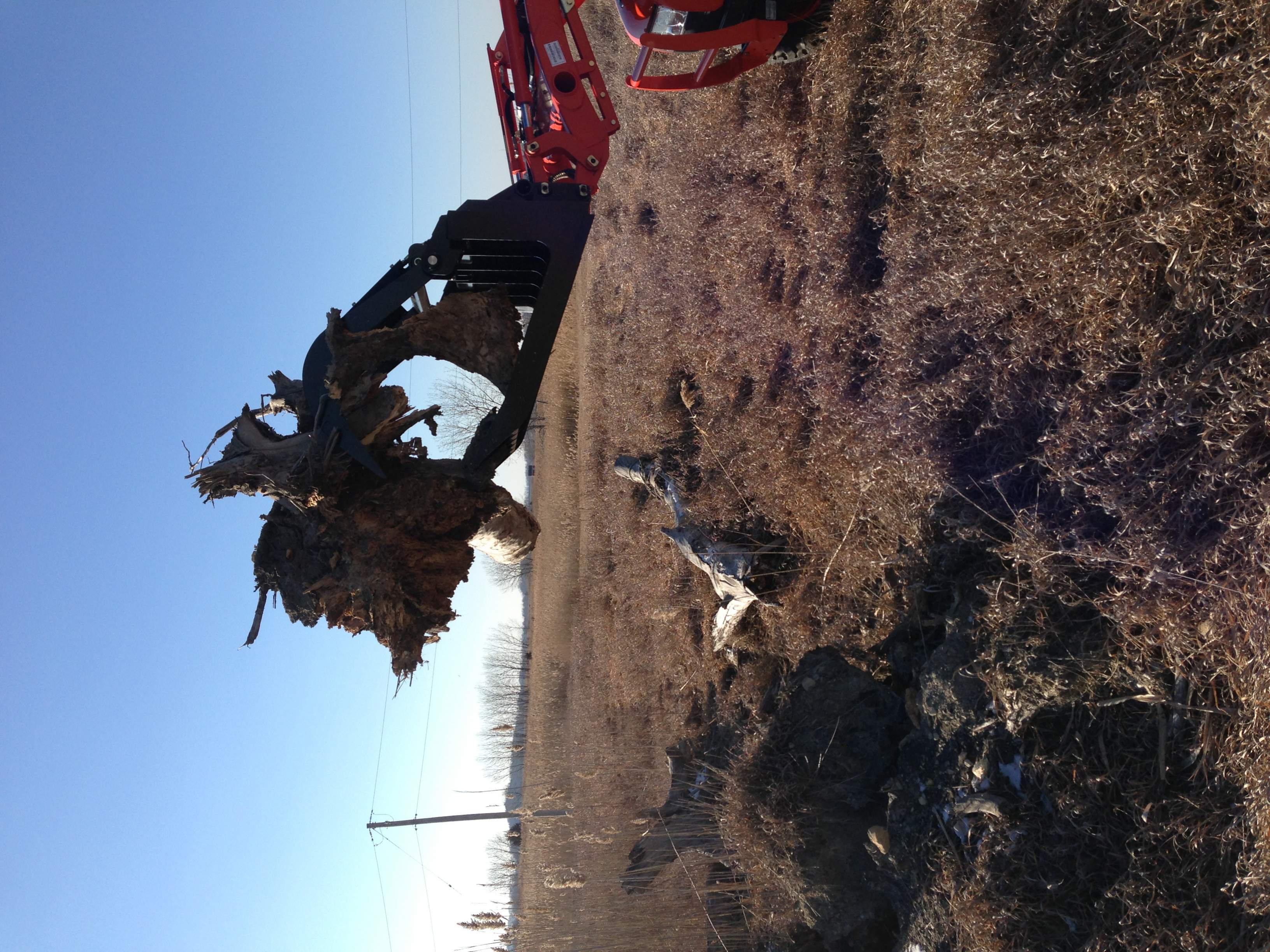

I ran the hoses last week from the rear remotes to the fel. I thought I had the wrong Quick connects for the rear, but did get them to seat in the female end today. My lines are a little long but that's better than to short. I really don't like all the slop I have where the front connections are. A bulkhead connection is in my future.
My grapple and QA 42" forks came from Titan industries. Everything was secured to a wood pallet. Te grapple also has a very nice steel cage all around it with small casters ( very small) on the corners. Very nice job! The spacing on the flanges that connect the grapple or forks to the loader looks fine. The shipping was fast too. Everything looks heavy duty.

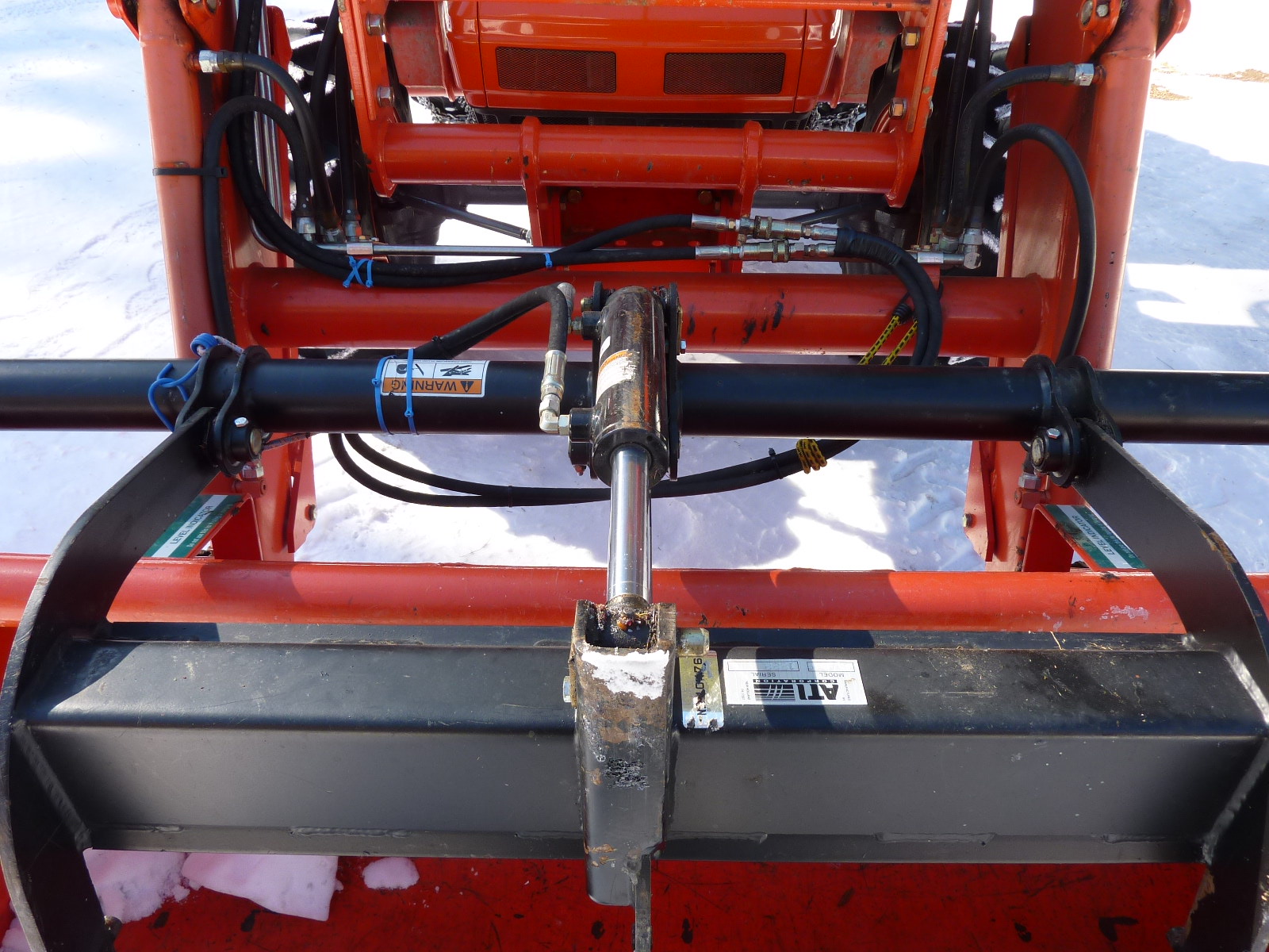

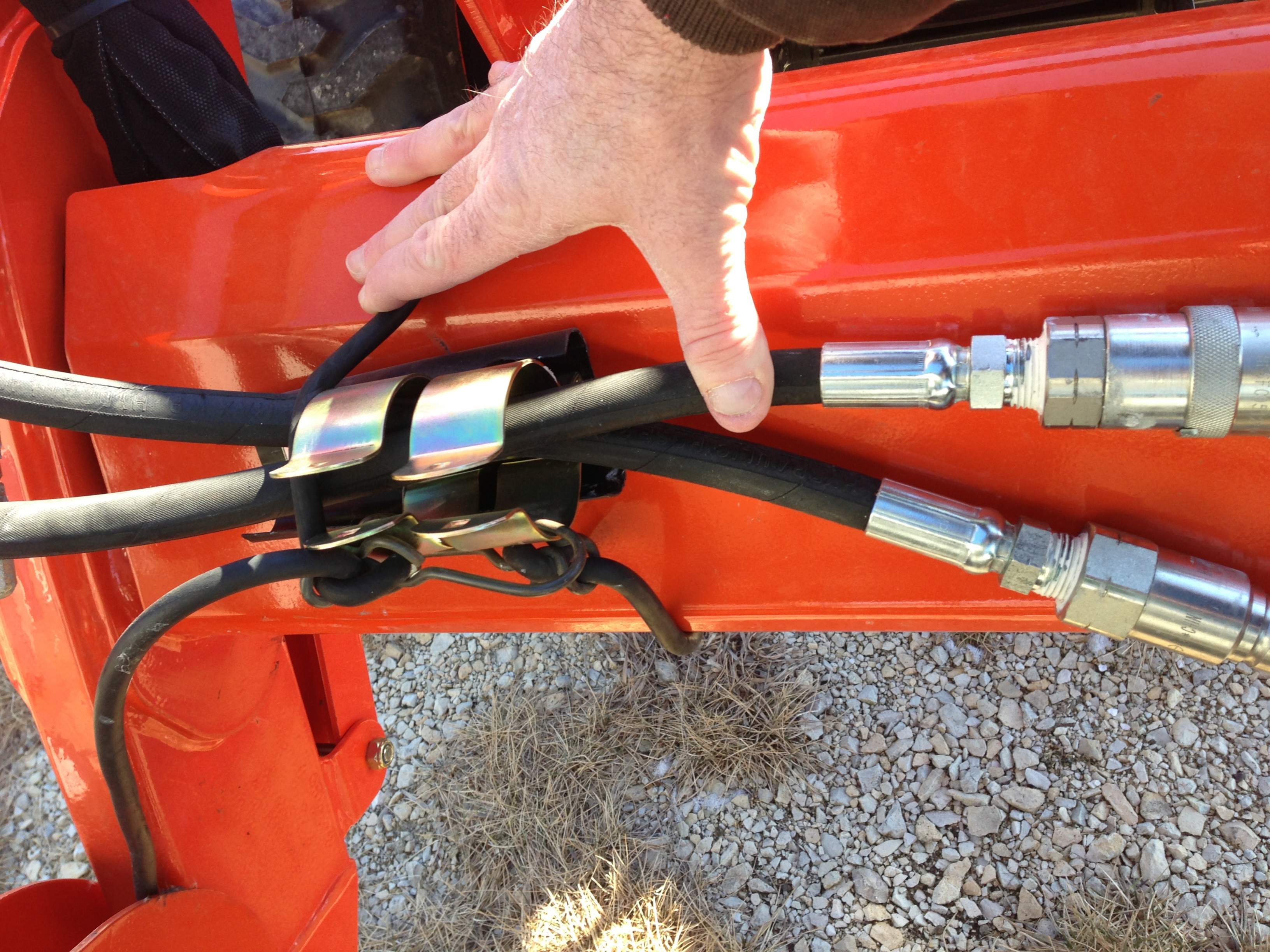

It takes a bit of slack. Here is mine curled back and dumped. I put bungies on for a temporary solution. Trouble is they been there for years now :laughing:

Check your hose length at full dump. That's what will take the most hose. I use a tarp strap on mine, only I hooked from the hoses to the grapple. That way I do not have to disconnect the tarp strap when I take the grapple off.
