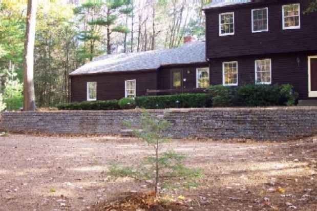

Chris2520 said:
I saw some people build one of these walls at a office building down the street from my house. I did notest thay put down some sort of wire mesh webbing about every 3rd block up and filled over it. like some sort of support.
to tie it to the wall. it was about 12 foot wall.
kinda like you would put dead men in a cross tie wall. i suppose it is to serve the same perpose. as support.
Chris.....:)
Geotex or similar. requires some engineering It takes into account type of soil and stress the bank is likely to put onto the wall. For my 9 ft wall it wasn't required, but the dealer showed where they had to use it on a 3 ft wall due to soil movements.

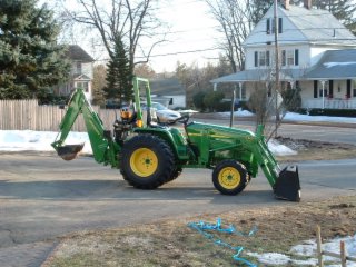

Ah, good point, they're all aftermarket hoes at my dealer. (wonder why ?)
Willl: What make backhoe do you have?
I bought a 3pt hoe for my 770 (just about identical to a 790) and I fab'd a subframe for it..took some time and energy, but everytime I use mine (practically every weekend.;) ) I'm glad I built it.. The subframe makes for a stronger tractor with FEL work, and it adds over 200 pounds too.
/ FINALLY Got My Backhoe #44
I've got the Bradco 3265.
Yes, building one isn't totally out of the question.
Must admit, with the home made subframe, removing, and installing the hoe takes real work..:eek: ..if I was building it now, would definitely do it differently.
I'd spend the time necessary to make it self line up to pin holes, I built it to bolt on. It works, but swapping it out is a job. Hope to make some modifications next year..too busy now.

I can take the BH and FEL off and install the 62D MMM in about 25 minutes without pushing it.
