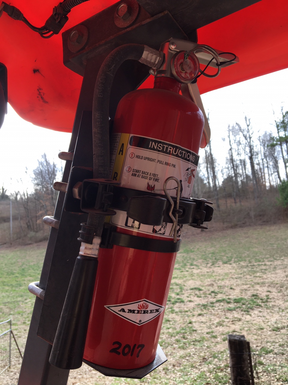

Vehicle mount from Amazon. Nice heavy steel made for easy mounting.
Kidde 408-368064 Fire Extinguisher Bracket, 5 lb. https://www.amazon.com/dp/B00N4ZZBYI/ref=cm_sw_r_cp_api_i_xkFdEbKN3QV39
For a 5# fire extinguisher.
Installed with 3 square U-bolts. No drilling or cutting. Made rubber washers to back pull pin and clamp to make rattle free. Survived multiple tree limbs and bush hogging.

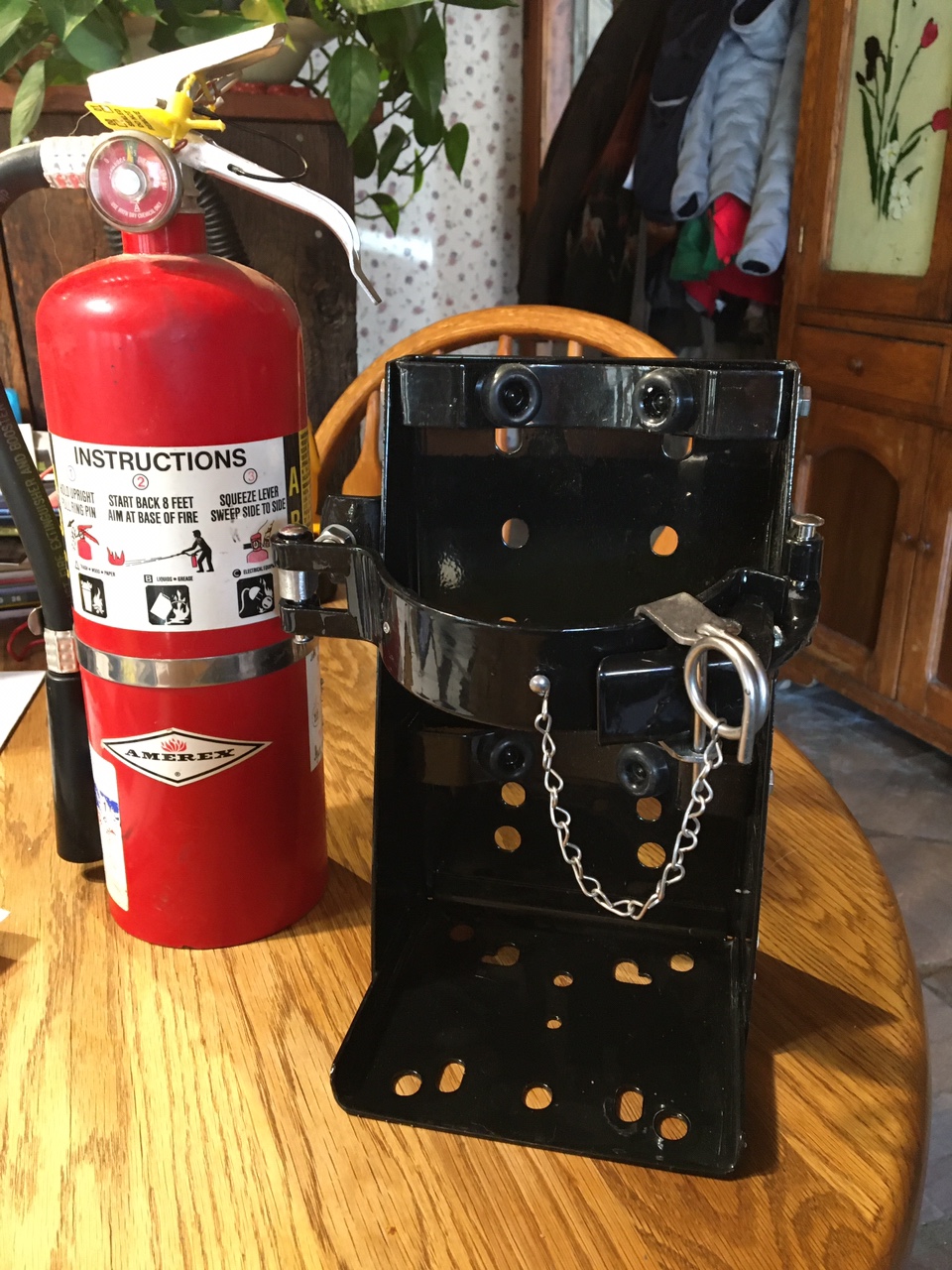

Just bought another vehicle mount for a 5# fire extinguisher to upgrade the camper. $21.52 delivered from amazon. Adjustable to get a tight fit. Sturdy steel construction. Prices vary so watched till it dropped. These work well on my two tractors that see hard use.
