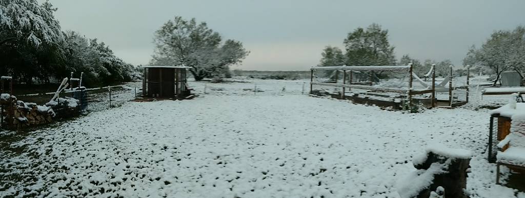

I've been sidetracked by paying work again. I was hoping to get it dried in by Christmas but, I'm doubtful now. I've got a lot of traps to get built.
We did get snow though. IMG_20171208_071536057.jpgIMG_20171208_073925347.jpgIMG_20171208_073955649.jpg

Sorry to hear about the snow. That stuff just creates mud that never goes away!!!! Nothing worse then when it happens here.
Nice to hear the traps are selling. Do you go the the Hunting Conventions like Dallas Safari Club next month?

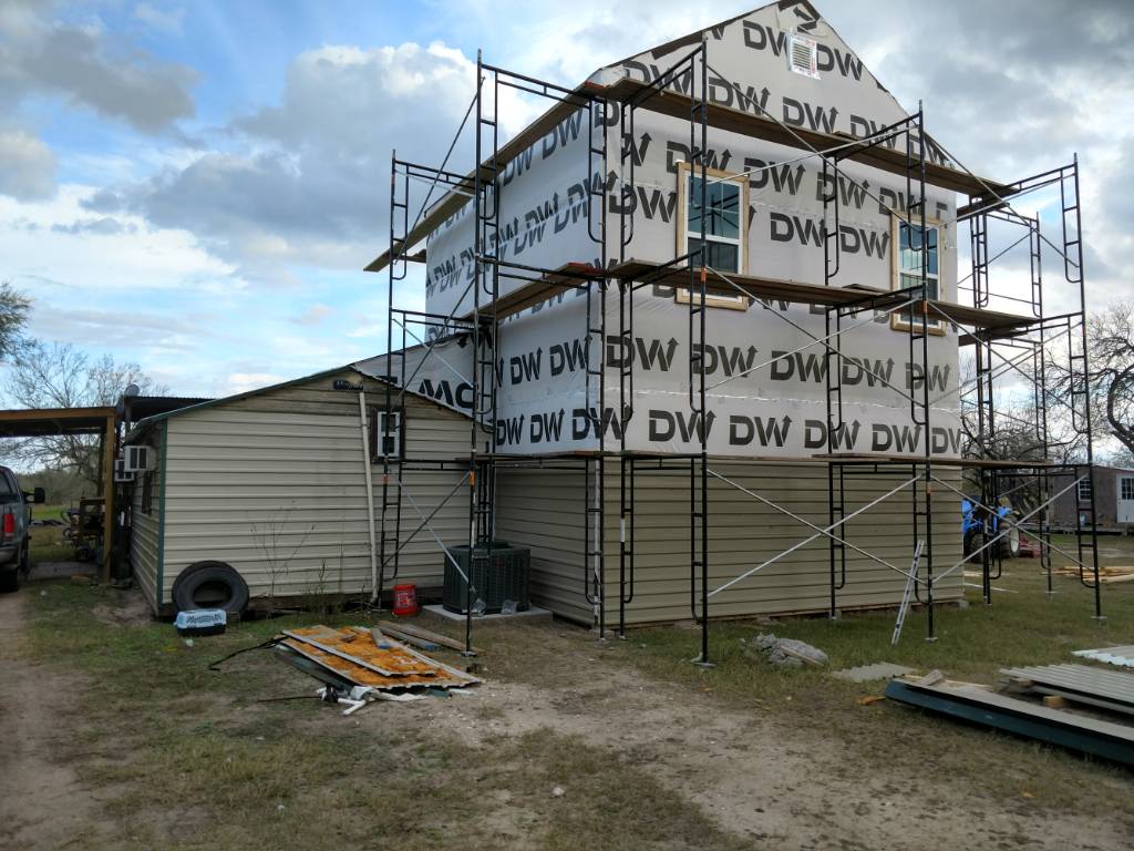

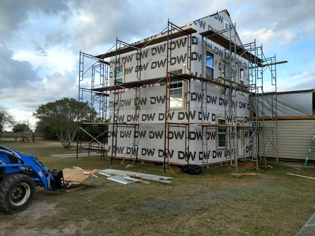

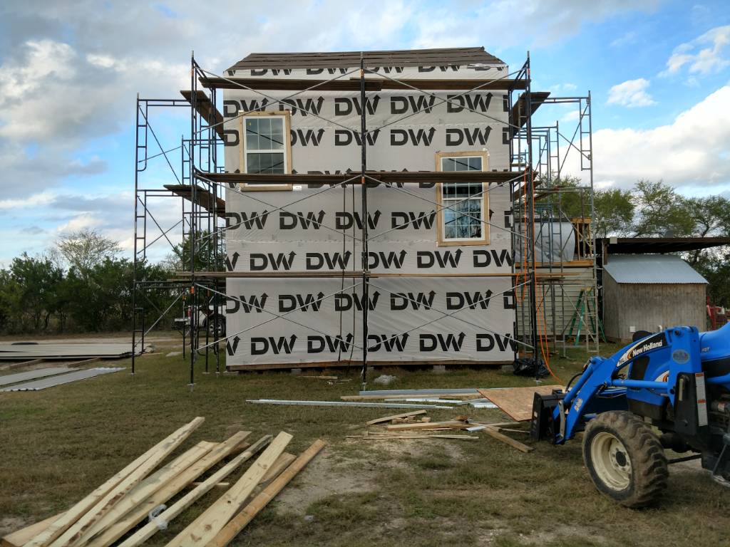

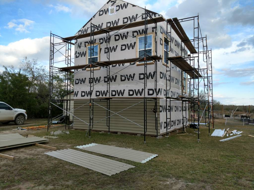

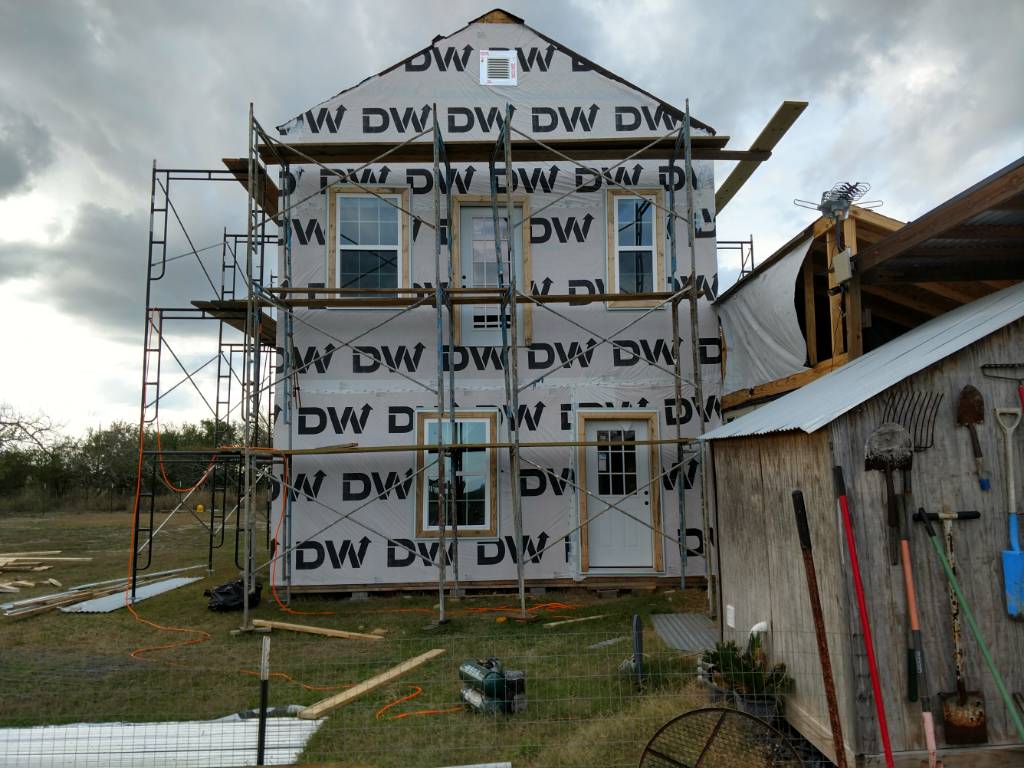

I finally got an opportunity to work on this again, got the last window done and the door installed earlier this week. Today I had a friend here to help and we trimmed out all the windows in 2x4 and got the j channel up that we had. I have enough total length of j channel but, a ton of waste so I'm short, I was expecting it to be in 20' pieces and it came in 10'. I could scab it together but, I don't want the seams so I'll get more Monday.
We got one more long piece of siding up this afternoon but, I just sent him to the stand to try and kill a spike we need gone. In the morning, we're going to get the siding done as far as we can being short on trim, it'll get almost all the full pieces done so I'll be able to get some more done by myself during the week after the trim is on and I'll pin one of the neighbors down to help with the last of the full.sheets and the roof. I should for real have it dried in this week, FINALLY. IMG_20180106_161952799_HDR.jpgIMG_20180106_161936466_HDR.jpgIMG_20180106_161920592_HDR.jpgIMG_20180106_161909735_HDR.jpgIMG_20180106_161855412_HDR.jpg

I just noticed your attic vent on your gable. You might have mentioned it, and I'm sure it's there if I look hard enough, but what type of roof are you putting on? Not that it matters too much, because I would strongly, VERY STRONGLY, suggest you abandon that little gable vent and use a ridge vent. While the gable vent will accomplish the task of letting the hot air out of the attic, it's not 100 percent and over a short amount of time, there will be signs of heat build up at the peak, and just a little lower down from the peak in the center area of the roof. On metal, the hot air will find a way out through the seams and discolor the metal, turning it black along the edges, and then more so over time. On shingles, they will dry out and curl on your faster then the other shingles. The heat build up at the peak in summer is unreal!!! Ridge vents are the only way to deal with this.
