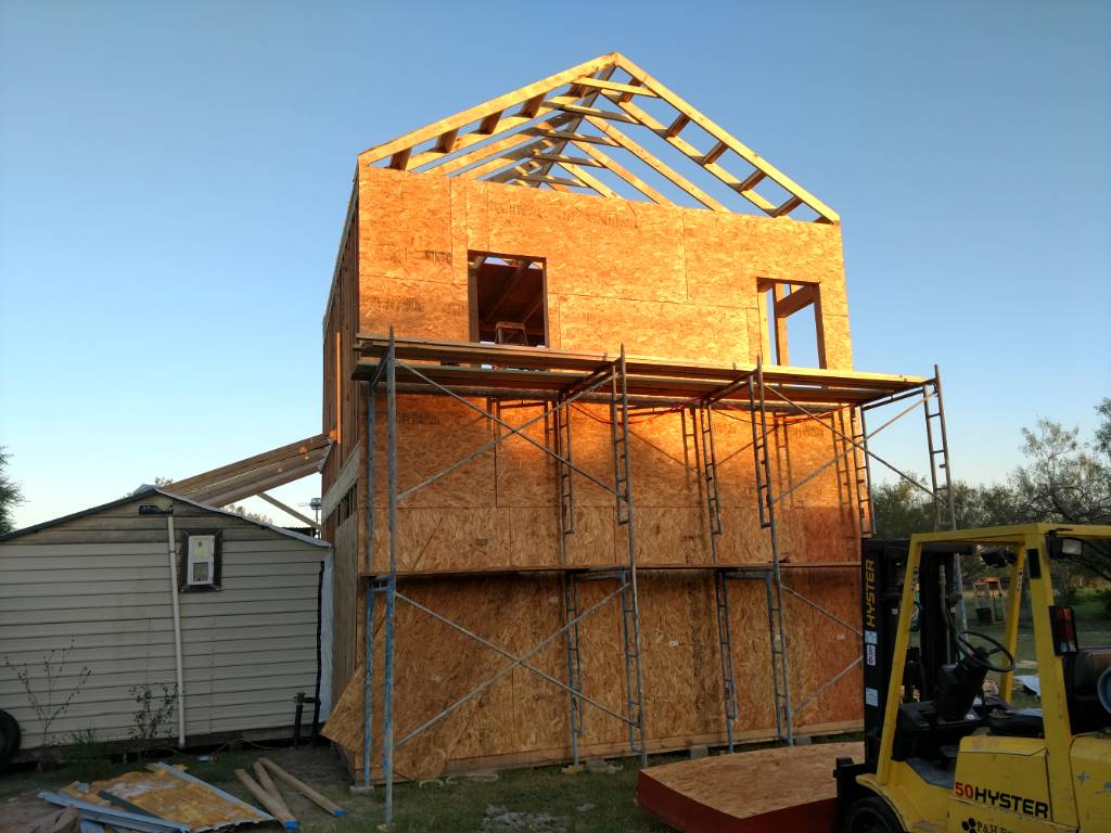

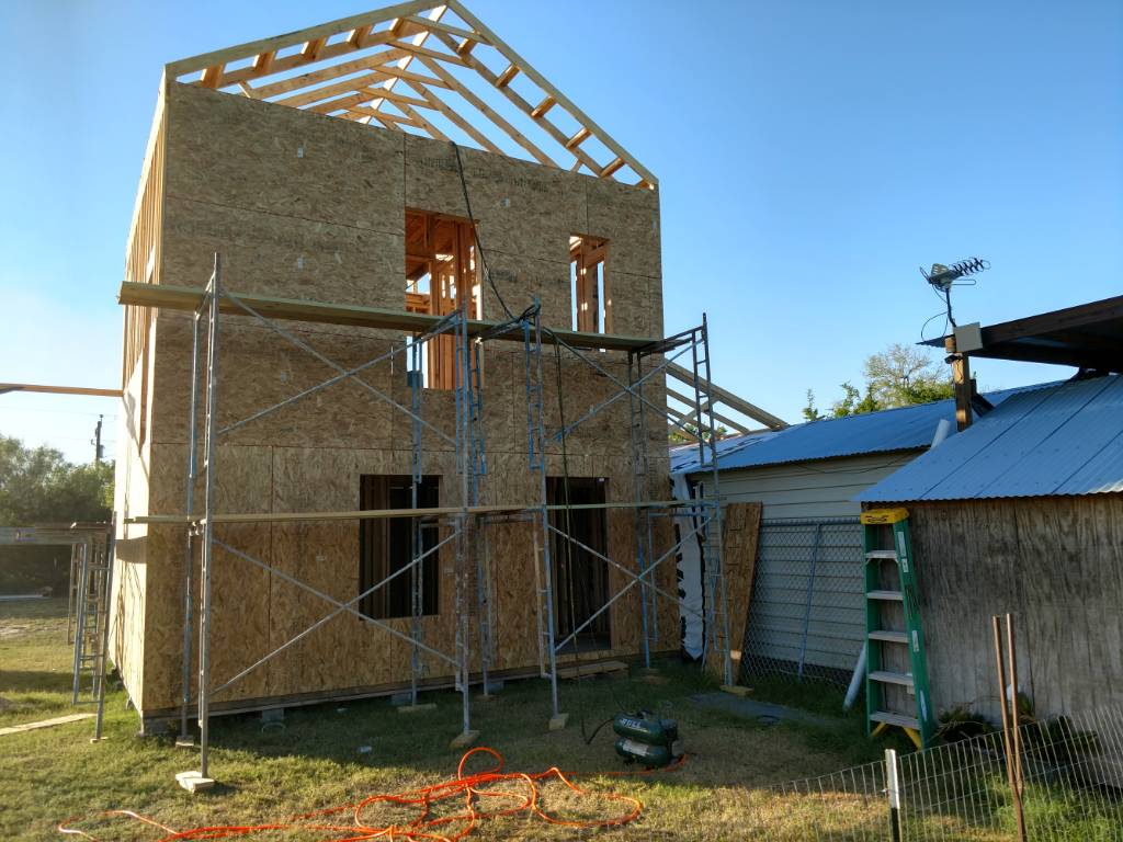

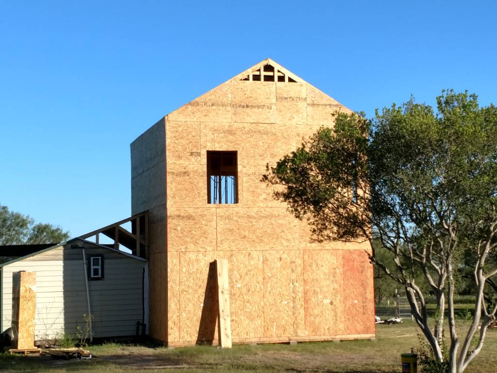

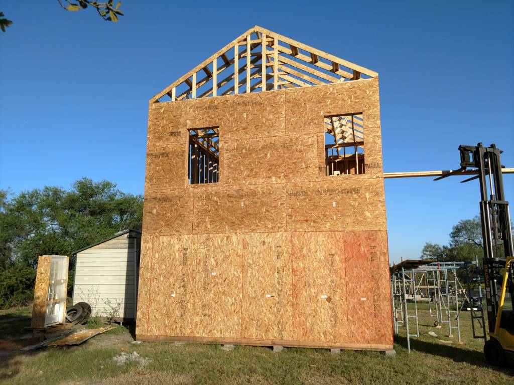

Got most of the scaffolding down over the weekend so I can return it. Place looks different with it gone.
Still hanging drywall inside. We haven't had as much time to work on it as I'd like, other Spring stuff has been getting in the way, like planting the garden, mowing, etc. My daughter came to visit for my birthday last week also so, I didn't do much while she was here. IMG_20180303_103121262.jpgIMG_20180303_100201515.jpgIMG_20180303_100151306.jpg

What was the final rental cost for all that scaffolding?
   / Finally starting an addition on our shed
#183
It was $240/mo, right at $750 after tax, etc.
   / Finally starting an addition on our shed #184
Thats more then I expected. Cheaper then buying, but if you need scaffolding again, it makes me wonder.
#185
The real expense, renting or buying, are the planks. I could've done with 1/3 fewer but, my wife needed 3 to feel comfortable.

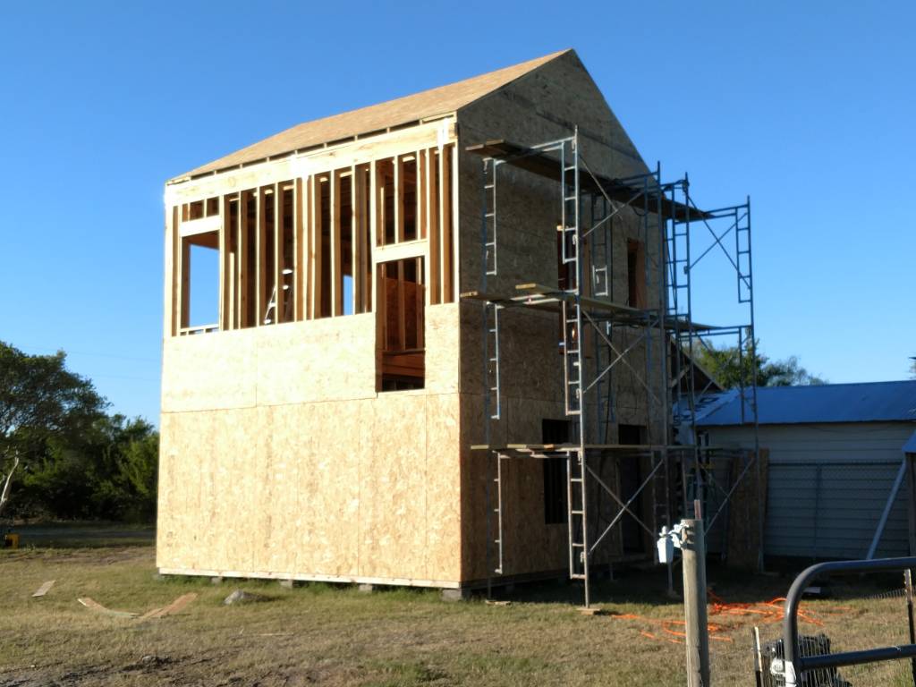

So, life slowed us down again and I was in an auto accident last month that I sustained some spinal injuries that have left me with pain, numbness and other issues (I can't really discuss it further yet) but...our daughter has decided she doesn't want to be in Cypress anymore because she misses us and is just lonely in general. So, when the apartment lease is up in December, she's moving here which means we can't screw around anymore, we need space for her.
Drywall is coming along, very slowly though it's still forward momentum. I've just about got the upstairs done, still a little bit of plumbing to finish up, punching the vents into.the attic and the male adapters for the valves, and we can finish up the bathroom drywall. The tub is getting delivered today so we can get that placed to put in the backer board.
I plan to finish up the stairwell drywall, then build the stairs and then do.the downstairs ceiling and walls. I'm.doing electrical finish work as the drywall goes up so it's done and we're going to hire put the float, tape and texture. We could probably do it given enough time, with our new hard deadline though, we decided it was best to just pay to have it done.
The inside is starting to look like a house now. We're hoping to have the addition complete by October as we still have to move a couple of walls in the original shed to create an eclosed bedroom for our daughter once the ingress/egress changes between the 2 buildings are made.IMG_20180611_151619048.jpegIMG_20180611_151603215.jpegIMG_20180611_151555007.jpegIMG_20180605_093030578.jpegIMG_20180516_101006058.jpeg

Sorry to hear about the accident. Hope you have a full recovery and it doesn't interfere with your business. That's one of my all time fears, not being able to physically do my job.
Nice to see that you cut out the windows from the sheetrock. Next time you hang it, try to go horizontal. Just like laying plywood for a sub floor, you get more strength and a nicer finish by crossing as many boards as you can. With taller walls, you put one sheet up high, another down low, and then rip a thin piece for the center.
#198
Yeah, I haven't really worked much since the accident and when I have I've really paid in pain. I didn't collect anything in May after it happened because I couldn't physically finish the product.
We had a lively debate about which direction to hang the drywall and settled on vertical because:
1 It leaves fewer tape seams and puts the horizontal seam below eye level.
2 How much sheer strength is 1/2" ultralight drywall really going to add over the OSB and metal siding.
3 It's physically easier with the injuries to do it vertical.
On 8' or shorter walls I've always gone horizontal but, for those reasons we decided on vertical this time.

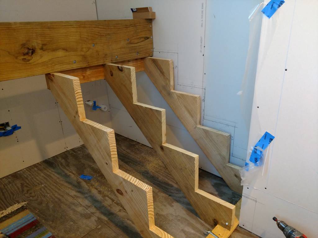

Started the stairs. Our rise is 9 3/8 because we don't have much run space and we both prefer a taller step.
Winder stairs next and then the other set of stringers, hopefully finish them this week, it'll depend on my pain levels.IMG_20180903_192353099.jpeg

What are the stub outs under the stairs for? World's smallest bathroom? ;).
