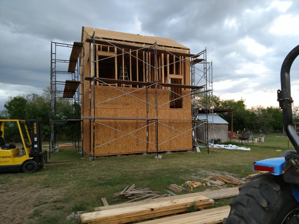

Finally starting an addition on our shed
