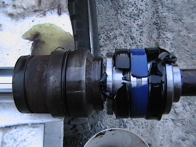

This is what makes me think of blown cup seals - "3. The bucket curl function works somewhat, but relief valve releases pressure when reaching only 1500psi. Because the oil is by-passing the piston. The resistance required to create pressure is limited. I don't believe the lower pressure you're seeing is the relief popping. There should be a squealing or hissing sound coming from the valve if it's releasing. There will be a hissing sound coming from a cylinder if the seals are by-passing.
4. The bucket uncurl function works and relief valve releases pressure at 2100psi. Because the piston is at the end of it's travel, and the cup seal is up against the cylinder end."
Just my two cents because I've experienced this first hand.

Is there a way to verify blown cup seals without tearing into the cylinder?
Yes but its messy.
First, EXTEND the cylinders all the way (Dump the bucket). Remove the rod side hose. Try to dump again.....if oil comes out the cylinder where you just removed the hose....bad seals. If no oil comes out, seals good.
   / Finding point of failure - diverter valve or FEL control valve #55
Actually, you want to extend in the direction that you were getting the low pressure reading, whichever that was.

The low pressure is when I'm curling the bucket, so do I still remove the hose on the rod side? How do I check the lift cylinders?
   / Finding point of failure - diverter valve or FEL control valve #57
The same as the tilt cylinders. Lift the bucket until the relief valve squeals or hisses. Lower the bucket flat on the ground and lift the front of the tractor until the relief valve squeals or hisses. If the indicated pressure is the same in both directions, and the lift arms hold in both directions, the cup seals are fine. Something I forgot to ask, do you have the regen feature on your loader valve?
   / Finding point of failure - diverter valve or FEL control valve #58
I don't know how your cylinders are mounted so I can't say without seeing a picture.
