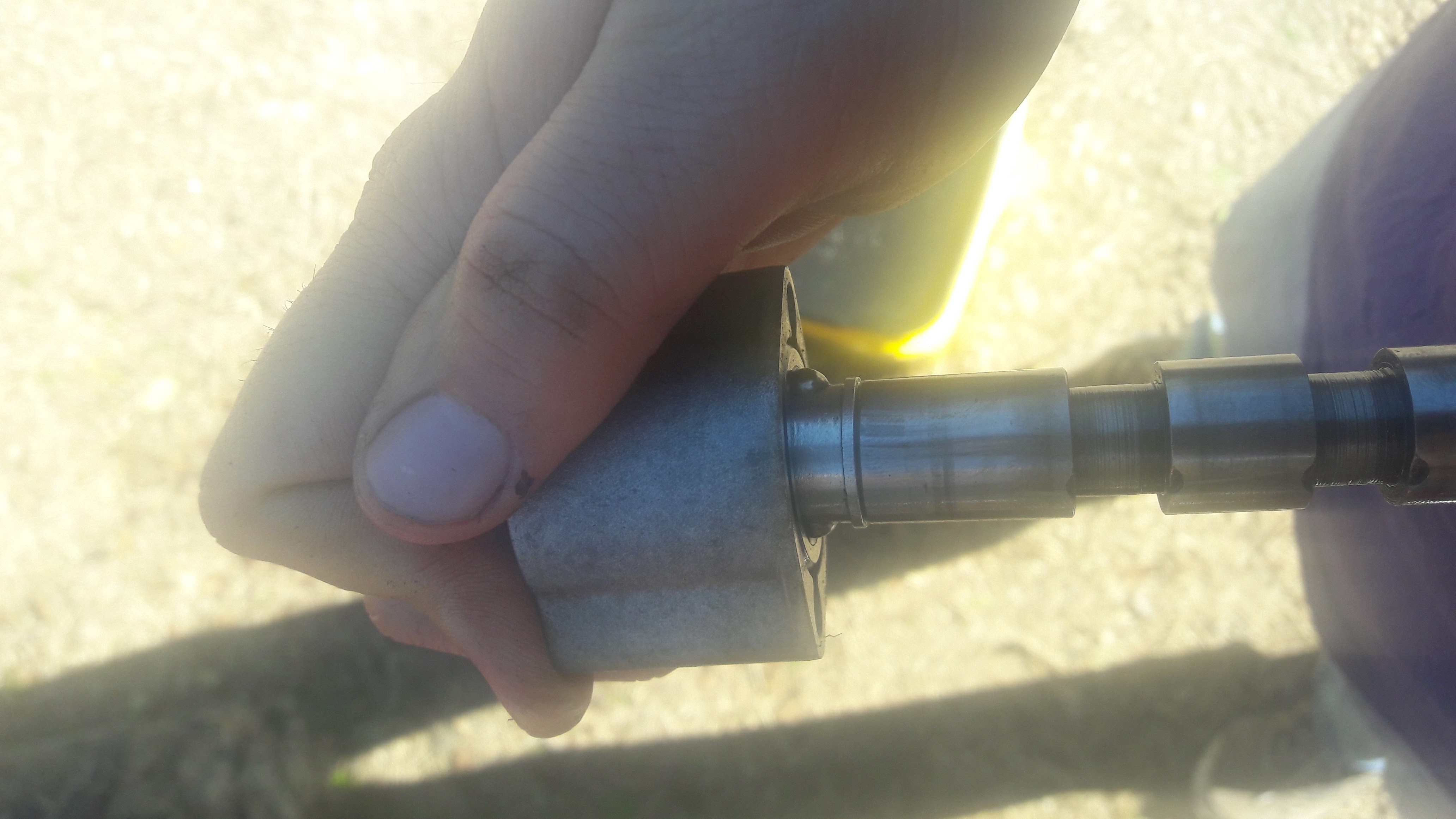

#63
I got the spool apart and checked, and everything seems fine Everything was held together and there was no debris or anything. I'm having issues getting it back together though. There are two ball bearings that fit inside a sleeve. I can't get the bearings in far enough to get the sleeve over them.
   / Finding point of failure - diverter valve or FEL control valve #64
Did you happen to take a picture of the entire spool right after you removed it? Which end of the spool are we looking at?
#65
I got it back, I just wasn't using enough oomph.

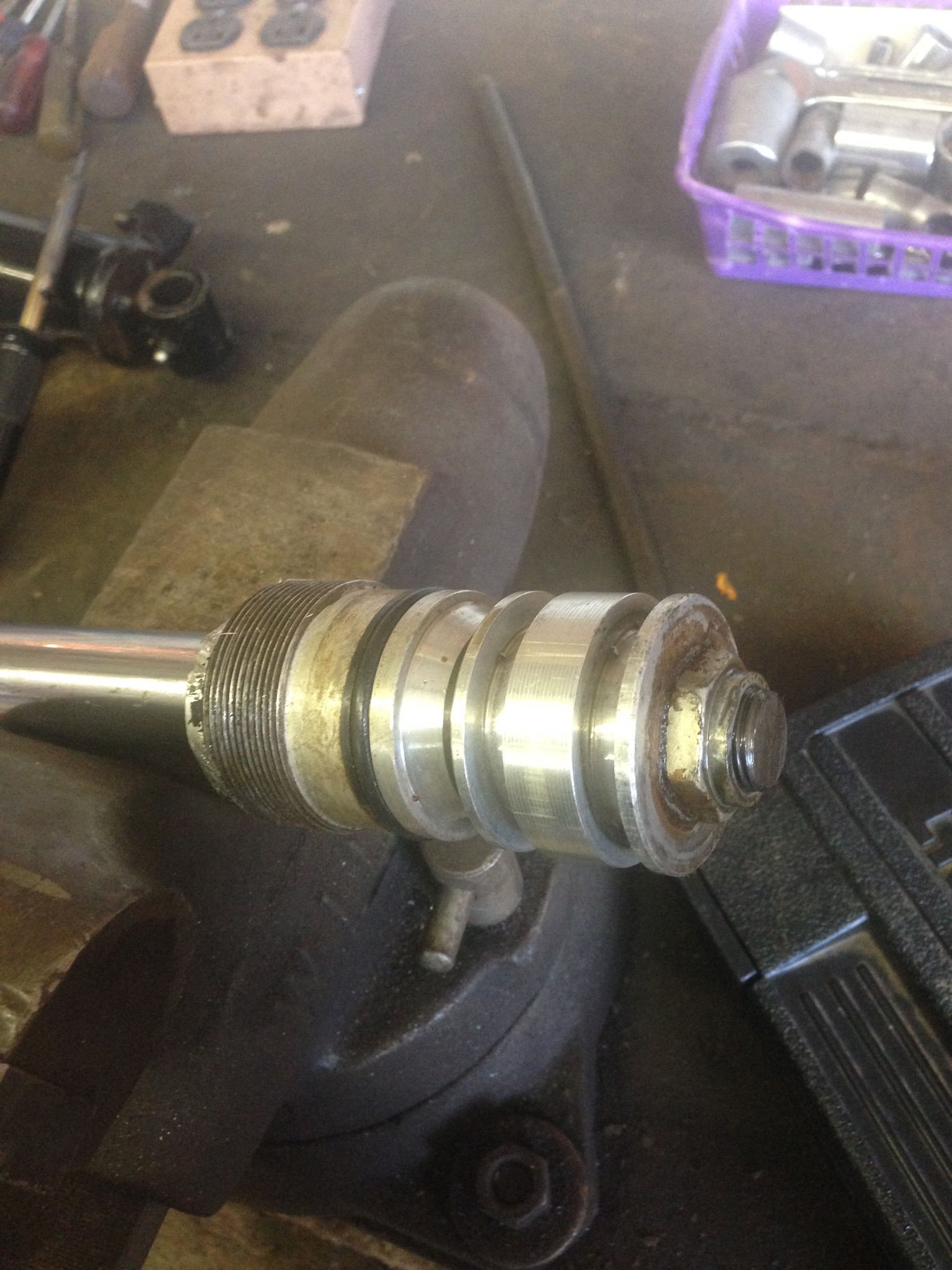

#69
Had a buddy help me get it off. Destroyed the gland nut in the process, but this is what he found. I still haven't seen it in person, just the picture. It looks like the piston seals are completely gone. As in not there.
   / Finding point of failure - diverter valve or FEL control valve #70
That's odd. Were they damaged and your buddy just took the seals off for the picture?
I have never seen a cylinder completely missing the seals. If a seal started to deteriorate and come apart in chunks, I would have thought you would have had issues long before the seal was completely gone. Plugging up small passages in the valve and quick couplers. So gotta wonder where all that seal material is now floating around in the hydraulics, or if the filter caught it?
