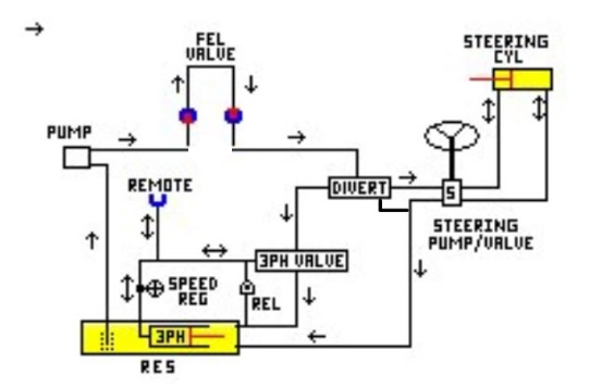

What is the name and model on your FEL valve?
Pace Manafacturing 7040
Is the gauge connected to the pressure line from the pump to the FEL valve?
Yes.
You said that the bucket is working so now can do some testing:
Set tractor RPM at about 1200.
Now curl the bucket till it stops. When it can move no further (mechanically), the relief valve should open. This should be at 2000psi. If it is not, adjust relief valve so that it is (2000psi should be a safe setting for testing).

I tried this out. When curling the bucket back towards the tractor I hit right around 2000psi. The loader will still not lift. Still the only way I can get it to lift is to turn the wheels all the way in one direction and keep turning the steering wheel, while pulling the lever to lift the bucket. Once the bucket is lifted it will hold and slowly fall. If it's in the air and I'm not holding the steering wheel all the way, and I try to raise or lower it, it will fall quickly.

If the tractor is an open center hydraulic system, I dont see how the loader valve will ever work the way the picture shows it being plumbed. CAnt just "TEE" things into a open center system. They have to be in series, or use a flow divider/splitter. The divider is after the loader. Hydraulic oil takes the path of least resistance. Which happens to be downstream and through the steering circuit, then return to tank. That explains why the loader aint gettin flow.
MAx out the steering to one direction (calling for more pressure) makes the path of least resistance now the loader. So the oil goes there and that explains why it "somewhat" works with the steering wheel turned all the way.

The diagram isn't very clear on it. It should be more like this:
There's a quick disconnect coming off the pump. Without the FEL in place it connects to another QD that goes into the priority valve. With the FEL, the line comes off the pump into the FEL, then out of the FEL and into the priority valve. It is in series, not Tee'd.

When you were checking your pressures, was that at the main line going to the loader valve? Or was that at one of the outlet hoses going to a cylinder?
Check it at an outlet port going TO a cylinder. IF you are getting 2000psi, that should be more than enough to raise the loader.
