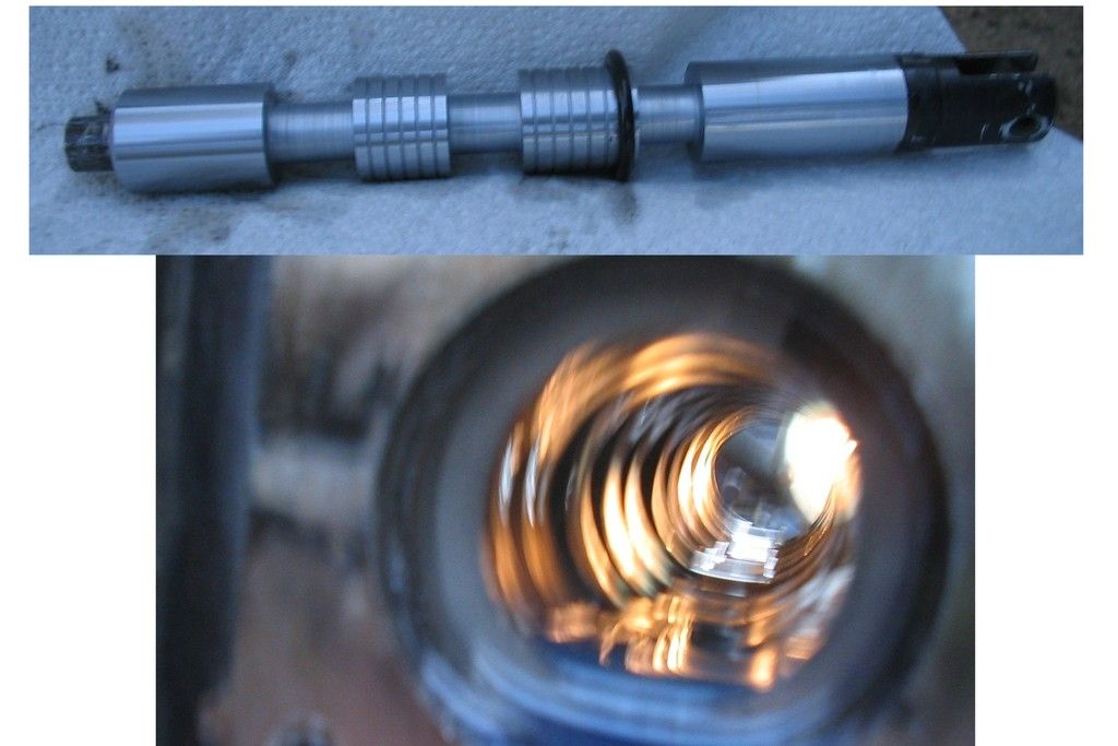

The next thing that I would do is to check out the FEL spools. I am not familiar with the Pace model FEL valve, but the valves generally work the same way. Below is a picture of a spool and the chamber that holds it from a Prince valve that may help you. The 2 spools should be checked to see if they are clean and if the chambers are clean.
Also if you want to send me a PM (private message) with your Email address, I can send you a PDF file that describes the internal workings of a FEL valve.
