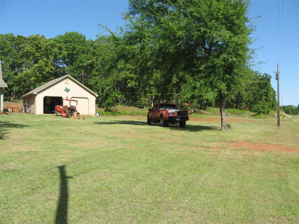

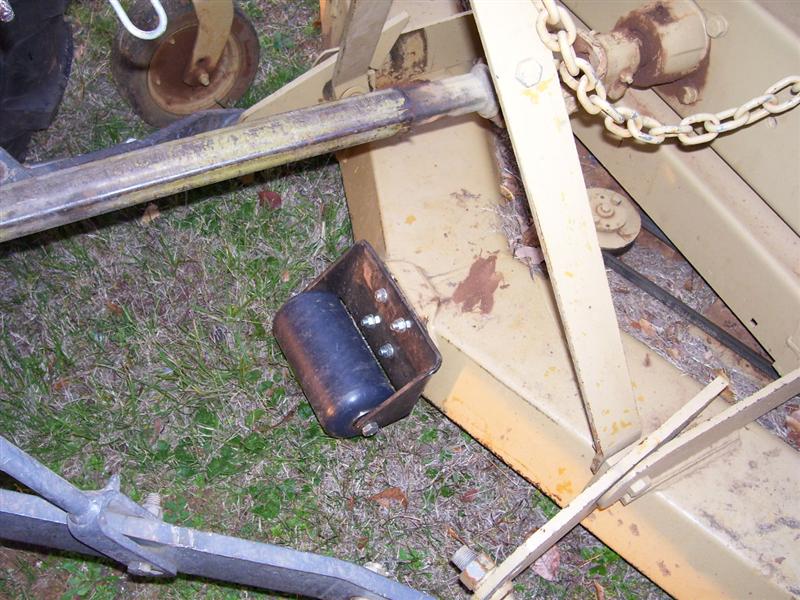

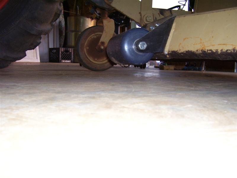

I think they might be a little better but if you have a lot of bumps and mole hills it's gonna hit bottom a few times. I still catch some as you would expect with a 60"' mower. A little less on a 38" riding mower. I added the scalper wheel to my woods and is a little better. But if I had a perfectly or near flat yard it wouldn't be an issue. You can see I have a ditch and a small hill to mow.

RobJ, is there a PTO guard missing from your mower ? The safety police will be coming for you ! I know you wont get near it but you never know who might get tangled up . When I was a kid one of the workers on the nursery got his pants caught in a unshielded PTO shaft to a sprayer,wrapped him up and almost took his leg completley off,not a good day ! Years later had a woman get her hand crushed in a potting machine that had a guard removed,they may be a PITA but they are not just there for the lawyers.

Be quiet man. It didn't have one when I bought it. Actually it didn't. IMO there are accidents, then there are stupid people. I'm not judging the ones you mentioned BTW. Google Bill Engvall stupid people and have a laugh.
But a couple to ponder, if I have a PTO guard on my BH, what about the big hole on the back, I can stick my hand in there easily. Up where we live (true story), a guy lost an arm when he stuck it in a turning baler. He's now a millionair but would a sign have stopped him? Vemeer now has an additional sign. My table saw has the guard removed. If you have ever used Jet TS with its guard you might think it's more dangerous on the TS.
I'm not trying to buck the safety police, but I do try to use as much common sense as possible.
Thanks for checking up on me. I do need a slap every now and then.
